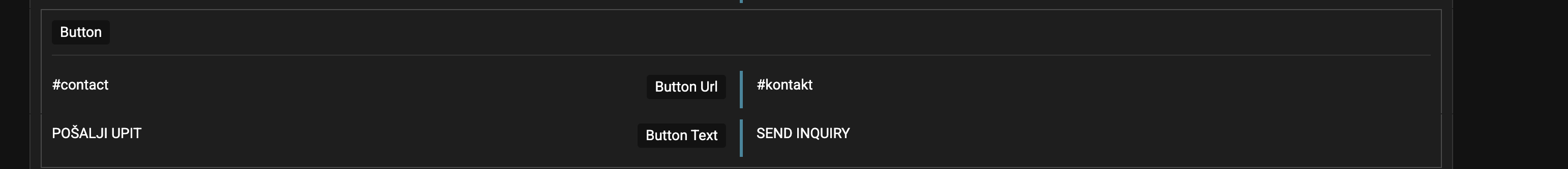

I have custom post type "Homes" and I've created template for that posts using Theme Builder. Inside of template I have button "Contact Us" which is anchor link to contact form at the end of the page.
Anchor link works if there is "#kontakt" module_id, but WPML did translate module_id to "#contact" so anchor doesn't work anymore. I can't edit one by one house since they are using same template.

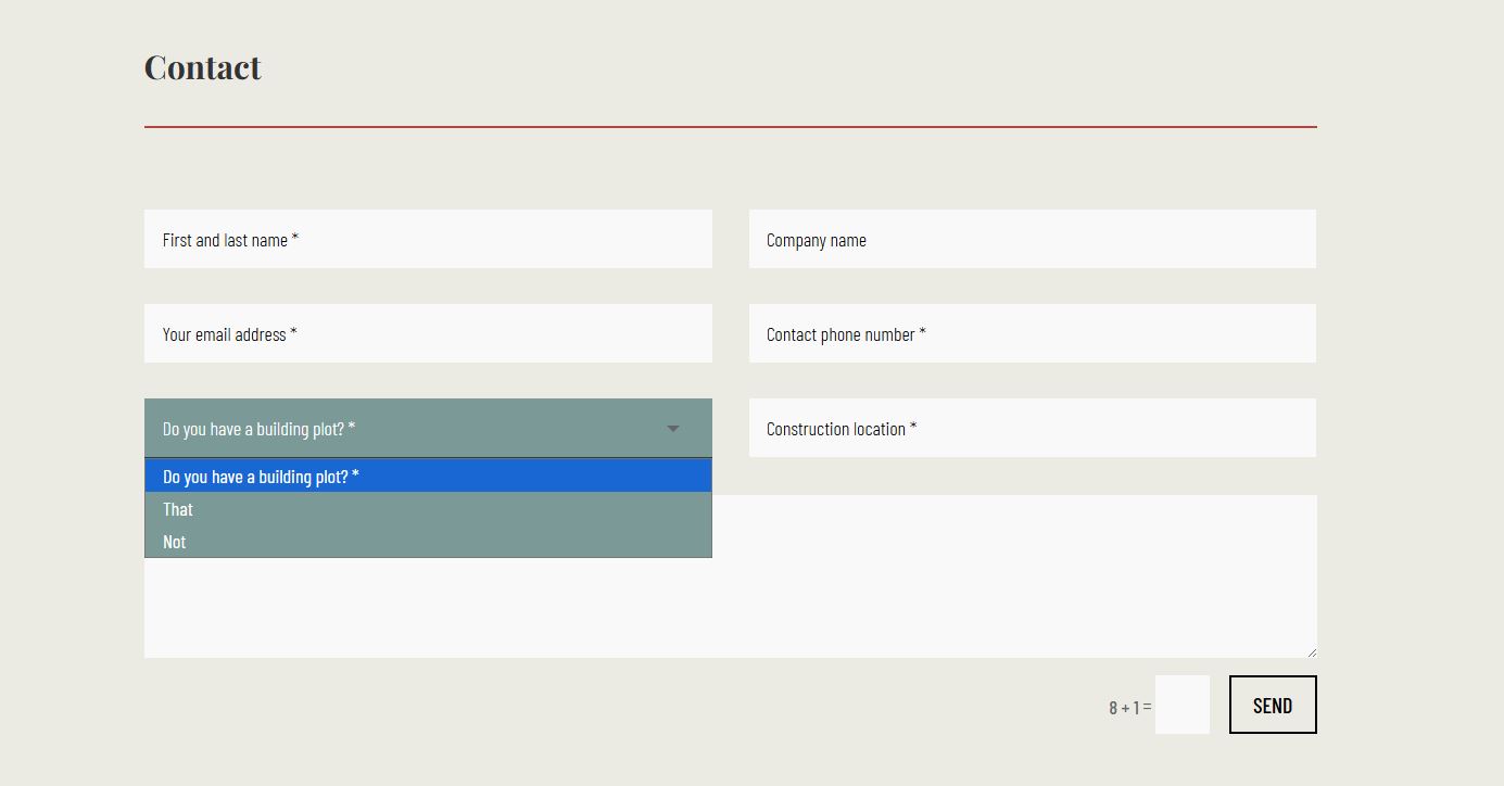

Also, on the same page at form item "Do you have building plot" there is wrong translation. It should be "Yes" or "No".

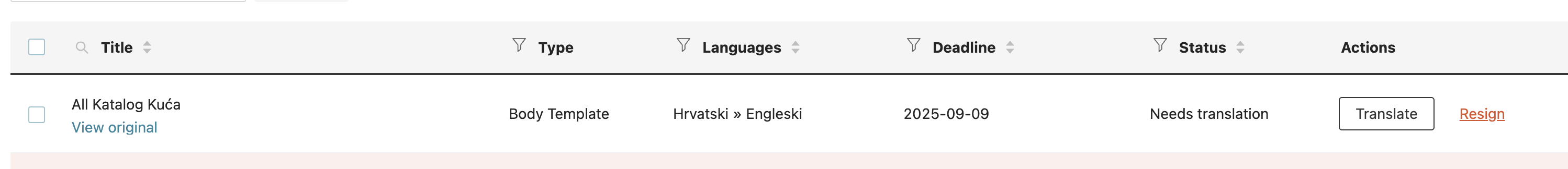

Thank you for updating me! That is a great workaround and many times it is what we would recommend.
One thing to note and be aware of is when updating the default language it can possibly overwrite the change so you would just need to remember to re adjust it manually.
One way to prevent that is switching that specific page from using the Advanced Translation Editor to WordPress Editor

Regarding the field for #kontakt , I understand your concern and there a few ways we can address that.
1. Easiest is when transalting in the Advanced Transaltion Editor use the "search" function at the top and search for the link #kontakt, you will then be able to adjust the translation.
