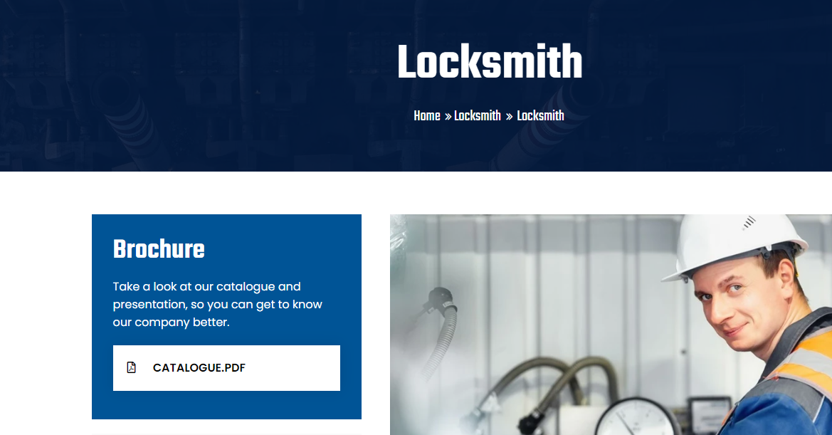

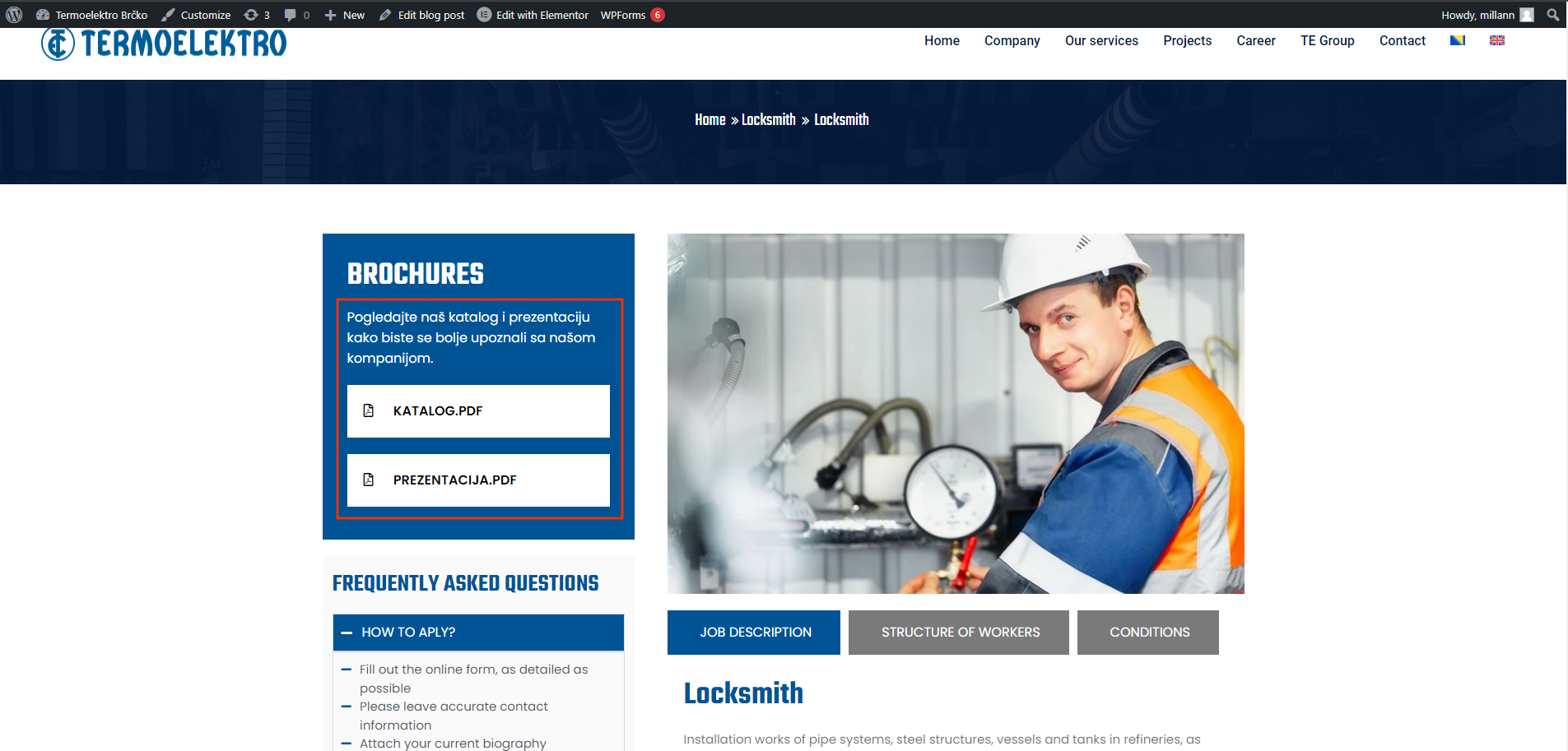

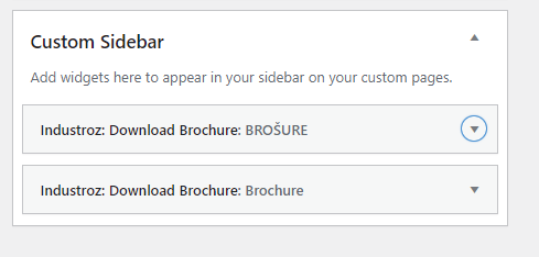

1. On the Careers page, on the posts related to open positions, there is a sidebar that displays the Brochure and a short text from the Widget. I found those strings in WPML but regardless the translation is not visible on the page.
Please see pictures attached.

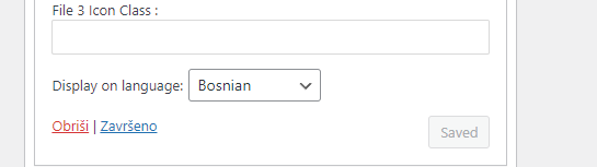

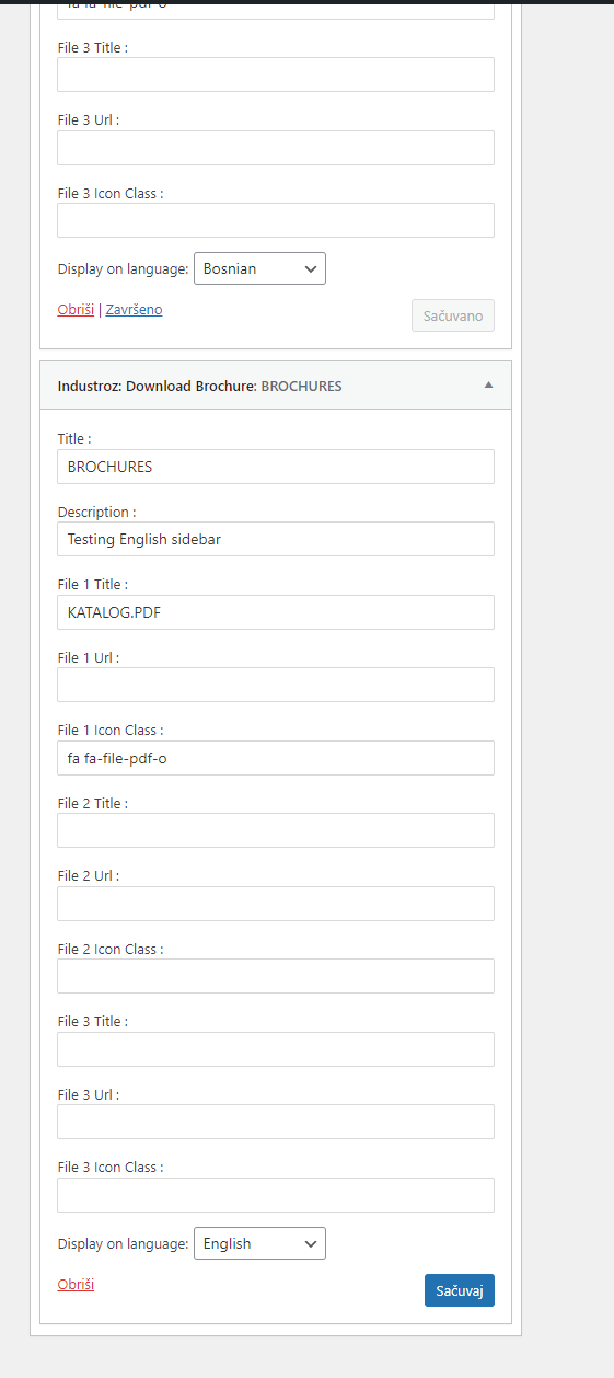

I checked the site and tried another method to translate the widget by creating a different widget for the English language (Please check the attached screenshot). This also didn't work, so I think it could be a compatibility issue.

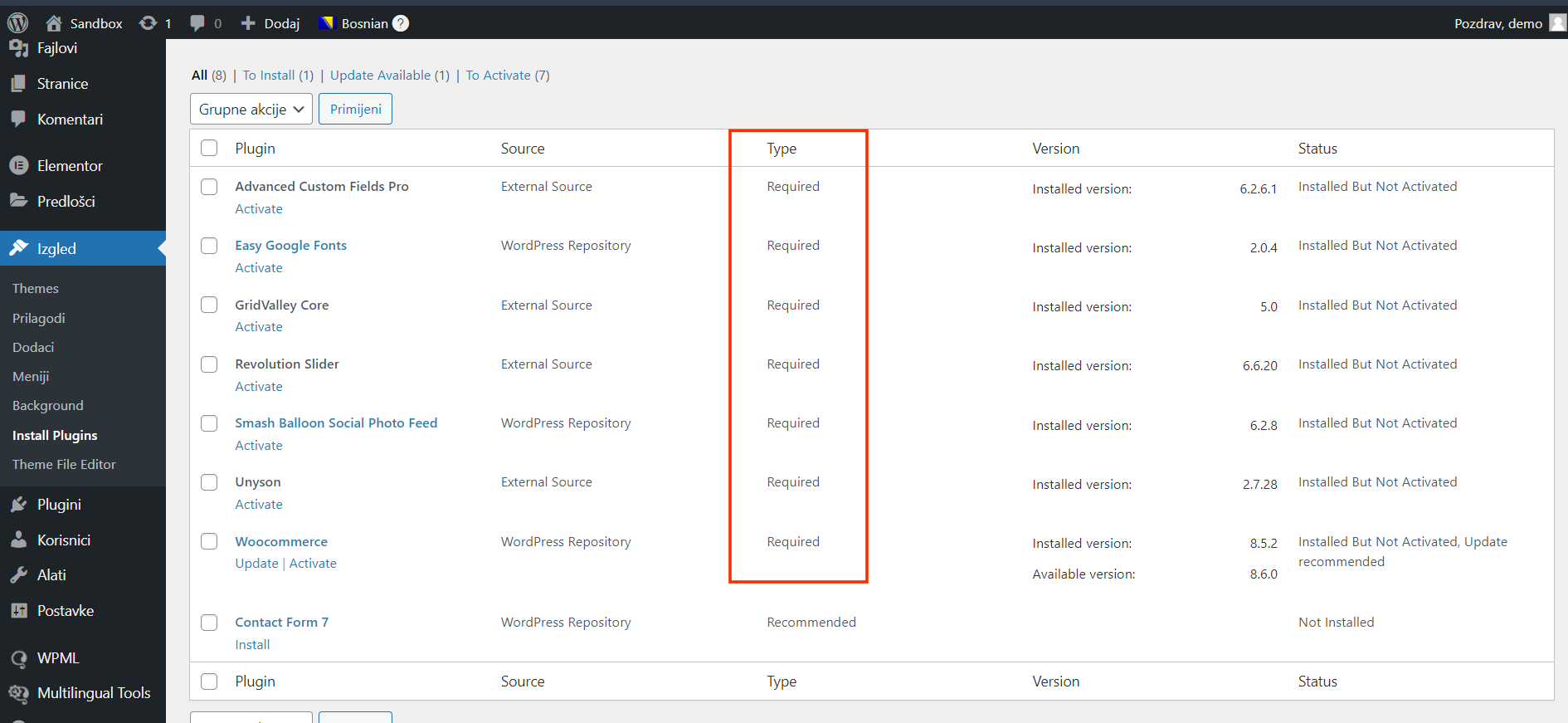

The theme is not installed so I can't replicate the issue on Sandbox, please install the theme and try to recreate the issue with the "Download Brochure" widget.
February 18, 2024 at 6:46 pm #15315453
milijanM
I installed the Theme and required plugins.

The title and description can be translated on the sandbox site, please see here hidden link but on your site, only the title is translated.
I tried deleting the strings and retranslating them, but it didn't help. So I escalated this issue to the 2nd tier support team for further investigation and will update you once I get their reply.

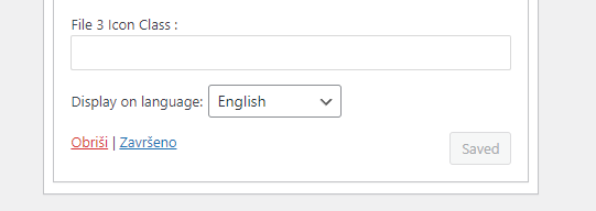

In the meantime, please use the other method to translate this widget by creating a different widget for each language https://wpml.org/documentation/getting-started-guide/translating-widgets/#using-different-widgets-for-different-languages
I tested it and it works as you see in the attached screenshots, please go to Appearance > Widgets > Custom Sidebar to edit the English widget and add the correct content.
