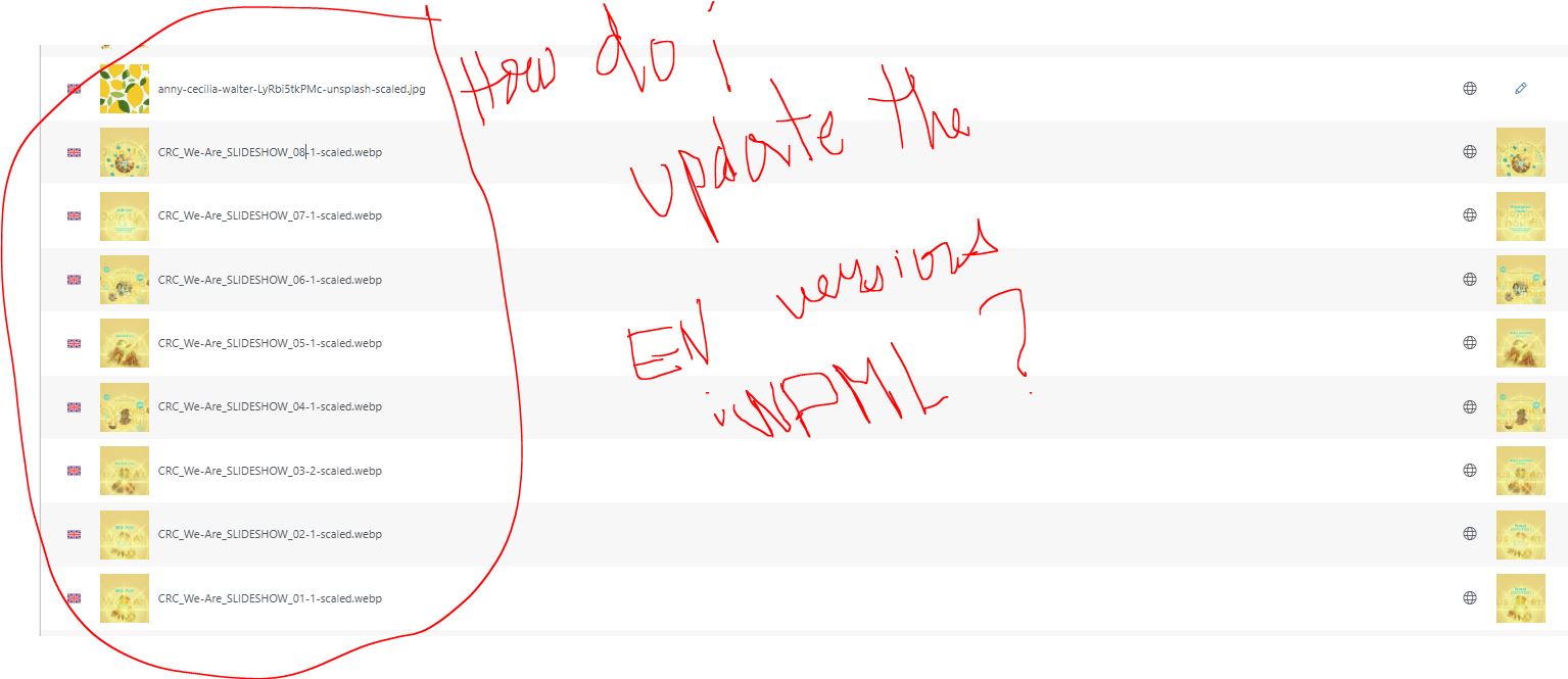

sachaJ
Yes. Understand regarding images that no longer exist (I will go through the list again this weekend)
What about the Default language images?
How do I update them in WMPL since ONLY the other language is available for a Media Translate?
If "Replace Media" causes conflicts (sometimes), how else can WMPL update the Default Media Image?
November 13, 2025 at 7:10 pm #17576613
WPML does not update any original content; it only creates translations, and I do not see any issue with accessing the translations for your examples.
If you want to update the original media, you need to edit it inside the media library.

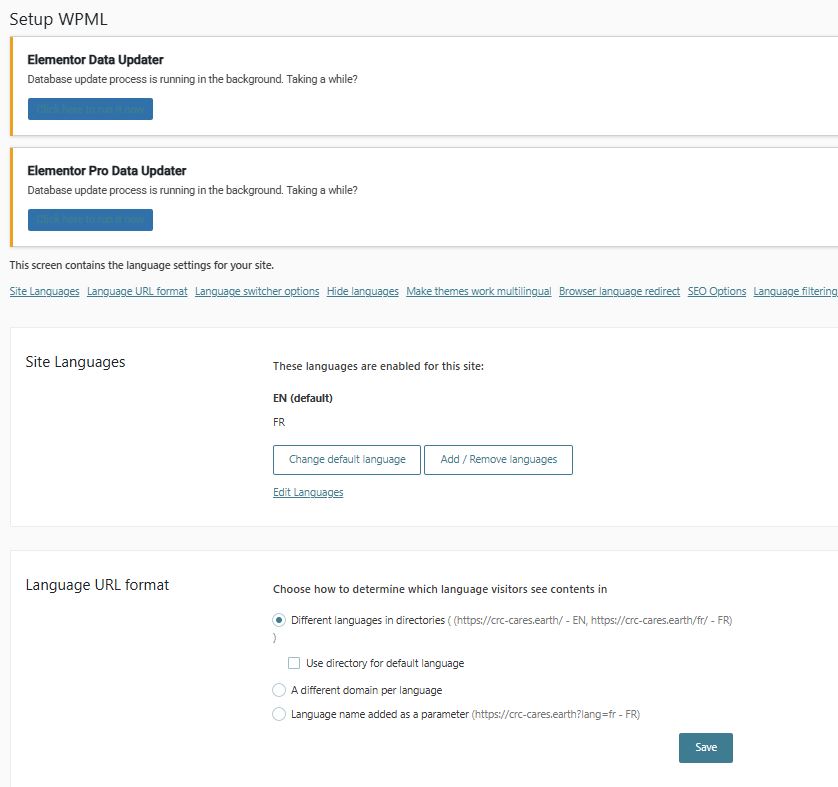

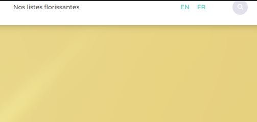

sachaJ
Hi Andreas,
Here are my set-ups.
Essentially, the FR sometimes takes longer to swath the pages AND sometimes it reverts to the EN.
Is that normal?
Is my directory language set-up properly?
November 19, 2025 at 6:56 pm #17593283
You refer to the links that you have put into the header? Note that this is not a WPML language switcher. These links will always lead to the homepage in each language.
So far, I was only able to confirm the issue if the current page is still saved as a draft. Can you please confirm if this is the cause of the issue?
If not, can you maybe name me an example of a page where the issue occurs?
