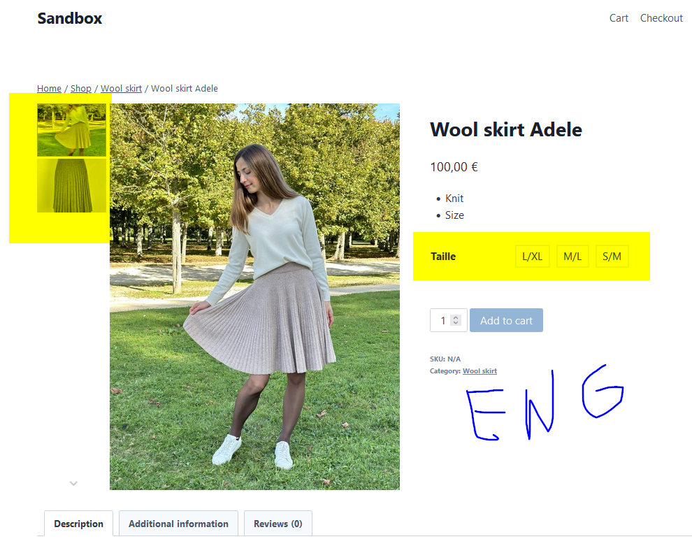

The update does not concern only photos, it also concern the style of Variation swatches on the Product page, that is defined in the Kadence Shop kit.
In FR product page, it is "Radio boxes", in ENG product page it is "Dropdown menu". Please see 2 screenshots attached.

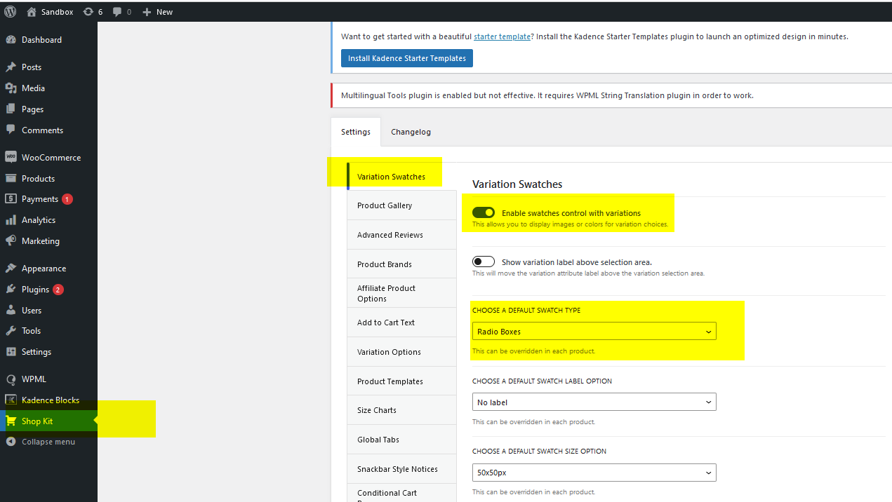

When I'm going to Shop Kit, Section Variation Swatches, and when it is French selected in the header of WordPress, it is OK,
but when I switch to ENG (in the header of WordPress), and I activate "Variations swatches" and click on "Save", the System is not taking it in account, and force the "Variation swatches " to be NON-activated. Please see another 2 screen shorts attached of Shop kit inteface.

After this installation I've done the setting in Shop kit for Variation Swatches to be Radio boxes (and not Dropdown as default). see the screen shot 03.
After that, I did the Translation in ENG of the product page in WMPL interface)
Once completed at 100%, I went ot the product page in FR, than in English and Published in English.
French : hidden link
English: hidden link
It is working fine.

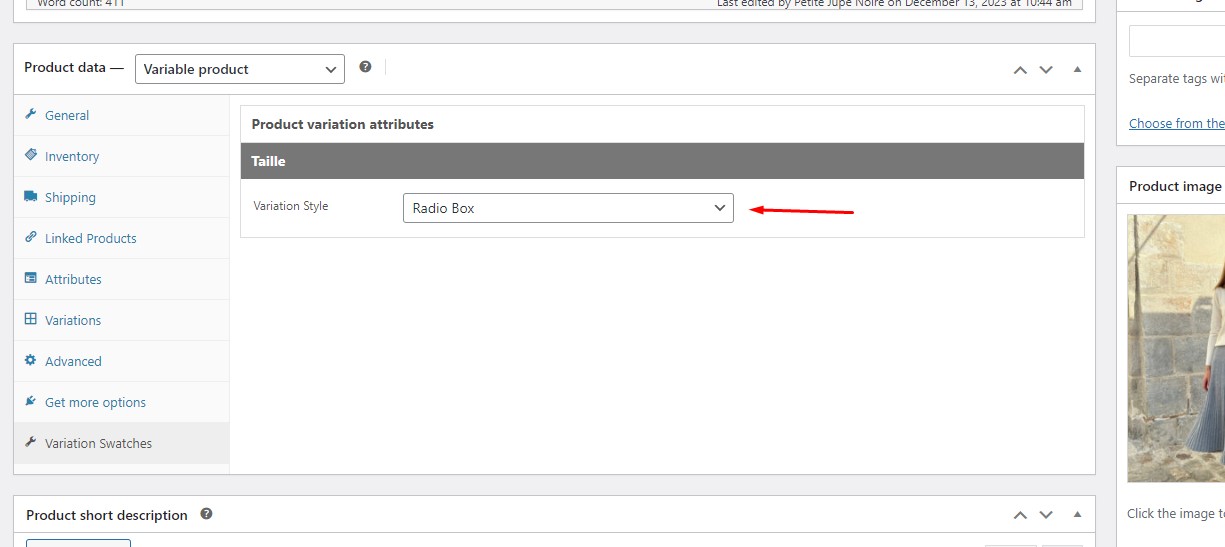

I took a copy and checked further, it seems this settings is also set on each product. If you edit the 2nd language manually, you can set and change this to radio boxes, I have tried and works fine.
Please check and then we can continue to the next issue.
Drazen

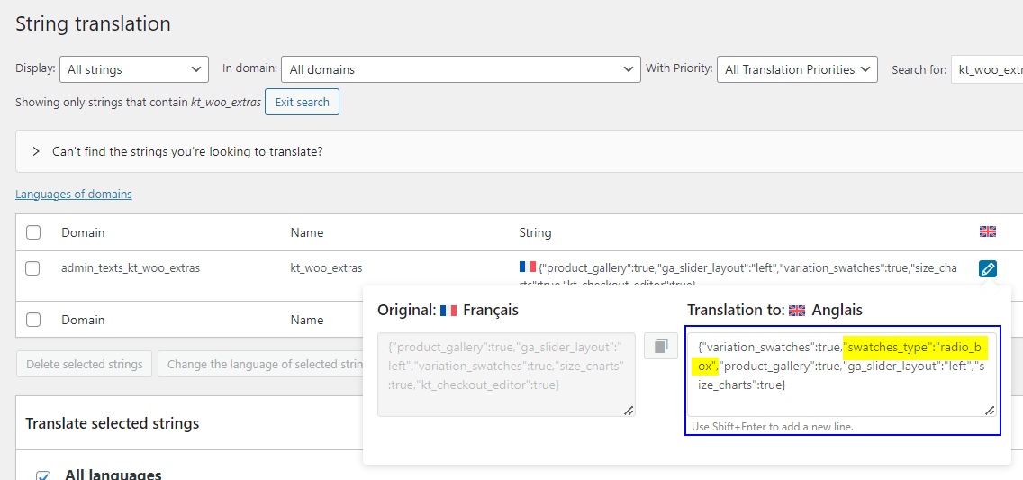

1) I checked our previous ticket about a new component created, called "kt_woo_extras"(and we needed to translate it to get the galery photos displayed correctly on the ENG product pages).
2)I went to the sand box (the test site you provided me and where the Kadence Shop kit is working fine for Variation Switches,after I'd done the necessary installation.)
3) So I verified there the same "kt_woo_extras" and I saw this:
{"variation_swatches":true,"swatches_type":"radio_box","product_gallery":true,"ga_slider_layout":"left","size_charts":true}
4) I copied it and put on my production site (String translation) and it is working well on the ENGLISH products, so it is OK. See the screen shot attached.
This way I can do the necessary changes in future, if I wish, by 1 modification in the String Translation of "kt_woo_extras".
Dear Drazen, so we can close this ticket on Variation Swatches, because this solution, that I've just described is ok for me : I will not be obliged to do it manually one by one on each product ENG page.
We should just find now, in the next ticket, why the Kadence Shop kit "Size chart" is not working well for FR and ENG sides, why the Size chart is always the same on both FR and ENG sides.
Please help.
Marie
