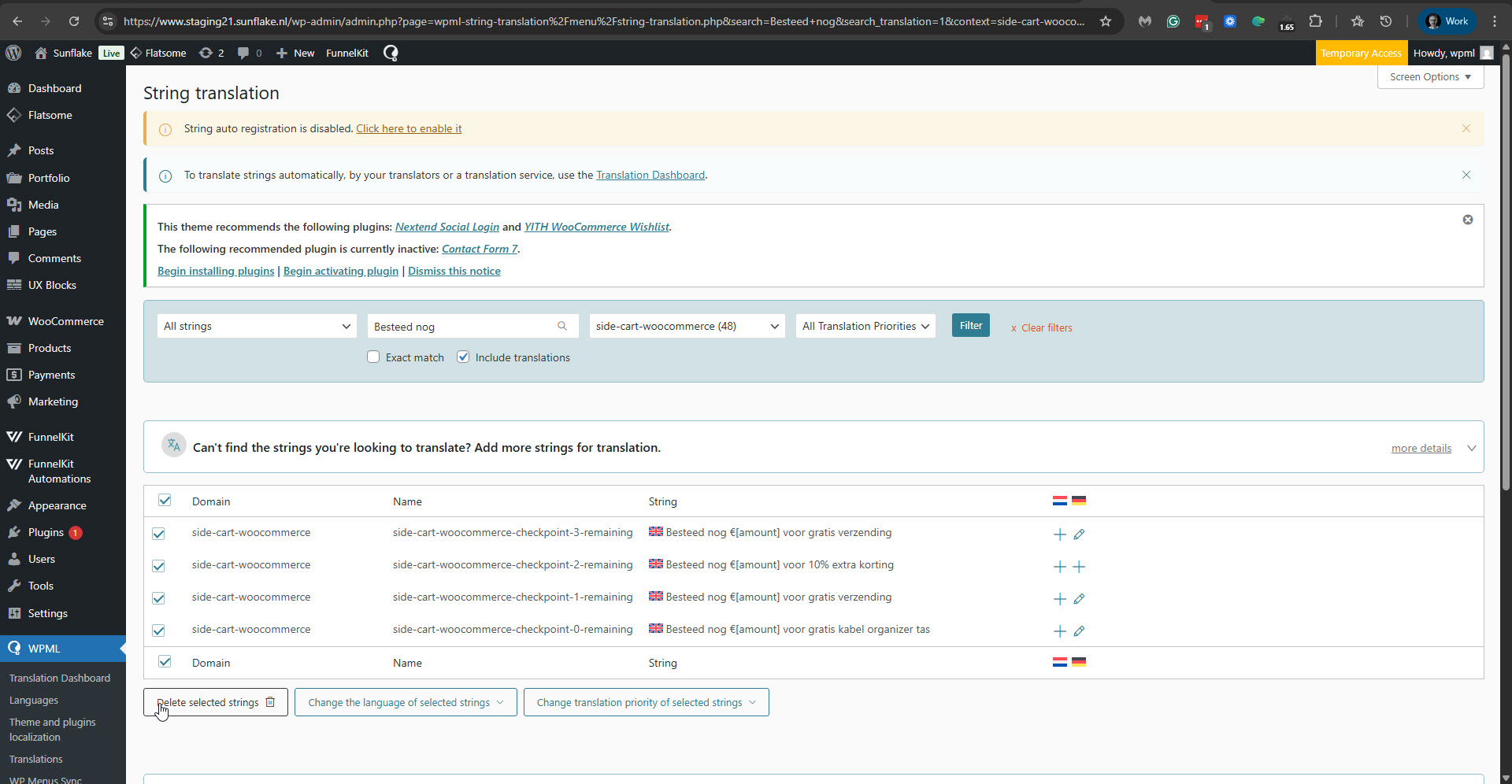

I am trying to remove a translation from my website hidden link. I deleted the string translation, but it still appears on the website.
String gets translated but can't be located at string translation. Not sure where its getting translated.
How can I completely remove a translation from my website?
Why does the translation still show on the website after deletion?

On your staging site, please try the following.
We suspect a collision with the theme or another plugin might cause this problem. If possible, get your site into a minimum environment, switching to a parent Flatsome theme like TwentyTwenty-Four and activating only WPML, WooCommerce, and the FunnelKit plugin.
First, check whether the problem persists when only the theme is switched to the parent Flatsome theme. If it persists, deactivate all plugins except WPML and its add-ons, WooCommerce without any extensions, and the FunnelKit plugin. Then, please check if the problem persists. If it does not persist, start by activating the plugins individually and checking when the issue comes back, then report to me which plugin was the culprit.
Itamar.

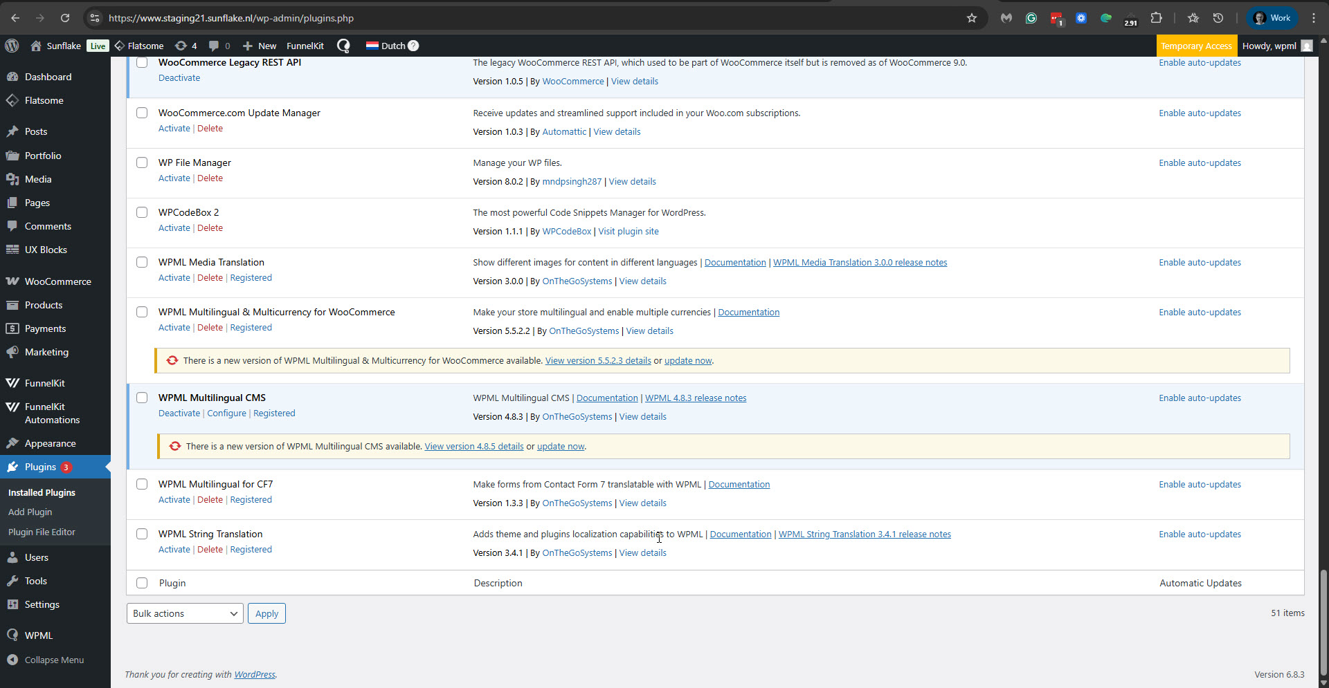

You wrote: "Hi FunnelKit Support," so I'm not sure if you wanted to send this message to them or to us at WPML. In any case, thanks for trying my suggestions and the video.
On your staging site, I updated WPML to the latest version and deleted some strings I suspected were interfering with and causing the problem. Unfortunately, the problem persists. This is indeed a weird case. Let's please proceed with the following.

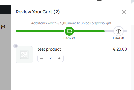

I’ve installed FunnelKit on this website and added the checkpoints inside the side cart (the cart can be opened via the bottom-right corner).
However, I’m unable to properly reproduce the behaviour because WPML is injecting or overriding one of the checkpoint texts.
For some reason, the text "Besteed nog X voor kabel organizer tas (t.w.v. 14.99)" is being translated/inserted by WPML, but I cannot find where this translation comes from. It does not match the text I have configured inside FunnelKit.

1) I’m unable to properly reproduce the behaviour on your fresh WordPress installation, so here it works fine
2) It looks like WPML is somewhere on my website & staging overriding the checkpoint texts or rewards how its called in the plugin.
I mean the text at the top (Message) and the one below the Icon Title 'Free Gift' in the screenshot.
It has worked before so not sure what changed but when disabling WPML on staging it works fine again. But when active I always get the same text:
Hope you have idea what is causing it, thanks for your help

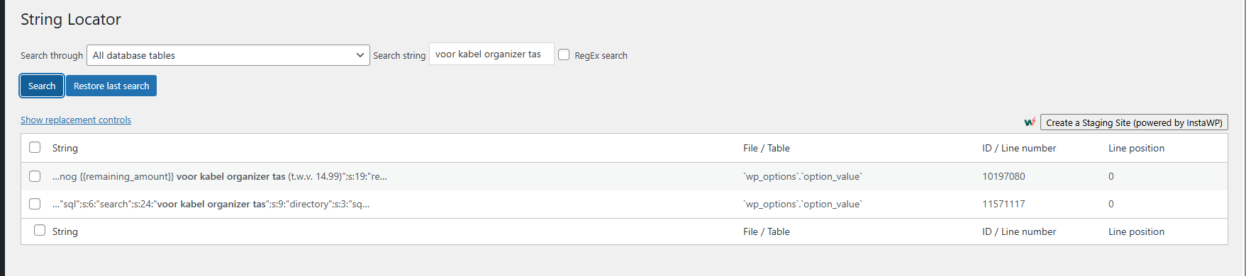

I did install String locator and was able to find this in my database.
Maybe this is causing it, I dont know how to fix it but maybe it will help you solve the issue.
In the plugins & (child) theme this sentence wasn't found he could only find it here in the db.
Kind regards,
Bas

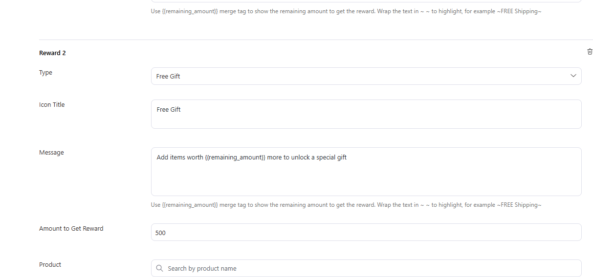

November 22, 2025 at 2:56 pm #17601243
basv-41
I found the issue, it was in funnelkit it self, there is a language part. But still strange it works fine when I de-active wpml, but maybe this tab is only available when WPML is active, anyway it's resolved thanks for your help!
