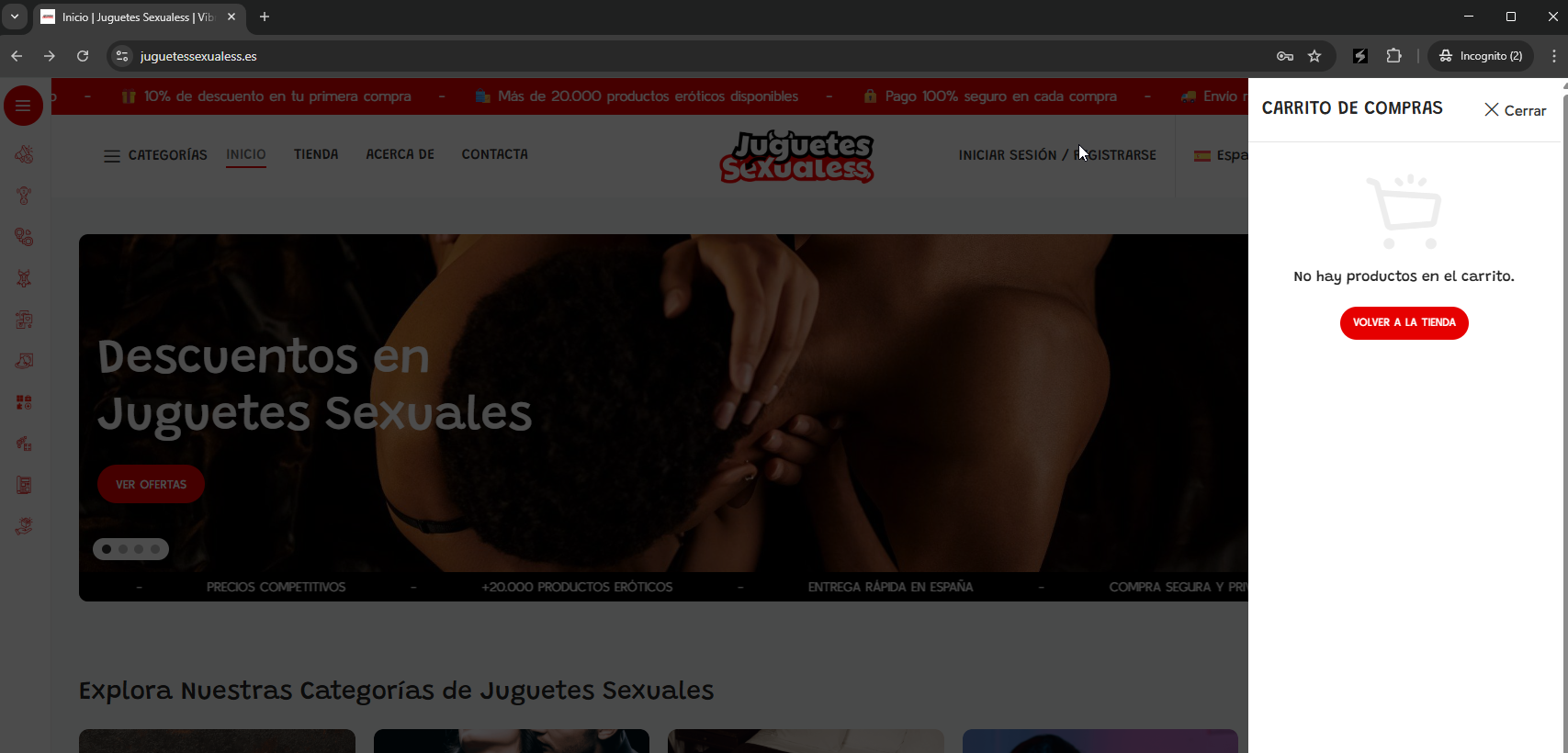

panagiotisL-3
We've translated all the Return to shop strings but this Return to shop button still shows in English
Screenshot 2026-01-12 at 11-33-00 Inicio Juguetes Sexualess Vibrador Condones Lubricante Tapón Anal.png
Screenshot 2026-01-12 at 11-31-57 String Translation ‹ Juguetes Sexualess Vibrador Condones Lubricante Tapón Anal — WordPress.png

January 12, 2026 at 8:04 am #17720215
Thanks for your patience. I’ve reviewed your query along with the screenshots and can see the issue you’re referring to. I’ll need to identify where this string is coming from.
Therefore, I will require temporary access (WP-Admin and FTP) to a test site where the problem has been replicated, if possible. This will enable me to provide better assistance and determine if any configurations need to be modified.

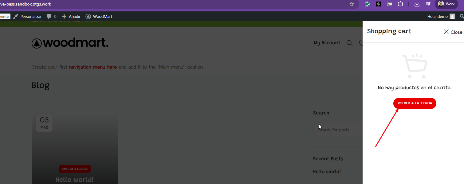

January 12, 2026 at 1:52 pm #17721756
Thanks for your reply. My apologies for the inconvenience. Please give me one last chance to assist you further with this. The strings are translated correctly in String Translation, but there appears to be a conflict that’s preventing the correct language from displaying on your website.
I’ve installed the WoodMart theme on our sandbox site here:
On the sandbox, the translated button displays properly in Spanish without any issues, as shown in the attached screenshot.

January 13, 2026 at 10:05 am #17724373
Thanks for your reply. It looks like it's just a cache issue. I've temporarily deactivated WP Rockets plugin so that cache can be cleared immediately. Now after clearing my browser cache, it's showing up correctly now as shown in the attached screenshot. Could you check?
You can reactivate the WP Rockets plugin after checking on this.
