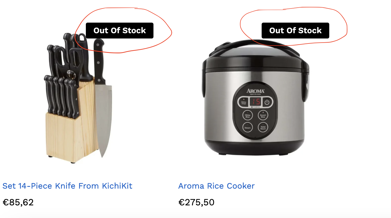

I am addressing you in relation to the translation a string. Indeed, yesterday I translated the Out of Stock string and I saw that this string was not translated then I deleted it and I rescanned my theme but unfortunately I did not find this string. For this reason I am contacting you, could you resolve this problem please?

Could you please send me a link to a product on which I can see the issue?
April 4, 2024 at 12:26 pm #15483018
feruzK
I followed what you told me and finally I found the string but when I translated it, the translation was not taken into account. What can I do ? I am sending you the screenshot of this string translation.

The string that is displayed on your site is coming from wp-content\themes\martfury\inc\backend\customizer.php.
It is the 'default' string which is not translatable.
'outofstock_text'           => array(
			'type'            => 'text',
			'label'           => esc_html__( 'Custom Out Of Stock Text', 'martfury' ),
			'section'         => 'shop_badge',
			'default'         => 'Out Of Stock',
			'priority'        => 20,
			'active_callback' => array(
				array(
					'setting'  => 'badges',
					'operator' => 'contains',
					'value'    => 'outofstock',
If you edit this line you will see the changes on Frontend:
Change:
to:
'default' => 'Out Of Stock Foo',
This string is not coded properly to be translatable, but according to the logic here, you need to first edit a "Custom Out Of Stock Text" inside the Martfury Theme Options first, then locate this string on String Translation and translate it.
At this point, I can not follow the approach of the theme author, as the Customizer does not provide any option to edit this string.
Maybe you should ask the theme support about where exactly this 'Custom Out Of Stock Text' is editable.
