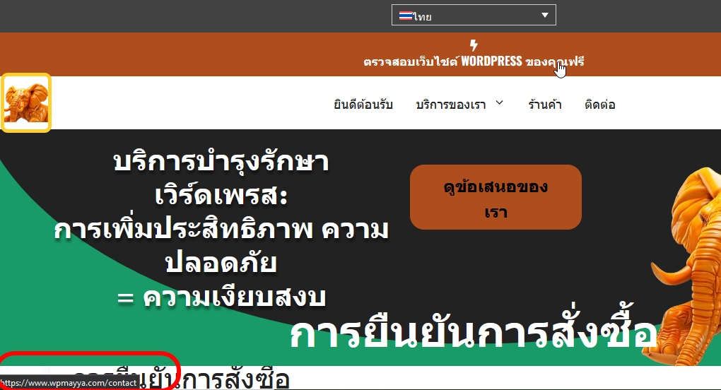

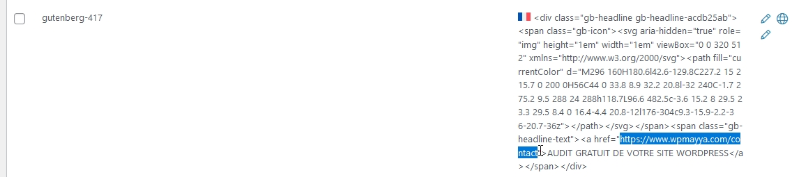

I am working on updating the text and link in the string translation page of WPML on my website hidden link. I need the changes to reflect correctly in multiple languages.
After changing the text and link in the string translation page, the text updates correctly across different language pages, but the link does not update. The French link still appears on the English and Thai pages.
Why does the updated link not appear correctly on the English and Thai pages after making changes in the WPML string translation page?
How can I ensure that the link updates correctly across all language versions on my site?

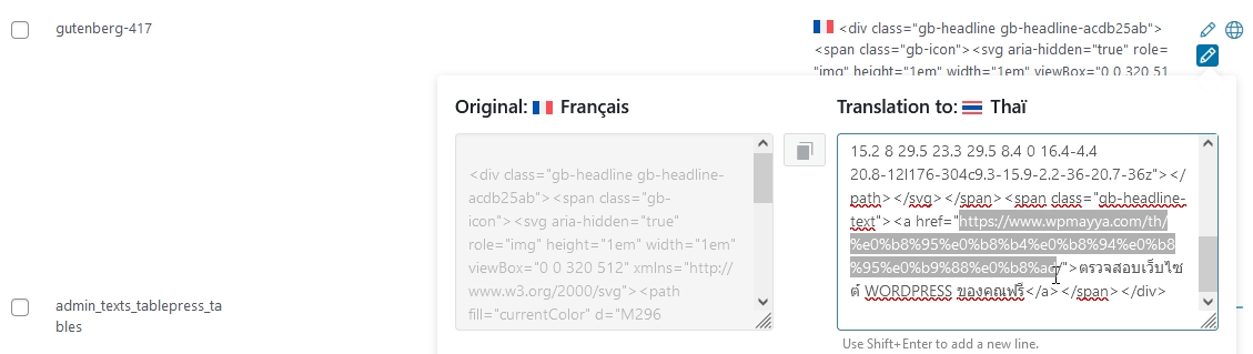

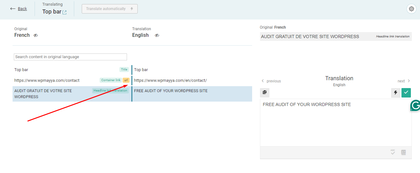

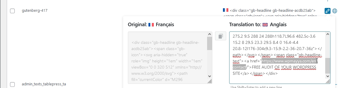

I’ve noticed that the top bar section is coming from Elements custom post type which is using custom Gutenberg elements which seems not fully compatible with WPML Translation Editor that’s why you were facing this issue. I’ve followed the below steps to fix this issue:
1. Added the below XML:
<wpml-config>
  <gutenberg-blocks>
    <gutenberg-block type="generateblocks/container" translate="1" label="Container link">
	<key name="url" />
    </gutenberg-block>
    <gutenberg-block type="generateblocks/headline" translate="1" label="Headline link translation">
	 <xpath>//span[@class="gb-headline-text"]/a</xpath>
	 <xpath type="link">//a/@href</xpath>
   </gutenberg-block>
  </gutenberg-blocks>
</wpml-config>
In WPML >> Settings > Custom XML Configuration section.

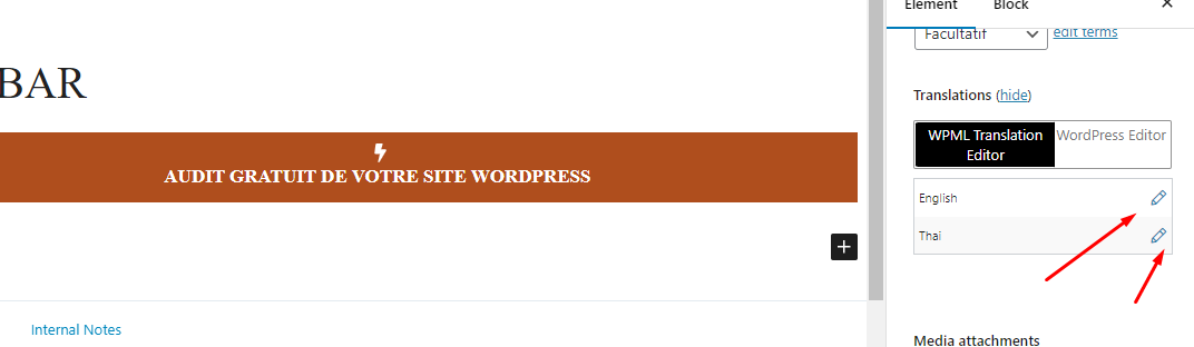

2. Opened the Topbar post in Edit mode in the default language:
hidden link and made a small change(added a space in post title) to reload the translation.
3. Opened the secondary language posts in Advanced Translation Editor and added the link translation; now it seems to be working correctly.
