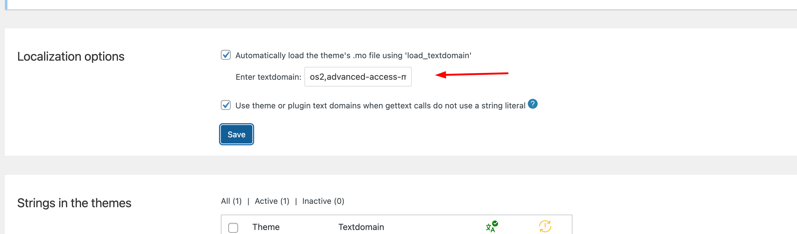

August 22, 2024 at 6:29 am #16092760
Dražen
I have added your theme text domain to be automatically loaded from WPML > Theme and plugin localization, and it works fine, image is attached.
Please check.
Drazen
