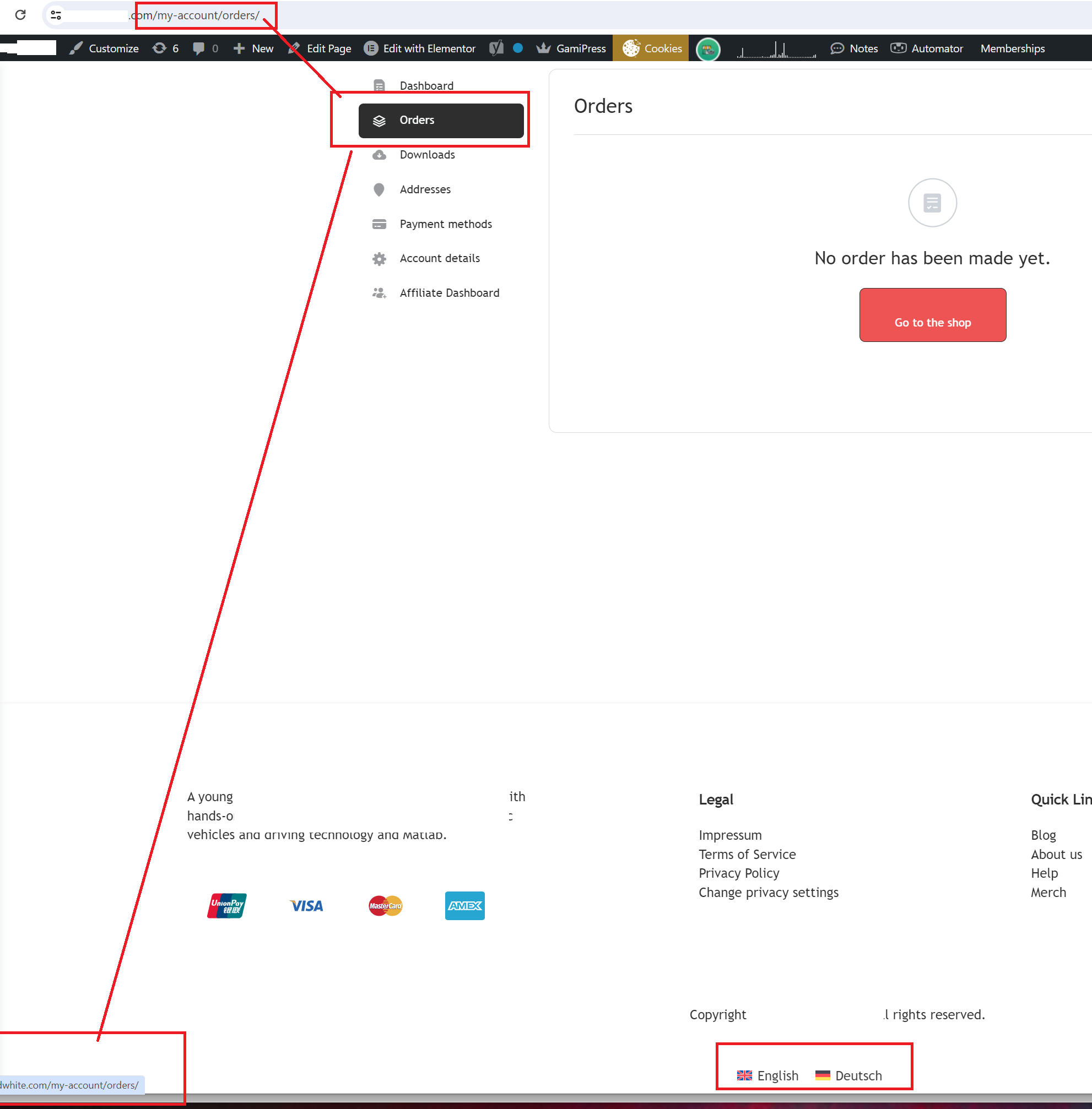

I activated WPML on your live site (WCML was already active), and my above-mentioned solution seems to work. I have attached a screenshot. The redirect to my account is not happening anymore.
Can you confirm this? WPML +String Translation is still active to check.

thank you for getting back. I agree, on the my account page I can see that it works now. I still did not quite understand what the reason therefore was? Because the String Translation was not active?
