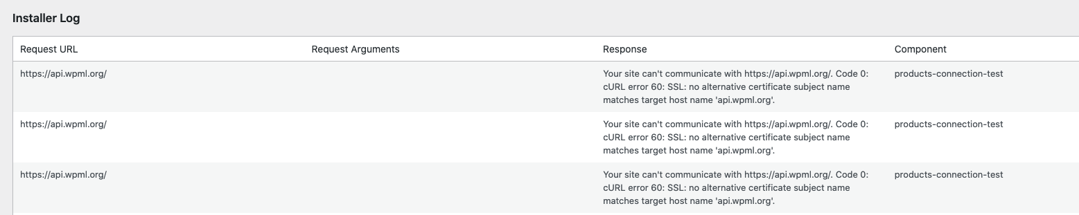

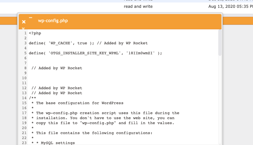

I tried to add the key straight to your wp-config.php site file by using this code:
define( 'OTGS_INSTALLER_SITE_KEY_WPML', '18IIm0wmZI' );
Now, at the top, it says that the key is invalid and in the WPML connection log (hidden link) it is now stated clearly in the errors at the top that the site can't communicate with api.wpml.org.
Unfortunately, there's nothing that we can't do if the hosting is not able to whitelist the domains.
You can use WPML just as it is, without registering it, and manually update it when new updates are available by downloading the latest versions from here (https://wpml.org/account/downloads/) and then install + activate them on your site, only after you first created a full website backup + disabled and removed the existing WPML plugins.
Or you could change the hosting provider - it feels pretty weird to me that they can't whitelist the domains.
