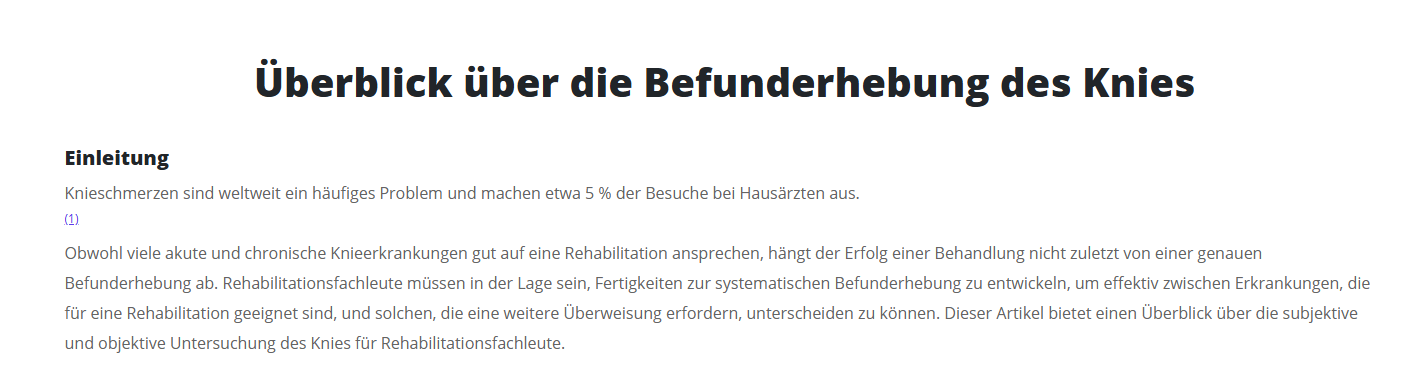

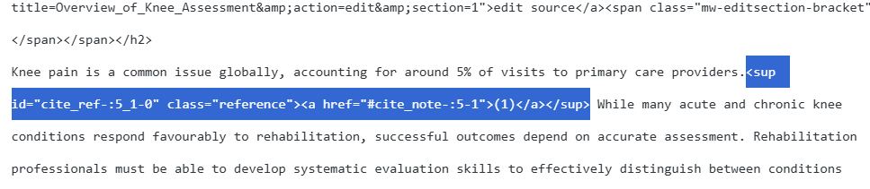

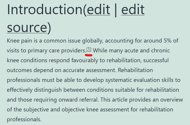

I have a site where the original pages have superscript to add citations, and WPML is not adding them to the translations. Instead, the system adds a space. You can see the issue on this page: hidden link, this is the original hidden link
I share screenshots with an example, it happens in many instances in all pages we update or newly add.
I expected to see the superscripts in the translations the same way they show in the English original. Instead, the system adds an extra line (space).
Why is WPML not adding superscripts to translations?
How can I ensure superscripts are correctly displayed in translated pages?

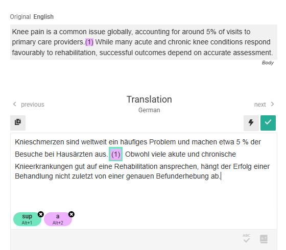

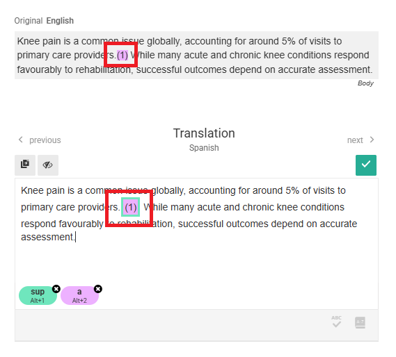

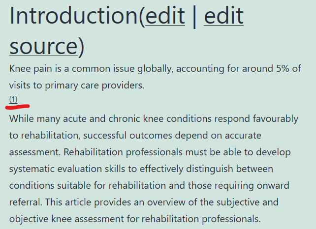

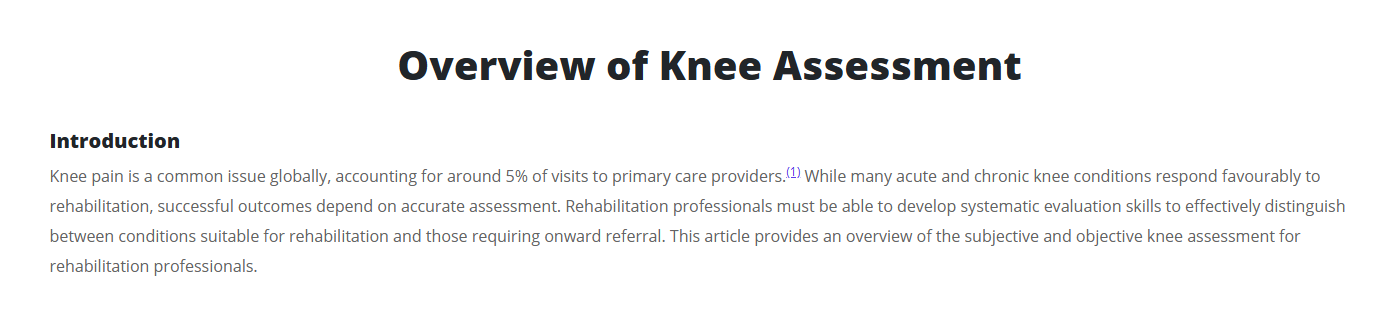

I have replicated the original issue in the sandbox site. There is something wrong with the markers:
English version hidden link
Spanish version (note that it is the spanish version, even if I left it in English) hidden link

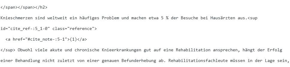

Thank you. I also tested and found out that the problem happens only if the Classic editor or the Classic block is used.
Normal Gutenberg block content does not have the issue.
I created a report and escalated the issue to the second tier for further investigation.
