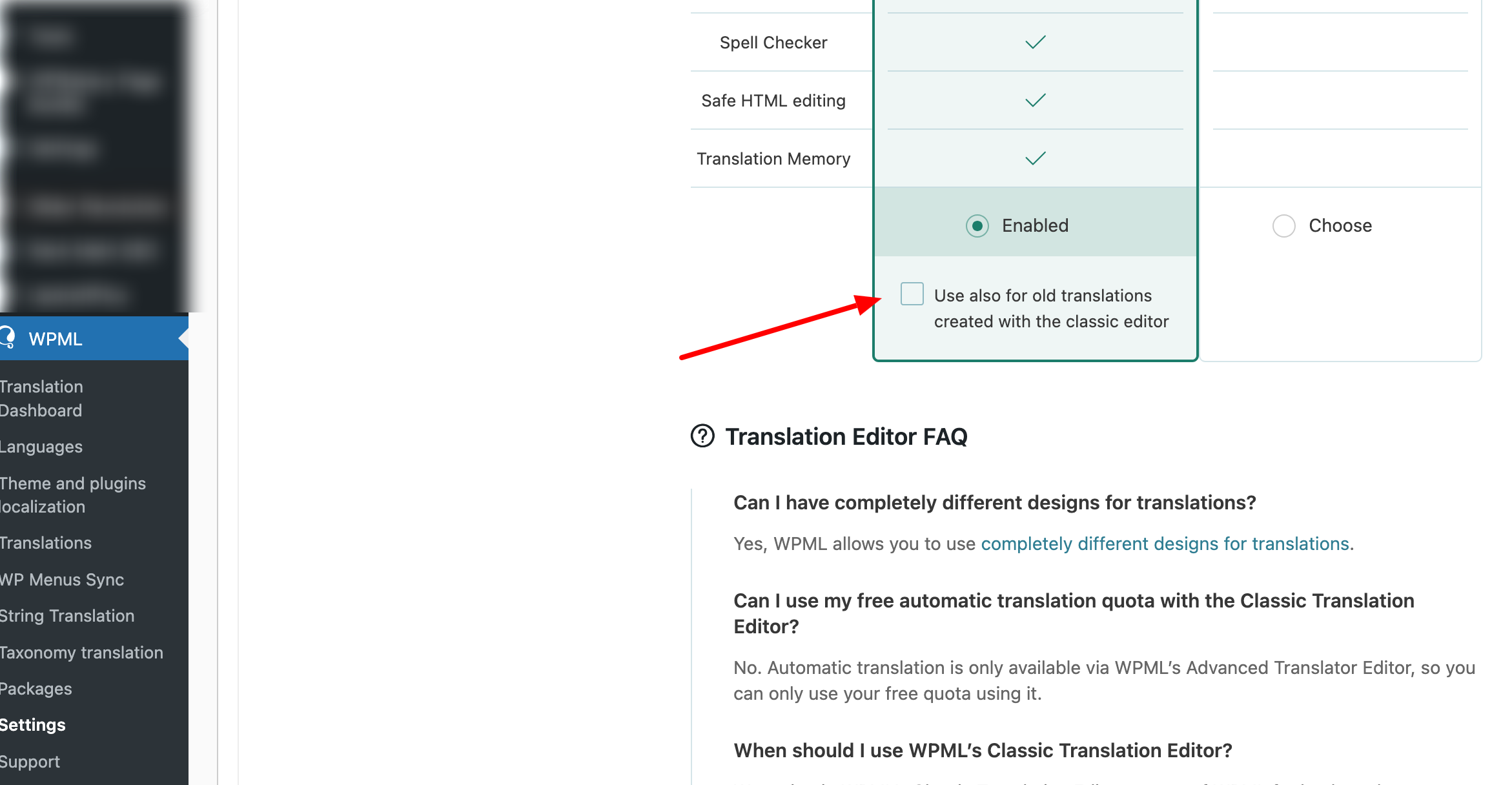

The client was unable to use the Advanced Translation Editor for a page that was originally translated using the Classic Translation Editor.
We reviewed the client's settings and enabled the option in WPML → Settings:
"Use also for old translations created with the classic editor"
. This allowed the page to open correctly in the Advanced Translation Editor and the translation to load properly. We asked the client to clarify any specific issues they were still facing.

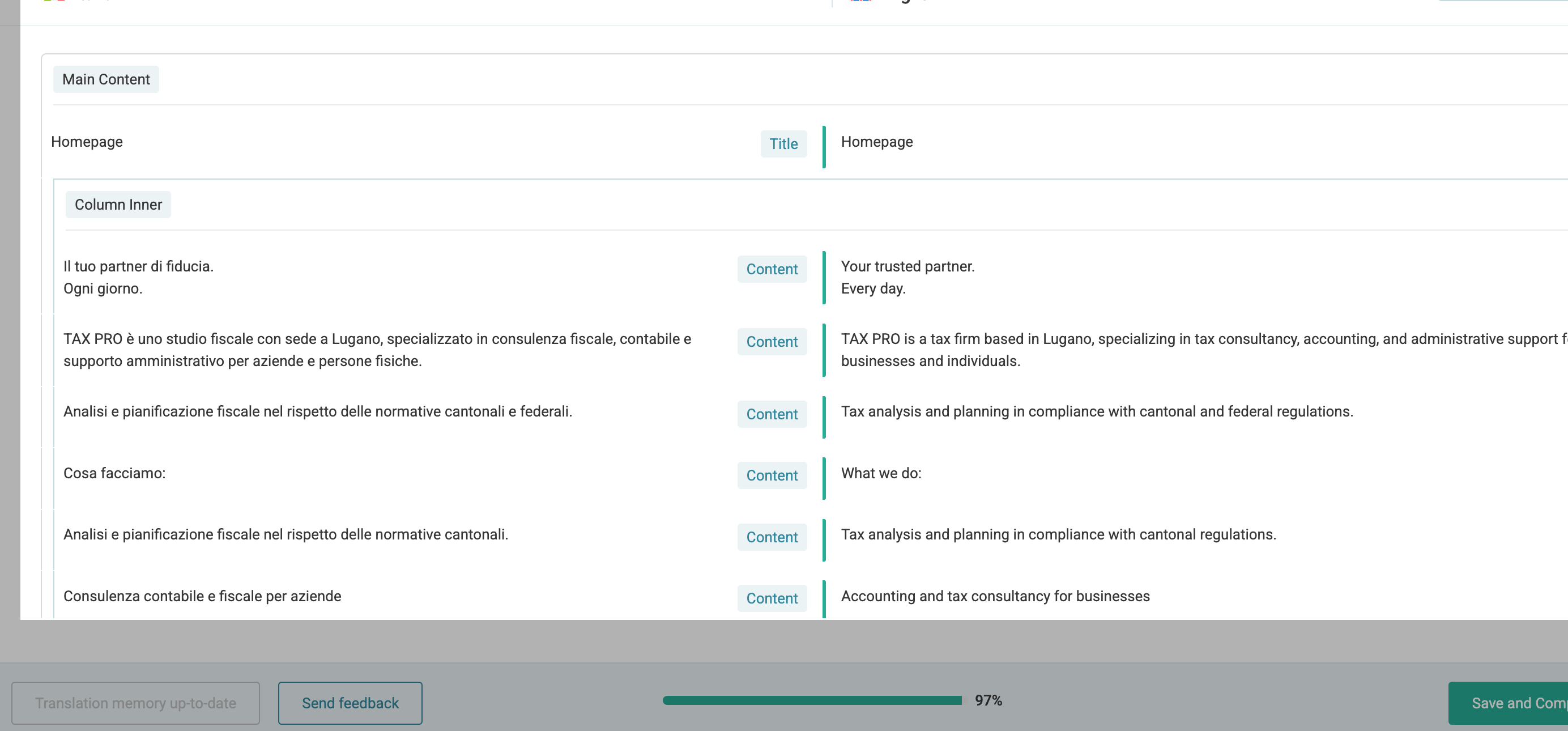

I’ve checked your site and reviewed the page at:
As you said, the page was originally translated using the Classic Translation Editor, which is why it continued to open there.
In WPML → Settings, I enabled the option:
“Use also for old translations created with the classic editor”
After that, the page translation opens correctly in the Advanced Translation Editor, and the translation loads properly there.
From my side, everything seems to be working as expected in the Advanced Translation Editor.
Could you please clarify what exactly is not working on your end?
I’ve attached screenshots for your reference.
