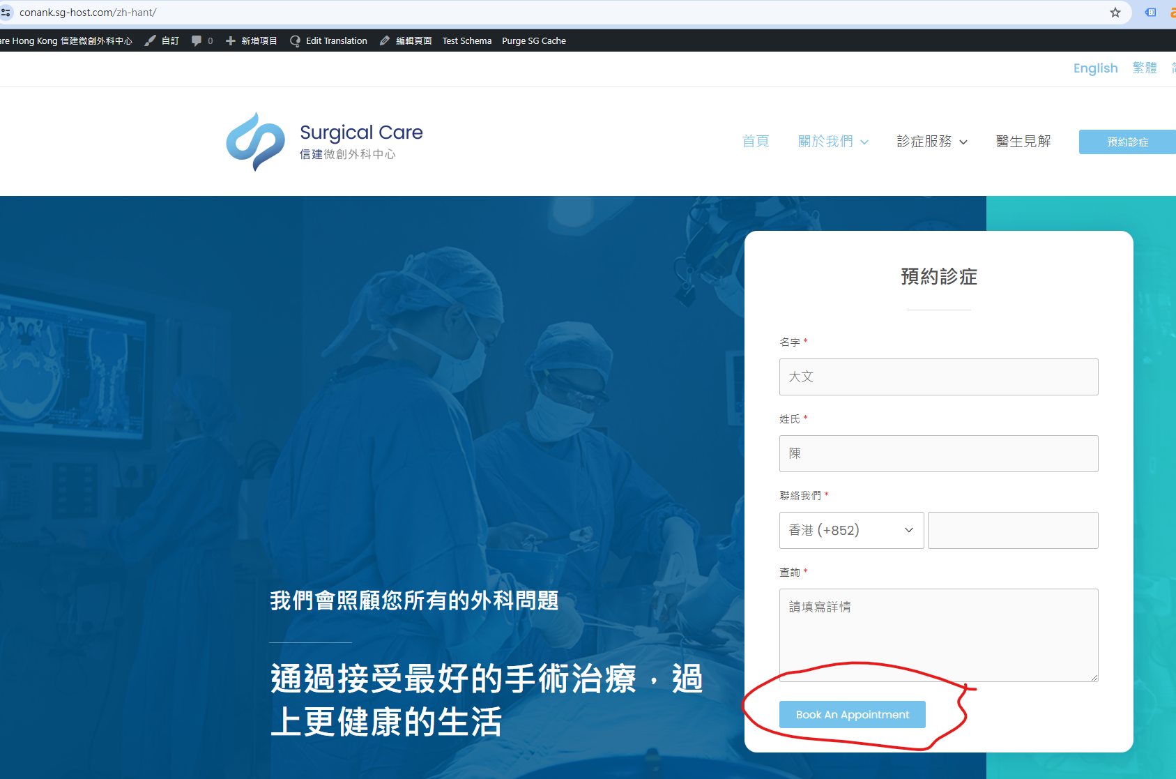

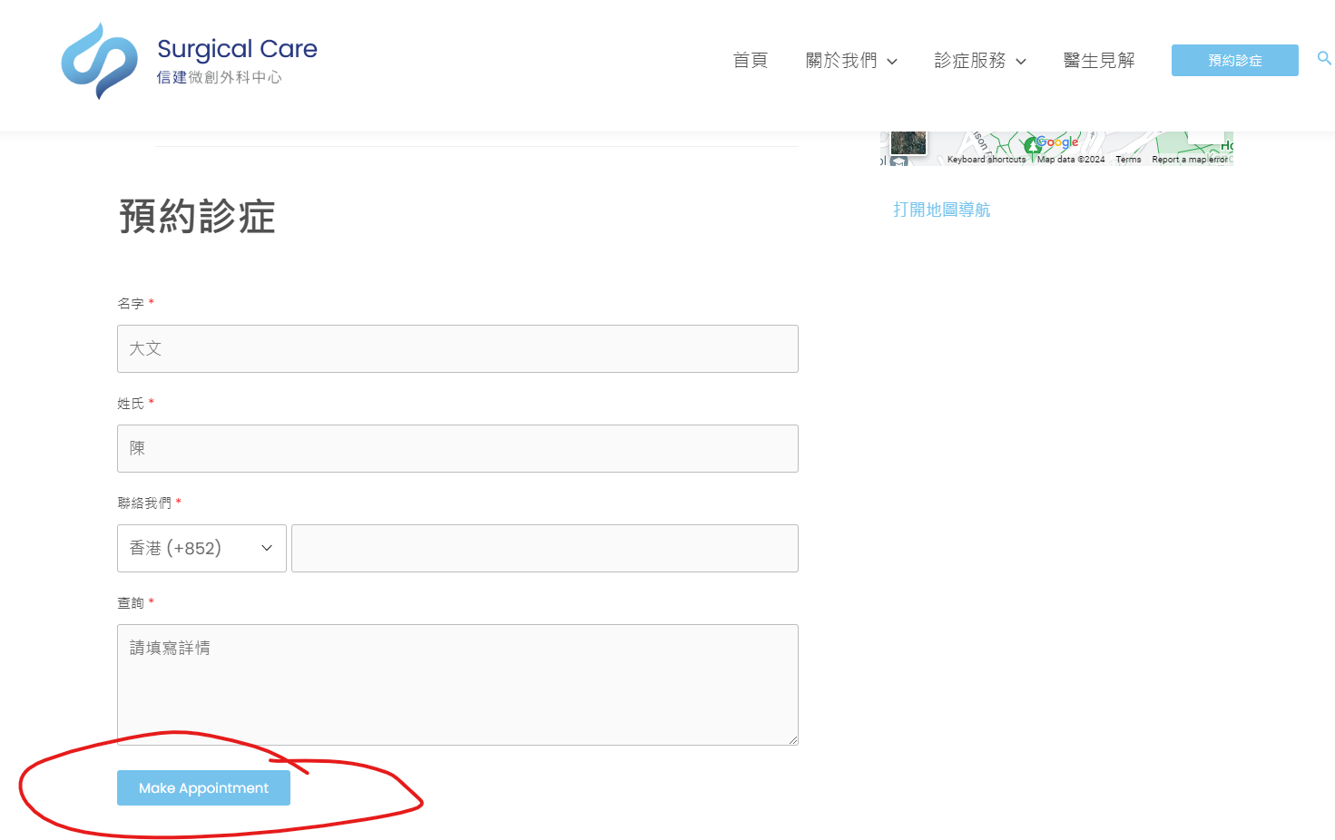

I am trying to translate a button in the submit form I set on the webpages
I expected to see: 預約診症
Instead, I got: Book An Appointment

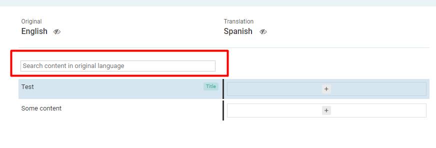

Could you please tell me which plugin you use to create the form?
If the form content is translated in the WPML translation editor, please edit the translation and use the search field to find the button text.
