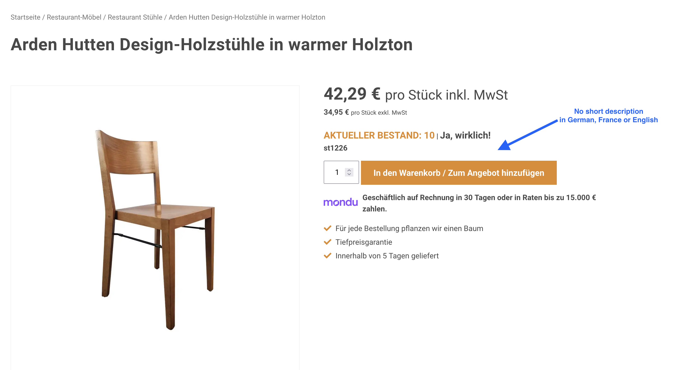

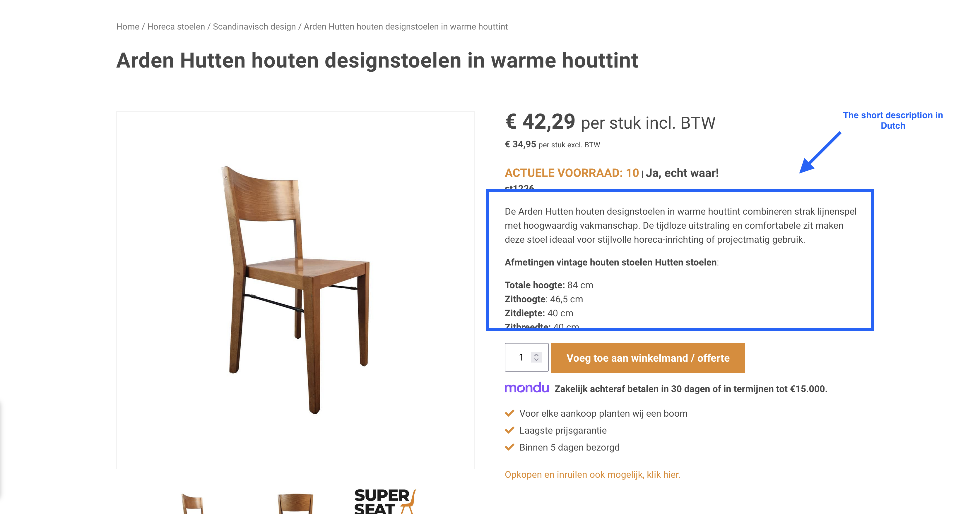

The product "Arden Hutten houten designstoelen in warme houttint" (the product of the product link you sended back) is not automatically translated. As you can see between the languages. Only the Dutch version of this product contains a description. See attachments.
So I have no clue what the difference is between the test product and this actual product.

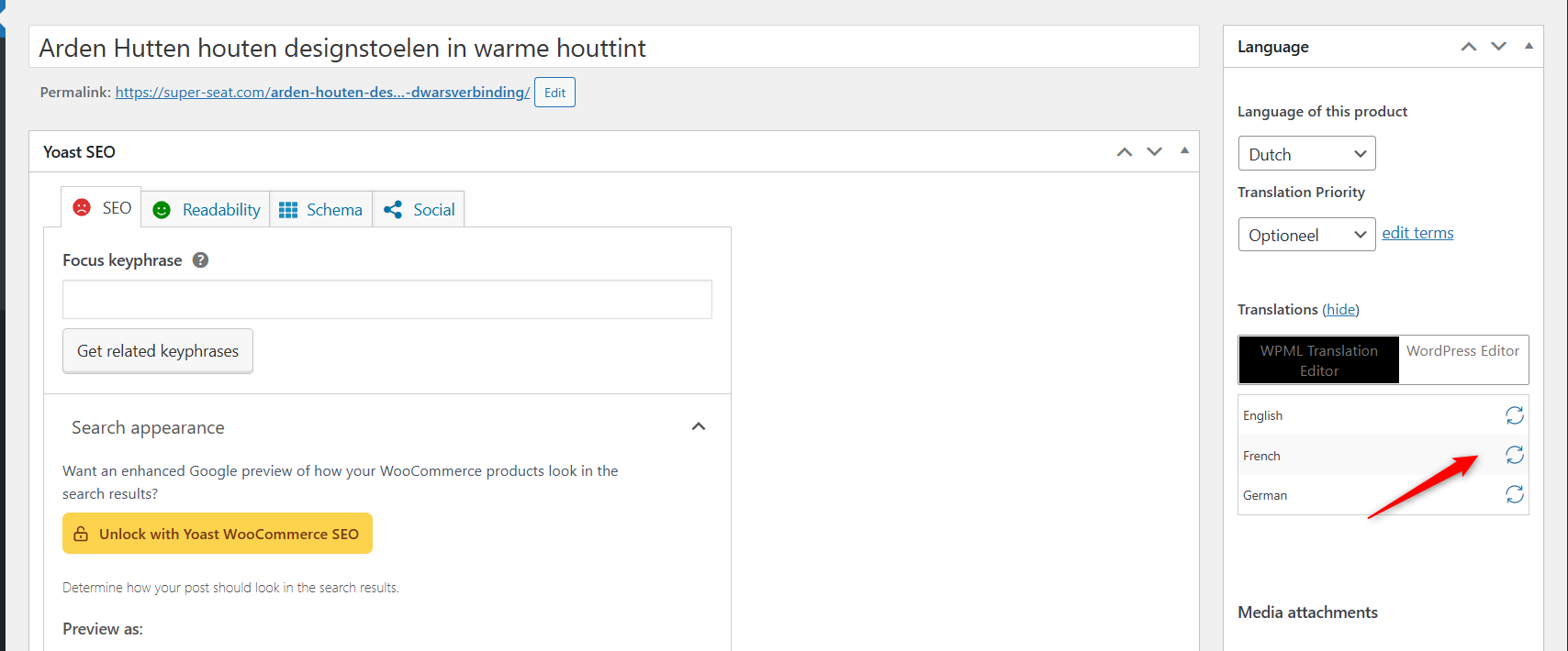

We noticed that the product “Arden Hutten houten designstoelen in warme houttint” is showing the translation status as “Translation needs update” in the post edit screen.

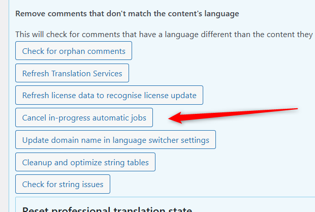

Therefore, we please try the following steps after taking a full site backup. Refer to the attached images for more details.
1) Upgrade to the latest version of WooCommerce (10.0.2)
2) Visit WPML >> Support >> Troubleshooting
3) Click on the following buttons
- Clear the cache in WPML
- Fix element_type collation
- Set language information
- Synchronize local job IDs with ATE jobs
- Synchronize translators and translation managers with ATE
- Cancel in-progress automatic jobs
4) Clear all types of caches
5) Open the page for editing in the original language
6) Make a minor change to the product in original language: hidden link
7) Save the changes
Thanks!

I've done the steps. After that I made a small change in the product "Arden Hutten houten designstoelen in warme houttint". But it stil wasn't auto translated. So in the Translation Management I've added the product manually for translating. And after that the product is correctly translated (with the small change). After that I removed the small change and updated it. After that all translations were also updated and the product is not in the Translation Management.
Do you think it is now fixed for all current products and future products? Or do I need add all products manually before they are auto translated?

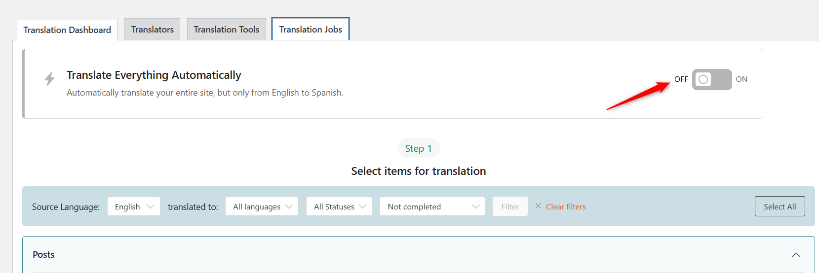

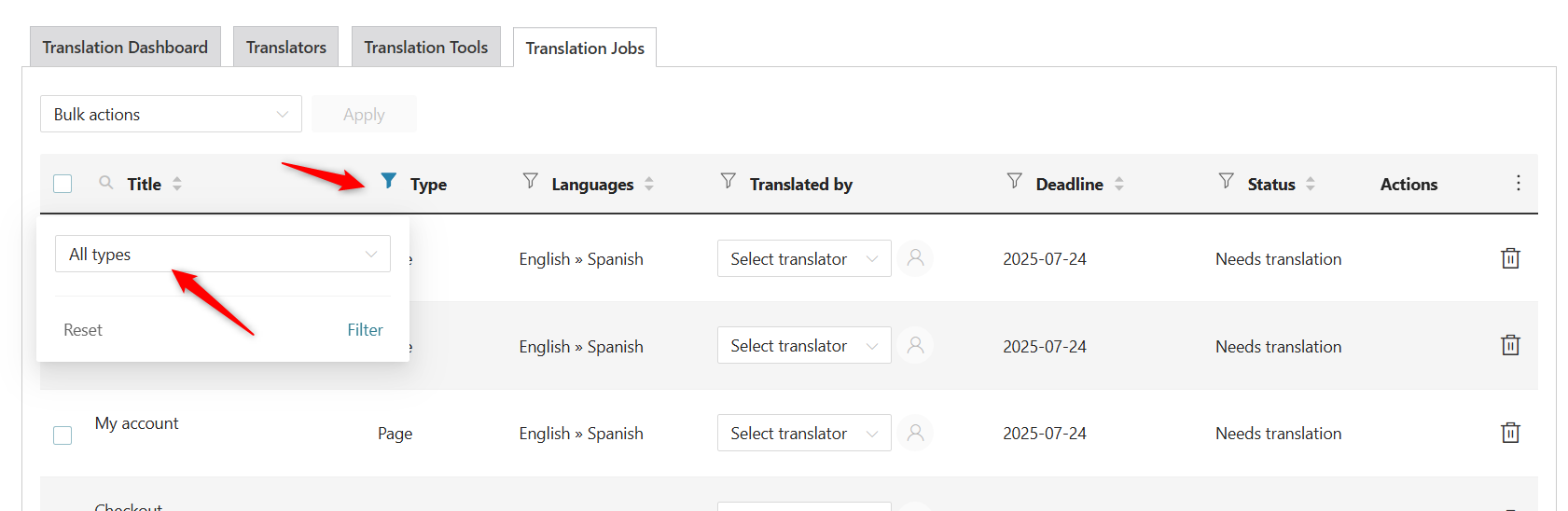

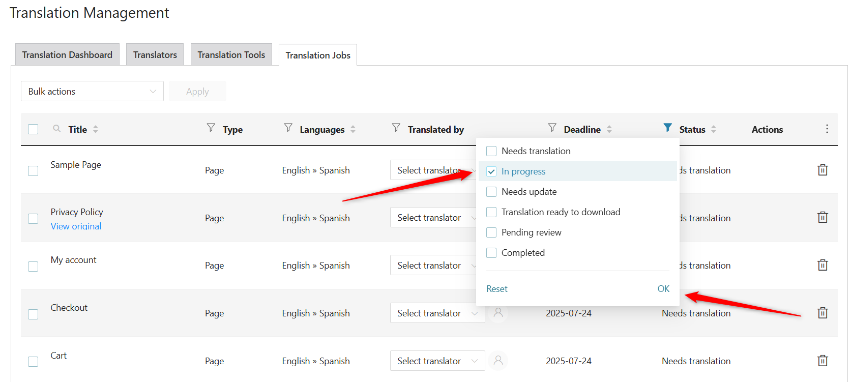

As a next step to track this, please do the following after taking a full site backup:
- Go to WPML >> Translation Management and temporarily disable the Automatic Translation option.
- Navigate to WPML >> Translation Management >> Translation Jobs.
- Filter the post types by Product
- Filter the post type by Status ("In Progress")
- Then check how many products are showing the "In Progress" status.
This will help us identify the issue more effectively. Refer to the attached images for more details.

Well, the test products are translated and continue to work as expected. But there are some newer and older products which are still waiting to be translated. Also there are some new products which have the status "Translated", but there is no product description at the DE, FR en EN languages of the product only the main language (NL).
After I made a small change to that product's description, the products is given the status "Needs translation update". With that I can manually add the product to the auto translator and the product is fully translated. After that I removed the small change (I forgot the remove it before and all translation had this small change) and all languages of the products is automatically translated without adding it manually to the translator.
