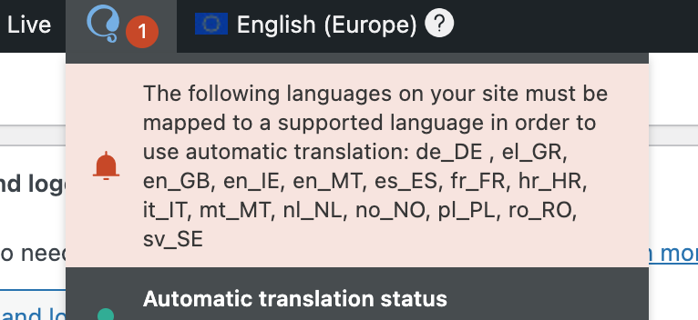

I am trying to automatically translate all languages on my site using WPML. The languages are mapped correctly, but I'm encountering an issue. As you can see in the screenshots I have shows Romanian as an example, we need to use custom codes ro_RO, so we have ro_RO setup to map to ro
Yet it's in the error message as not being allowed - there are multiple languages with this error, yet other languages setup exactly the same work completely fine
eg slovak. sk_SK -> sk
Then we have the issue of German de_DE -> de not working, while German austrian and swiss de_AT -> de, de_CH -> de work perfectly fine - I can't figure out the pattern what's causing some to work and others to fail
The following target languages do not support automatic translations. I'm getting the message in the title.
Why am I receiving a message that certain target languages do not support automatic translations?
How can I resolve the issue of automatic translation not working for all languages?

While waiting for one of my colleagues to be assigned to your ticket, please go to WPML->Languages-> Edit languages and under the language mapping column, map these languages using custom locales to the correct language and save.
Once that is done go to WPML->Translation Management->Tools and verify that the languages are showing OK there as well.
See detailed steps here:
https://wpml.org/documentation/automatic-translation/using-automatic-translation-with-custom-languages/#in-the-automatic-translation-settings

As you can see in my screenshots in the original post this is what I have done, multiple times at this point, and it doesn't solve the issue unfortunately

Can you increase the max_input_vars on your server to 3000 and save the mappings once, or you can disable all languages except few languages with issue and try to save the mapping once to see if it helps.
November 24, 2025 at 10:44 am #17604130
jamesP-11
We increased max vars to 3000 and still no luck unfortunately
