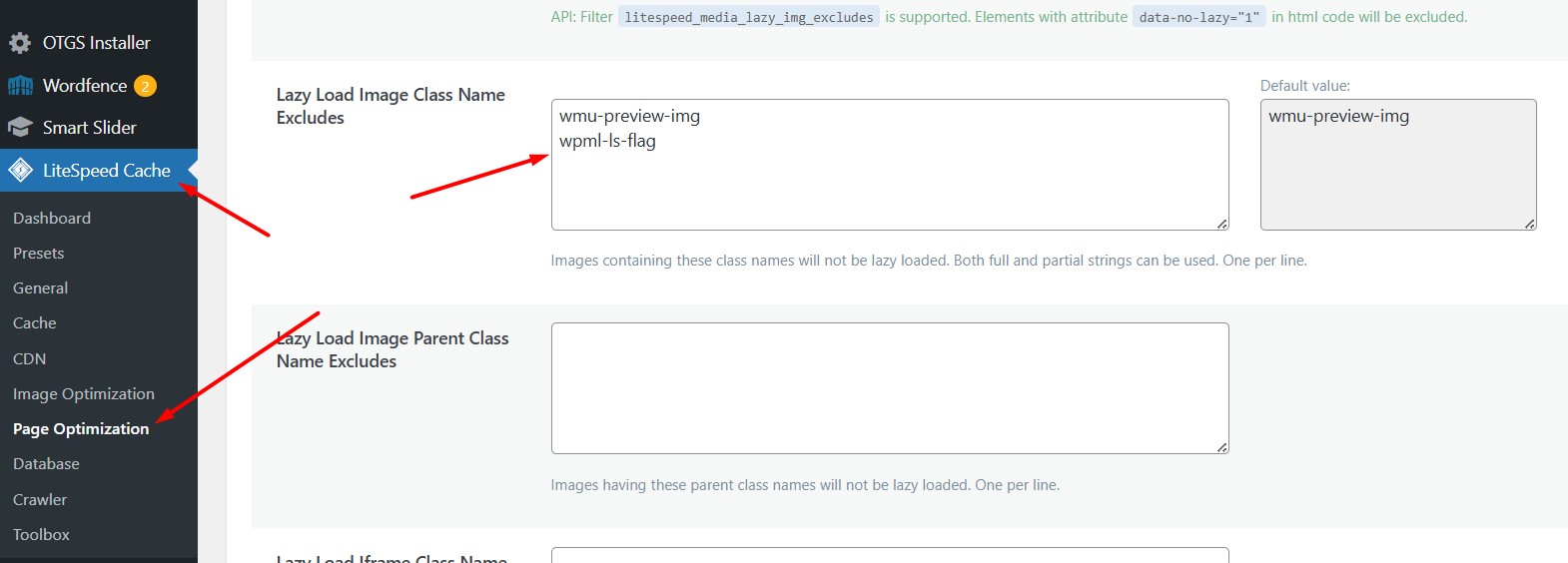

To fix the frontend flag visibility issue:
1. Navigate to LiteSpeed Cache >> Page Optimization.
2. Open the Media Excludes tab.
3. Add the "wpml-ls-flag" class name in the "Lazy Load Image Class Name Excludes" field.

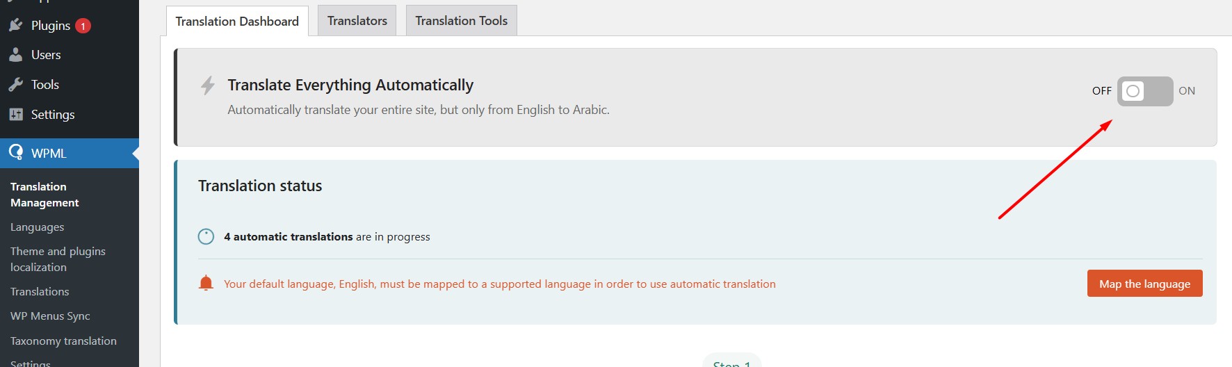

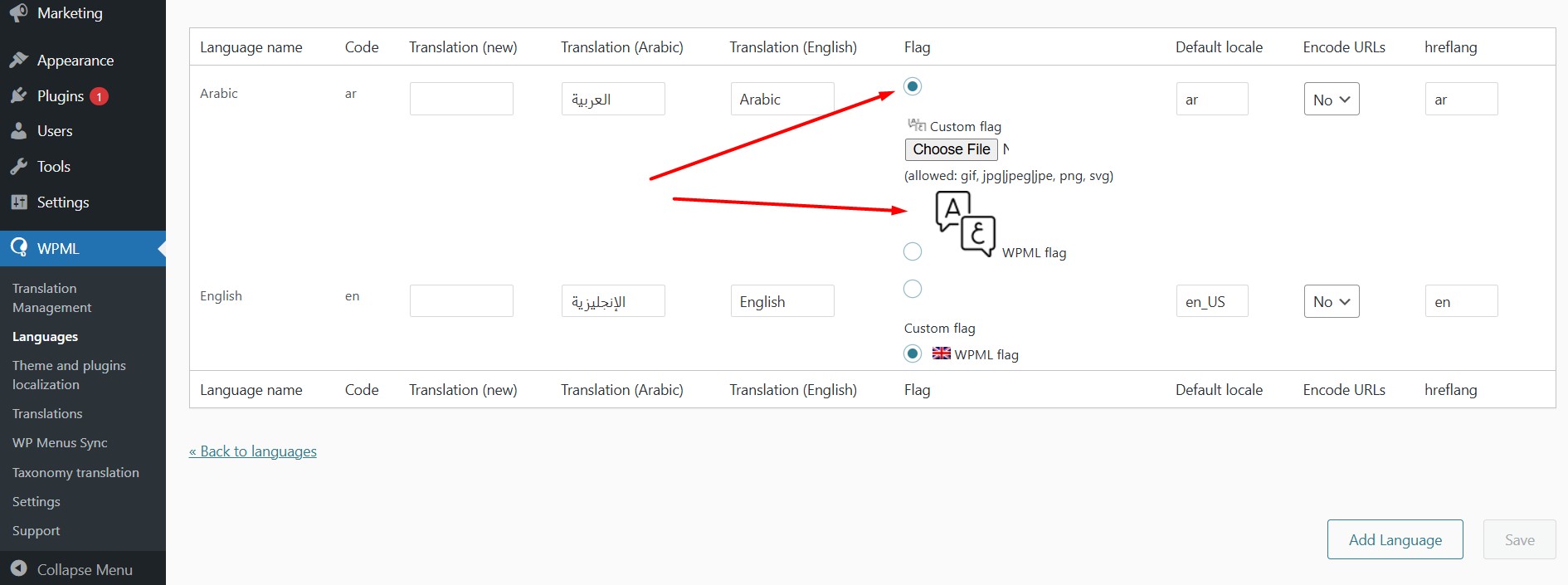

Thanks for providing the login details. This type of issue usually happens when the language mapping fields are not set from WPML >> Languages > Edit languages page. So, I followed the below steps in order to fix this issue:

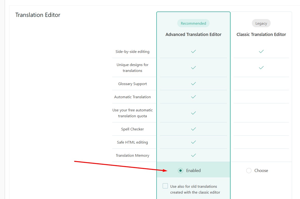

1. Enabled the Advanced Translation Editor from WPML >> Settings as you can see in the attached screenshot.
2. Disabled the Translate Everything Automatically option from WPML >> Translation Management page.

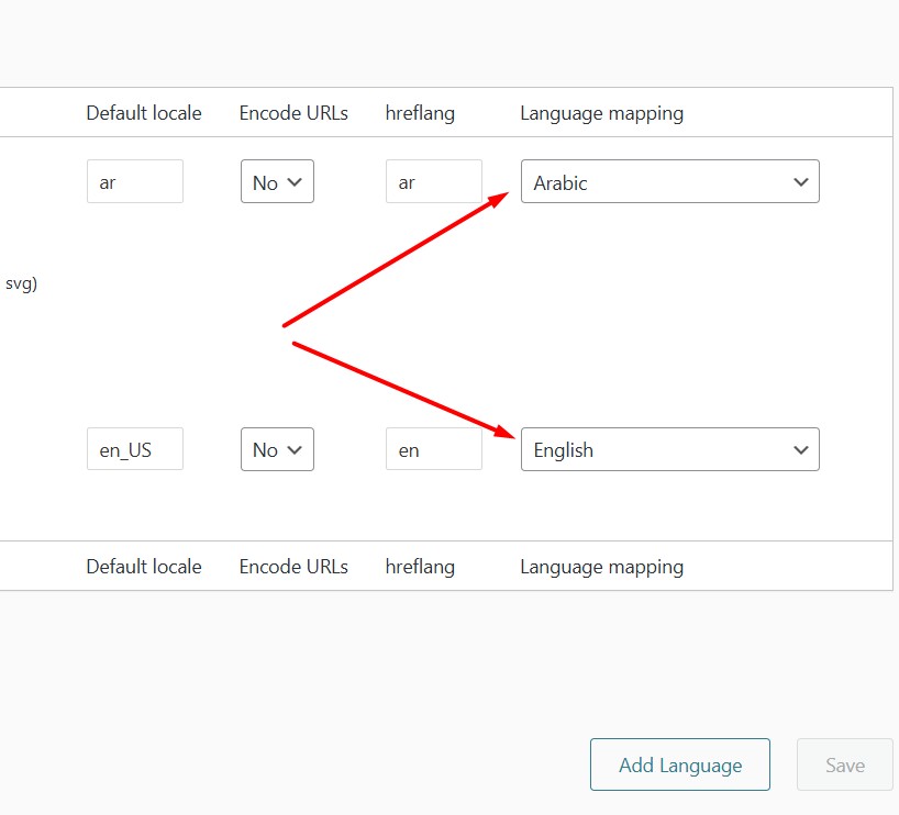

3. Went to WPML >> Languages > Edit language page, map the Arabic language with Arabic and English language with English and press the Save button.
4. Disabled the Advanced Translation Editor and Enable Classic Translation Editor from WPML >> Settings page.
Then I’m able to upload the custom flag without any issues as you can see in the attached screenshot. Could you please check and confirm?

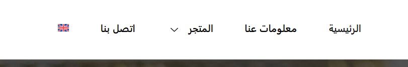

ahmede-36

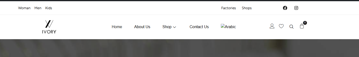

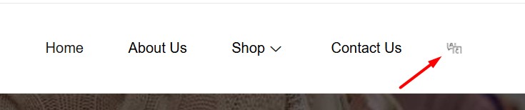

you are now make an issuse in the website yes iam was enable to upload the icon but dosent worked iam try to defiranet logo img and dosnet show me in menu the eng flag is missed please fix it
September 5, 2025 at 6:05 am #17377794
Noman
Glad to hear you are able to upload the custom flag now.
For fixing the frontend flag visibility issue, I followed the below steps:
1. Went to the LiteSpeed Cache >> Page Optimization
3. Added the “wpml-ls-flag” class name in the “Lazy Load Image Class Name Excludes” field.
Now, flag images are showing correctly at the front end as you can see in the attached screenshot.
Thank you
