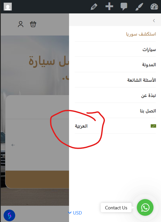

I am trying to use the Arabic language switcher on a mobile device. The issue can be seen on this page: hidden link.
The menu alignment when switching to RTL language in the mobile interface is not correct. The language name and menu arrow collapse.
Why is the menu alignment incorrect when switching to RTL language on mobile?
How can I fix the collapsing language name and menu arrow?

Note that this is a theme-specific issue.
Please add the following CSS at WPML > Languages > Language Switcher Options > Additional CSS:
@media screen and (max-width: 991px) {
    .header__center #st-main-menu .menu.main-menu > li > a {
        justify-content: flex-start;
This should solve the issue.
Let us know if further assistance will be needed.
