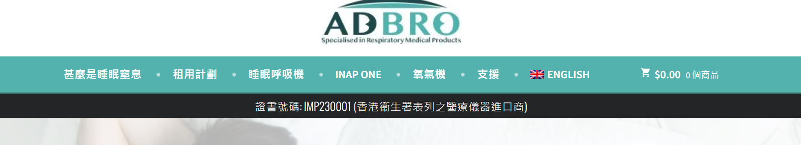

I am trying to: save the main menu bar to primary
I expected to see: with the WPML Multilingual CMS on should be seen the same
Instead, I got: the menu bar deselected "primary" and the second language is not showing at least the flag isn't there.

it worked few days ago after your reply, and today, the menu bar disappeared again.
I tried to select the primary for the main menu bar, but whenever wpml is on, it won't work, so I need to turn off wpml now to make the menu bar appear, please help to fix this issue, I need the second language on as soon as possible.
