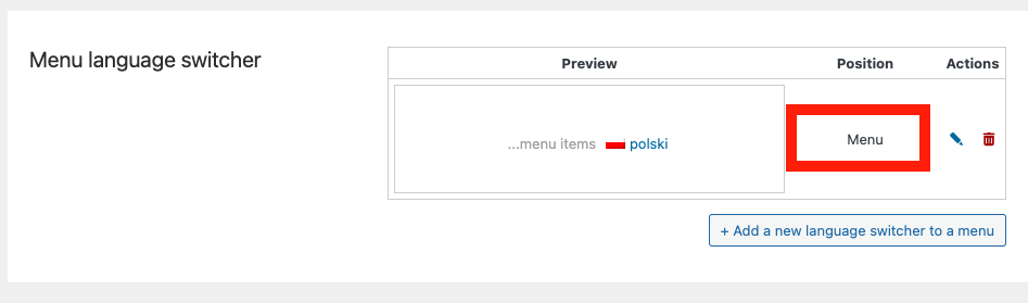

I've checked your Website, and I noticed that you had configured the "Language Switcher" in WPML > Language > Menu language switcher to "Menu" as shown in the attached screenshot.
To display the "Language Switcher" on the correct menu, you need to edit that option by clicking on the "Pencil" icon and setting the "Menu" to "Menu no countries".

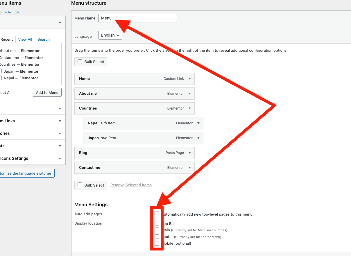

I've checked this "Menu" hidden link and it's not assigned to any "Display Location" as shown in the attached screenshot. Are you using the correct "Navigation Menu" that you want on your Website?
