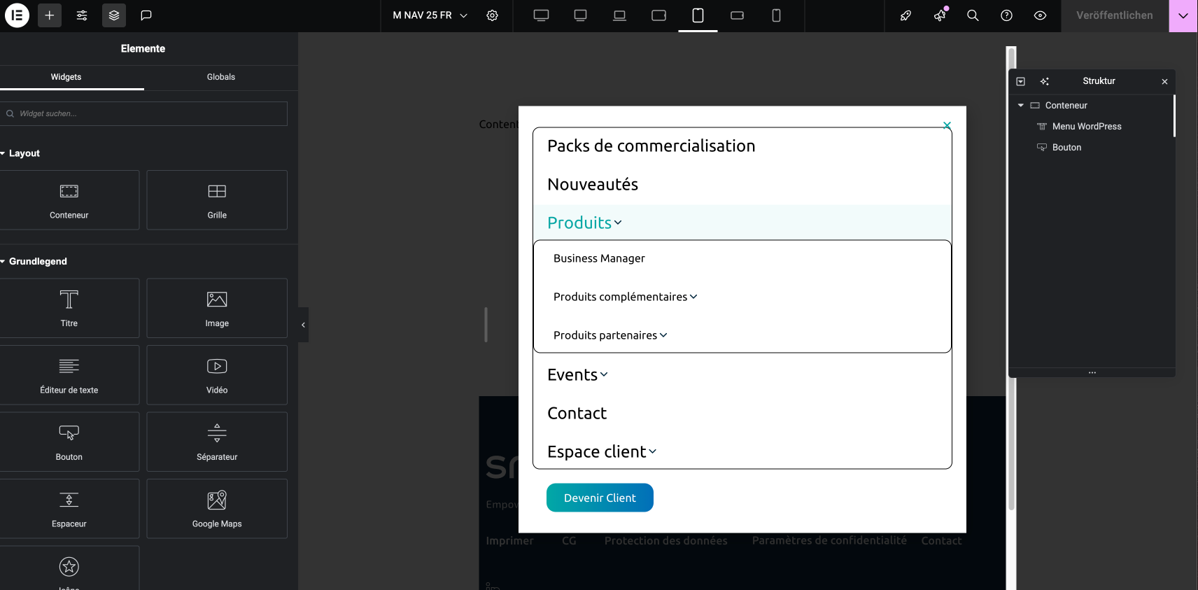

I am trying to ensure that the mobile popup menu works correctly on tablet and mobile views when switching languages to French and Italian. The default language, German, works fine. I have checked translations, popup templates, and tested on my local installation. I also deactivated all plugins except Elementor and WPML, but the issue persists. The theme in use is Hello Elementor. Link to a page where the issue can be seen: hidden link. Also, in Elementor editor view everything work fine when the language is changed to French or Italian.
The menu popup doesn't work as it should when the language is switched to French and Italian.
Why does the mobile popup menu not work correctly when switching to French and Italian?
What steps can I take to resolve the issue with the popup menu in different languages?

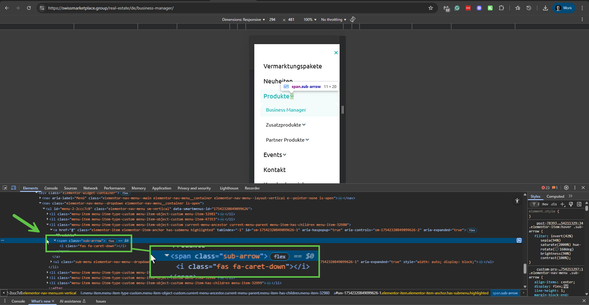

I can see the problem on the mobile view of your site. In French, the arrow down icon is not showing, but when pushing the sub menu, it does show. In Italian, the icon does not show, and no sub-menu is shown when pushing the parent item. I can also see that the following HTML element is missing in French and Italian.
<span class="sub-arrow"><i class="fas fa-caret-down"></i></span>
Please see the attached screenshots. This is to show the arrow-down icon. But we can see that in French it is not preventing the sub-menu from showing when pushing "Produits" for example.
I suggest that you carefully check the Elementor template for the menu and see if it is updated in Italian and French. I also recommend that you re-save the French and Italian WP Menus and check if this resolves the issue.
