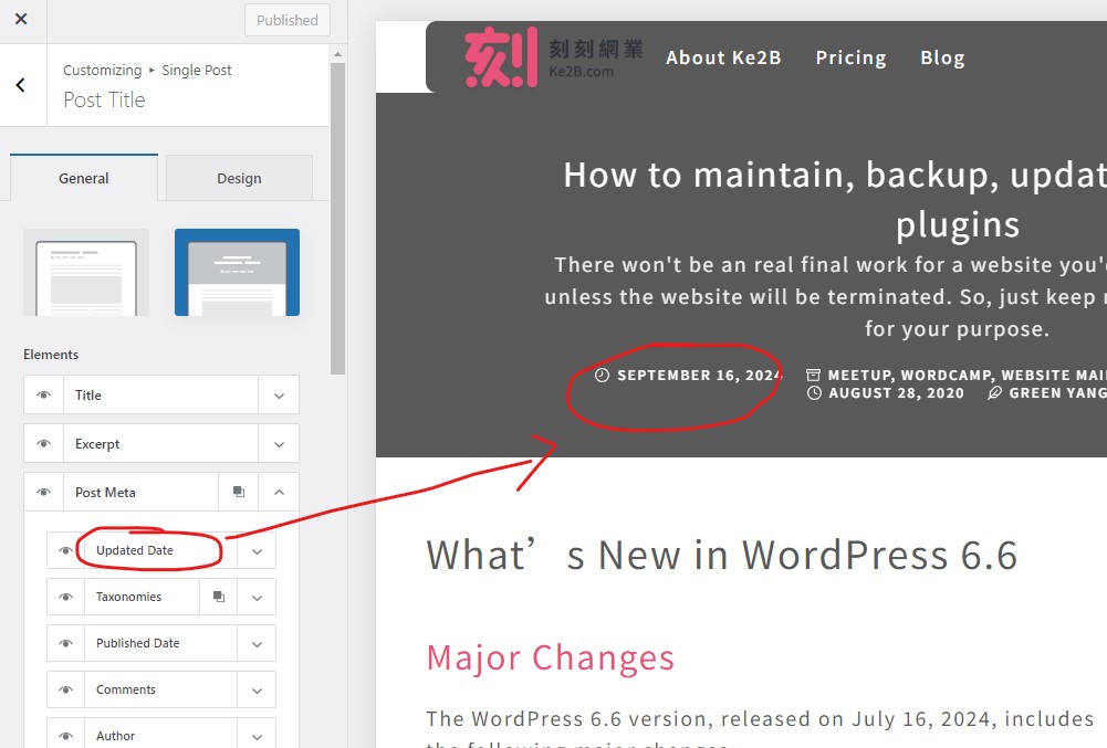

I was able to find the source of that "update time". It is coming from Customizer -> Blog -> Single Post -> Post Title -> Post Meta.

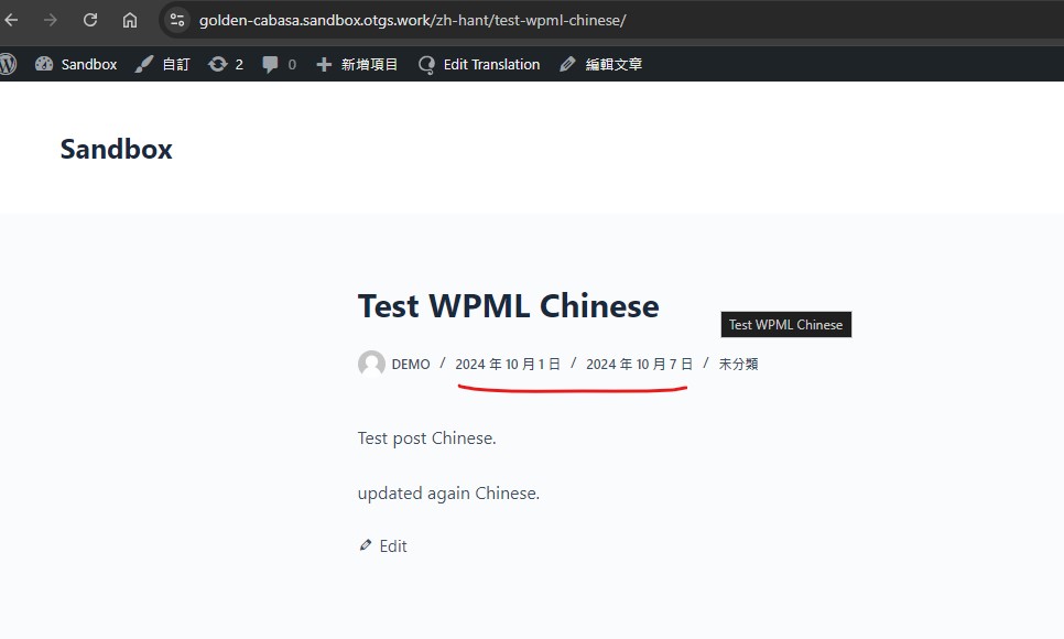

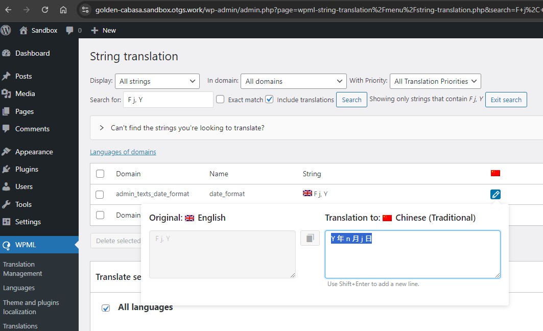

So I compared my sandbox site and your test site. In my sandbox site it is working fine hidden link based on the translated "date_format" (from admin string's admin_texts_date_format).
While in your test site it isn't.

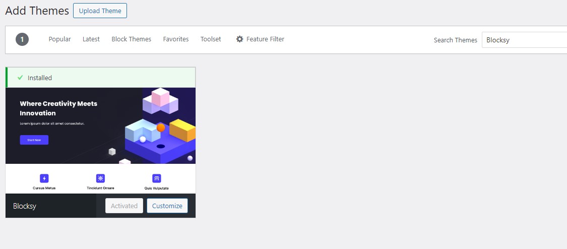

To further check this, I wanted to rename or delete your current Blocksy theme, and then install the fresh copy from Themes -> Add New and check again. So I can verify about any customization.
But unfortunately the restricted access you provided, doesn't allow me to look for theme's source code, as well as, removing/renaming and adding the theme anew.
All screenshots are attached for comparison.
So I'll request again to provide me unrestricted access to your test site, or, reproduce the issue in my sandbox site, so I can then further investigate.
Apparently, in a fresh setup, like my sandbox, there's no such issue and dates are formatted/translated accordingly and correctly.
