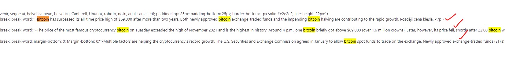

I have translations of the notification email that WPForms sends. In the native language, the text is split into paragraphs, but the translation, is sent as a solid text. It is a text email that the client receives as a confirmation. If I add <br> to the original text, there is a larger double space between paragraphs in the original and in the translation, the text wraps to a new line.

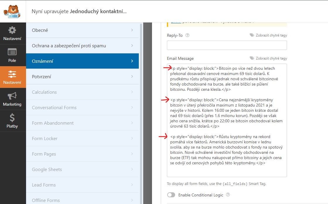

I did some tests and noticed that since you had added the email message without any HTML tags, but using simple line breaks (i.e. pressing ENTER for new line and twice for new para) - this is stripped out in ATE when translating.
That's the reason you see all that text in one single box for translation, in the ATE.
So I tried a few things, that I used SPAN and then used P tags to format that text in form's email notifications (see attached). Then updated the translation. In ATE, these 3 paragraphs were presented separately.
Now, when I send form in English, I can see the text separated by the paragraphs.
Does this helps resolving the problem? Or if not, can you please write me detailed steps to reproduce the problem?

Thank you for solving the problem. Just to add that even in HTML there must not be paragraphs that are then converted to
in the base language.
