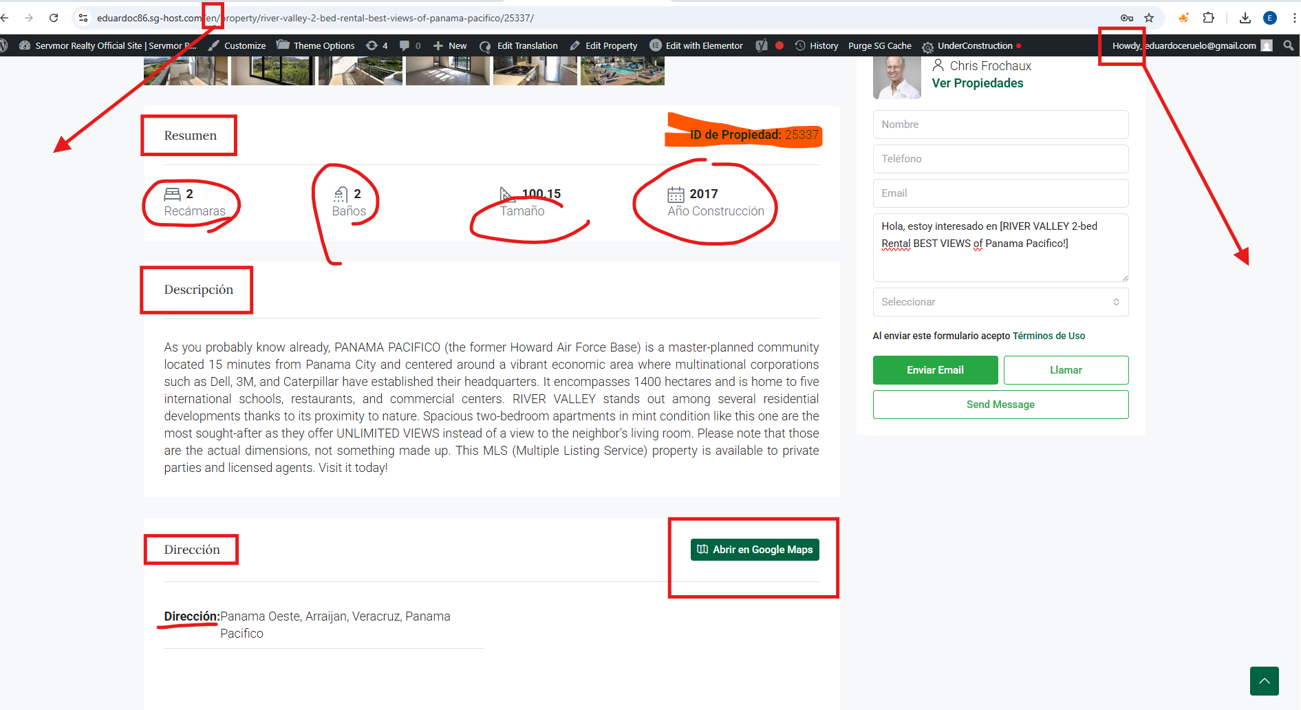

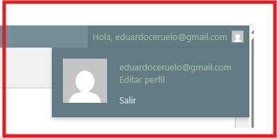

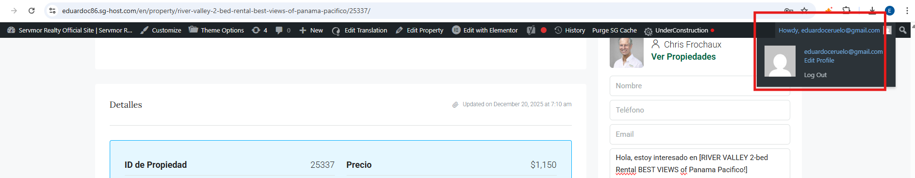

The translations change on their own, as does the system language; WPML is doing strange things, the translations change, and the admin is assigned a different language.
The system is acting strangely. I've translated the property pages many times, and after a while, the translations change. It's also happening now with the WordPress admin language, which is set to Spanish by default but then switches to English.
This is very frustrating ... is a bad plugin for me. Crazy translations, more than a mounth with this issue...making changes all time...
December 26, 2025 at 10:45 pm #17689072
eduardoC-35
Por ejemplo, voy a traducción de cadenas, y busco una cadena que ya he traducido muchas veces pero siempre se vuelve a cambiar:
Cadena: "Al enviar este formulario acepto" la busco y aparece en inglés sin asignar la traducción, esto ya lo he realizado muchas veces repito!
a cadena está asignada al idioma inglés cuando es una cadena en español, cambio el idioma, la traduzco de nuevo y funciona, pasados unos días vuelve a estar mal otra vez.

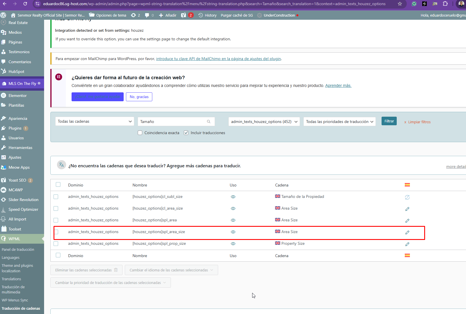

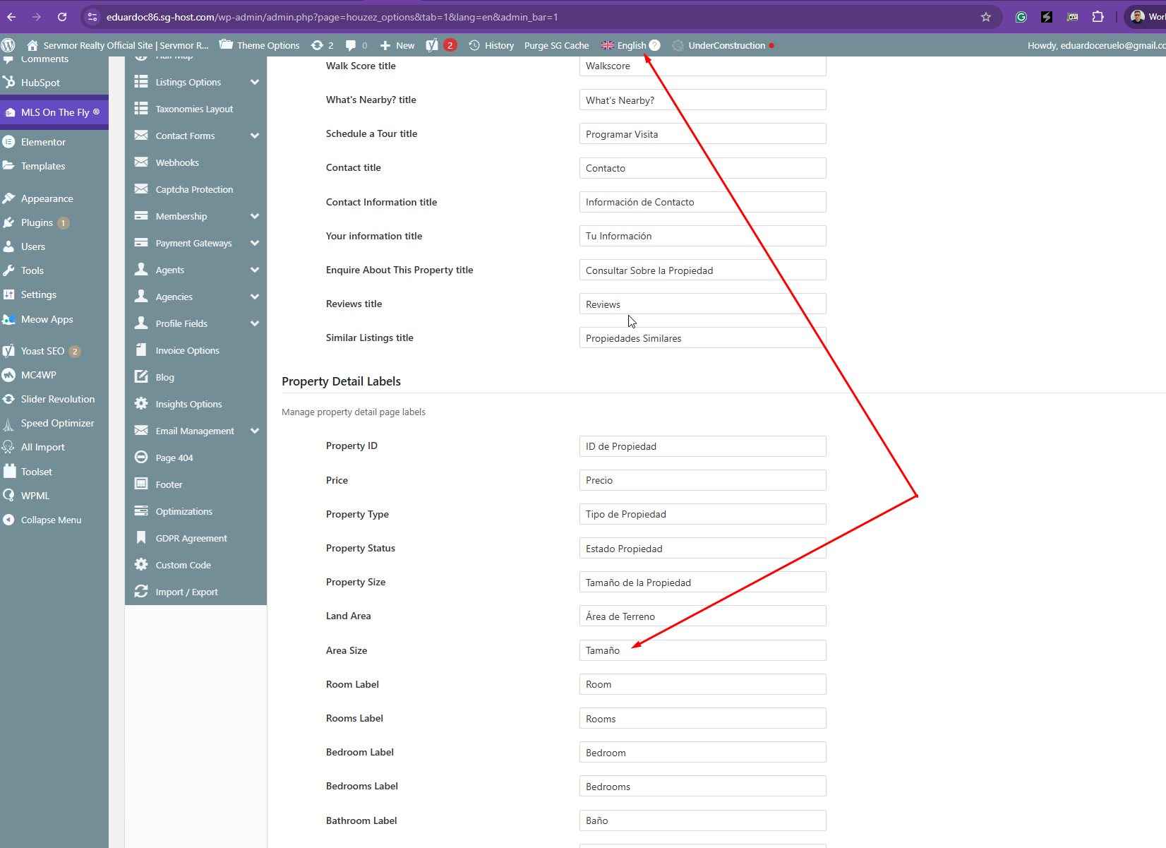

Thanks for your reply. I’ve checked your website and can confirm that the strings are being translated correctly in String Translation. Specifically, I’m referring to the string “Area Size”, which appears correctly here:

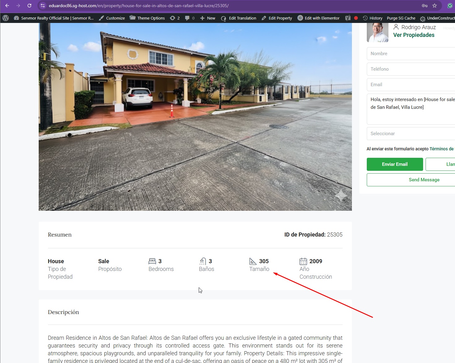

However, when I checked the theme options page in English:
I noticed that “Area Size” is displayed as “Tamaño.” This indicates that the value from the theme options is overriding the translation coming from String Translation.
Could you please confirm whether the strings were translated directly inside the theme options previously, or if you only used WPML String Translation for this?
I’ve attached a few screenshots for reference to help clarify the behavior I’m seeing.
January 2, 2026 at 5:45 pm #17700839
eduardoC-35
As you can see, I've translated both several times. At first, it works fine for each language, with the corresponding words, but after a few days, everything breaks down and it only shows up in Spanish. I have no idea what it could be, but it's very annoying to have to repeat this adjustment so many times.
First i translated directly inside the theme and after y used WPML String Translation for this.

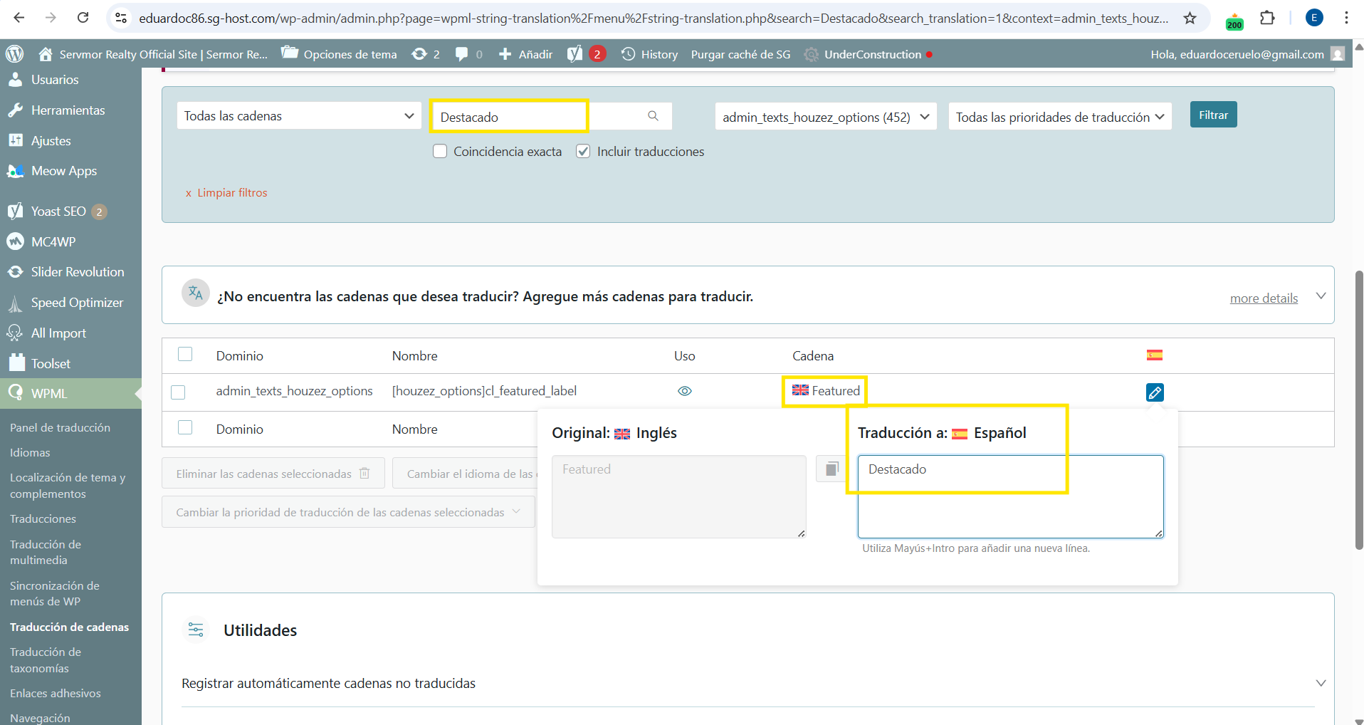

For example with the string translation, the word, "featured" is tranlated to "destacado" but in english page it is showing in spanish

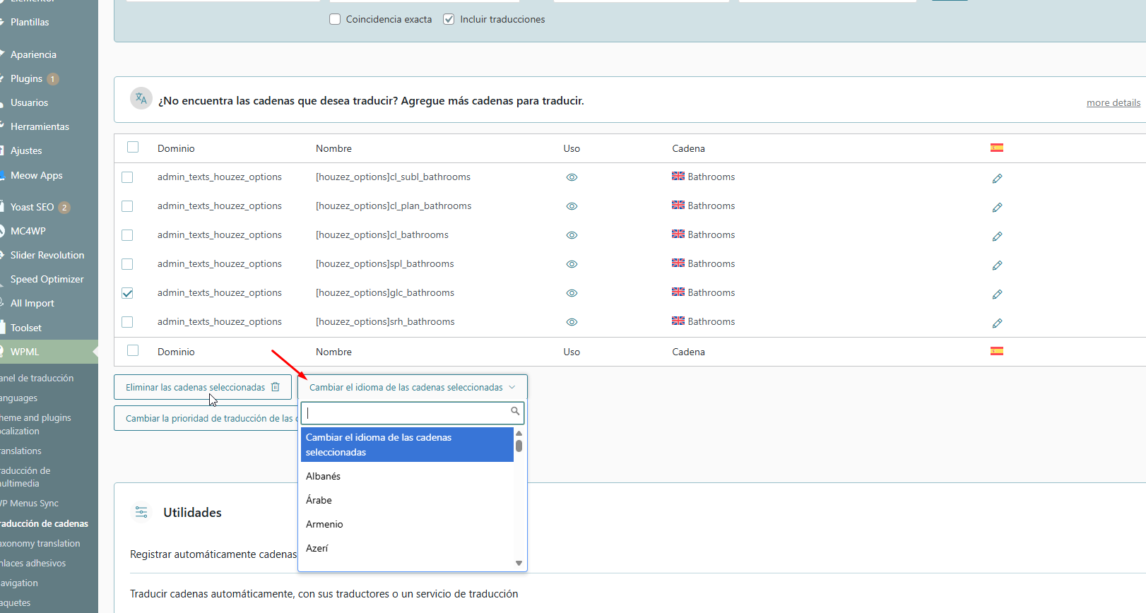

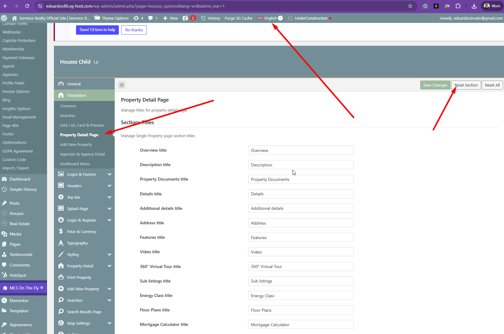

Thanks for your reply, and sorry for any inconvenience this may have caused. I’ve reviewed the theme’s documentation here:
According to the documentation, the theme options need to be translated using WPML String Translation, and not via any other method.
Could you please make a small adjustment to the translation again using String Translation so it displays correctly on the English version of the page below?
hidden link . If a string is showing the wrong language, you can use the "Change String language" option as shown in the attached screenshot.
After that, we’ll monitor the site for a few days to see if the issue reoccurs.

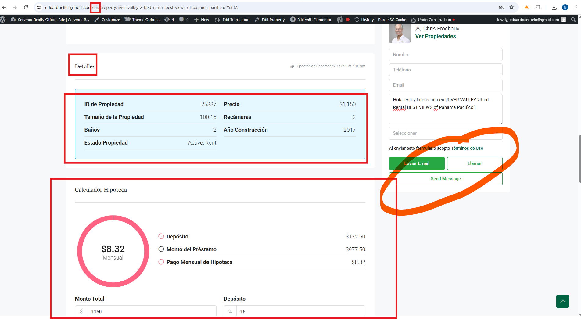

I did what you told me, I deleted the default theme translations and left only the WPML string translations. Now, everything looks correct in English, but it's not translating in Spanish.
I also got a new error in Spanish: the main menu logo isn't showing up in Spanish anymore.
The same thing happens with the rest of the translations on the entire page; now it doesn't show me anything in Spanish, but it does in English. All the strings are translated in the string translator.

Thanks for your reply. I found a solution to this. We need to reset the theme options for "Property Details Page" in both languages.
1. Use the language switcher and select a language
2. Navigate to theme options > Property Details Page > Click Reset Section
3. Change the language and reset it.
Now it shows up fine for both languages.
