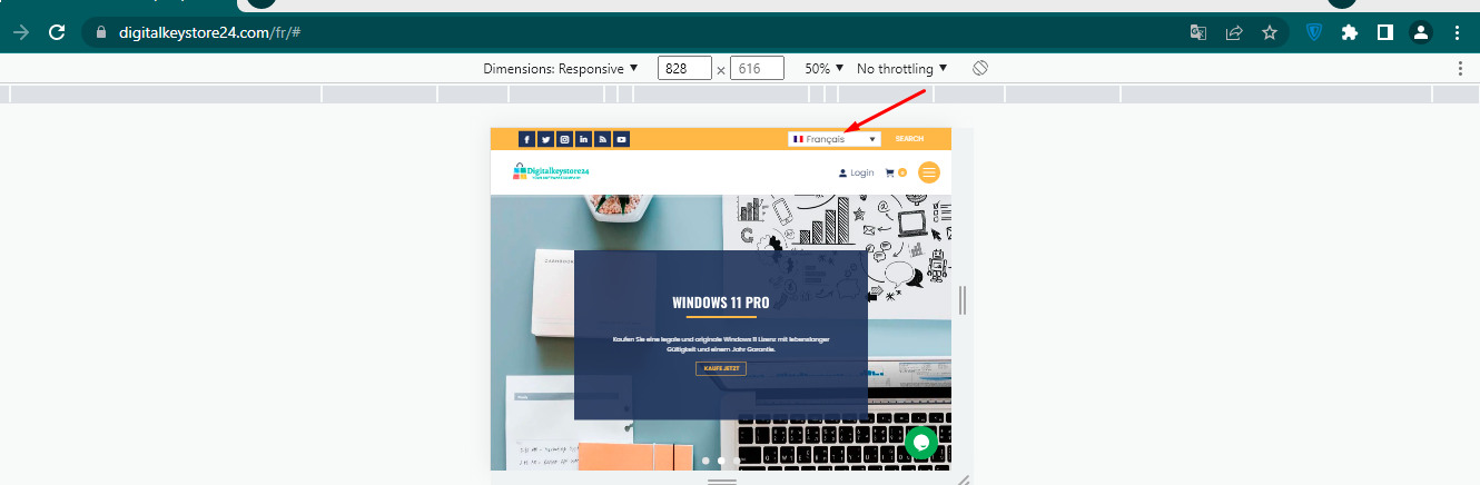

The widget of WPML Language Translator is not working in mobile, short screen.

I've checked and found that the language switcher only doesn't work when it's placed within the Microwidget area of The7 Theme. However, when the language switcher is placed on a page, it functions correctly. For a clearer view, you can visit this page (hidden link) from a mobile device to see how the language switcher placed on the page works.
It's possible that the theme disables certain features on mobile devices for performance or design considerations, or the event handling on mobile devices isn't configured correctly. Given that the language switcher functions correctly on other parts of the site and only encounters issues within the Microwidget area of the The7 theme, it would be best to report the issue to the The7 theme. They can provide insights into theme-specific settings or issues that may need to be resolved.
