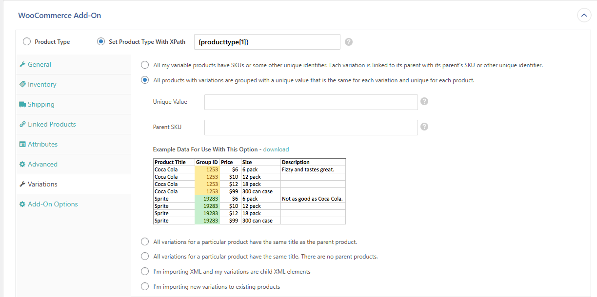

We are importing simple products regularly using the guide here: hidden link. It works very well and stable. Now we want to import variable products as well. We have been looking at this guide: hidden link. However, we cannot figure out how to set up the combined sheet. We want to use Example B. We have tried to extend your example, but the products are just imported into the default language, and it is not changed after running the WPML export/import-"job".
The products are just imported into the default language, and it is not changed after running the WPML export/import job.
How can we import the variable products in different languages?

Yes, I know that guide as well. However, It does not explain importing variable products using Option B in the import process. Can you explain that further?
Additionally, the test data looks like it is for option A, and we cannot use that option due to our data formatting.
