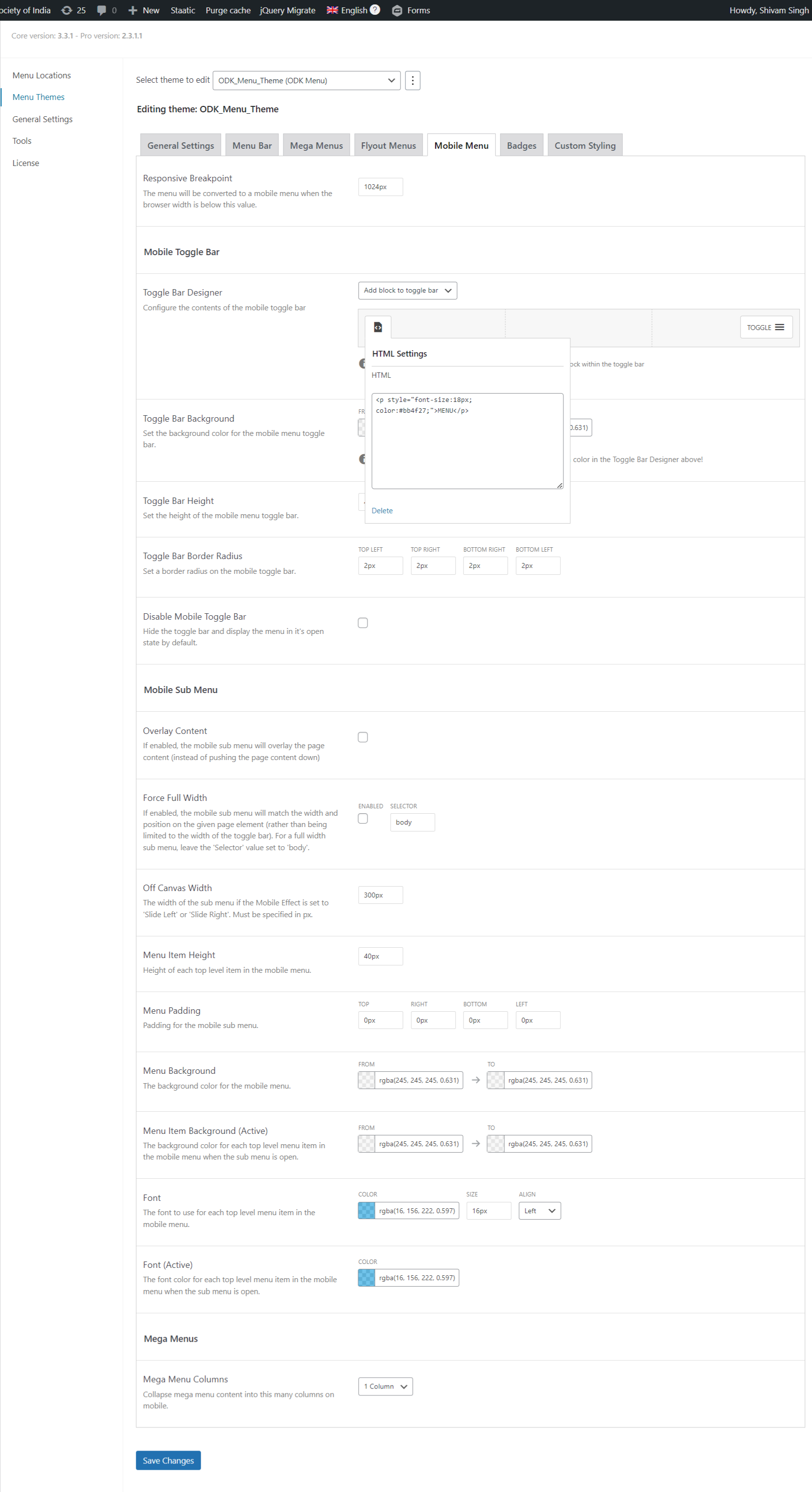

#1 - Shows how the Mobile Menu has been created (along with the Toggle Text)

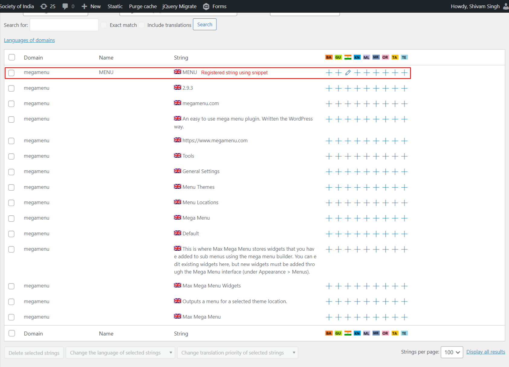

#2 - Shows that toggle text "MENU" is registered with the WPML string translation using the above PHP snippet and has been translated into Hindi Language

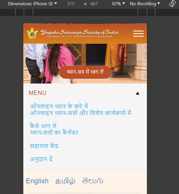

#3 - Shows the mobile menu in which the Toggle Text is still showing up even after translating the registered text through WPML String Translation in Step#2

According to what I see, it seems not to be the string that you need to translate.
You have to search for the complete string, including the applied HTML markup.
Please try to go to WPML > String Translation and at the bottom of the page click "Translate texts in admin screens".
Now search for the exact string, mark it, use the button to add it to String Translation, and translate it.
This should usually do the job. If this will not solve the issue, please let me know.
