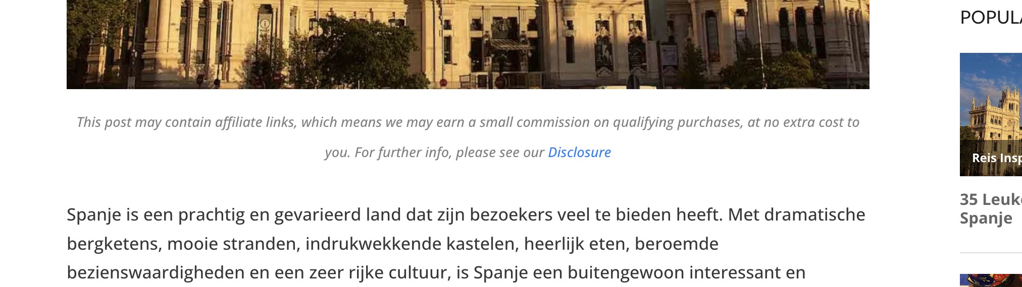

We are using the Ad Inserter plugin https://wordpress.org/plugins/ad-inserter/ to insert a basic disclosure under the first image on every post. We still cannot find where to translate the text inserted by the plugin.
Can we be pointed in the right direction?

Basically, Ad Inserter is adding this text dynamically on page load, in other words, you don't see it when in the post editor.
I have tried the methods described in point 1 and couldn't find anything. I am still working through what is described in method 2 to identify the type of string it is, if it is even a string.

I have tried everything, at least I think I have. Attached is a screenshot of the text inserted by the Ad Inserter plugin.
Yes, we are busy translating the site live, so not all posts are translated, yet.

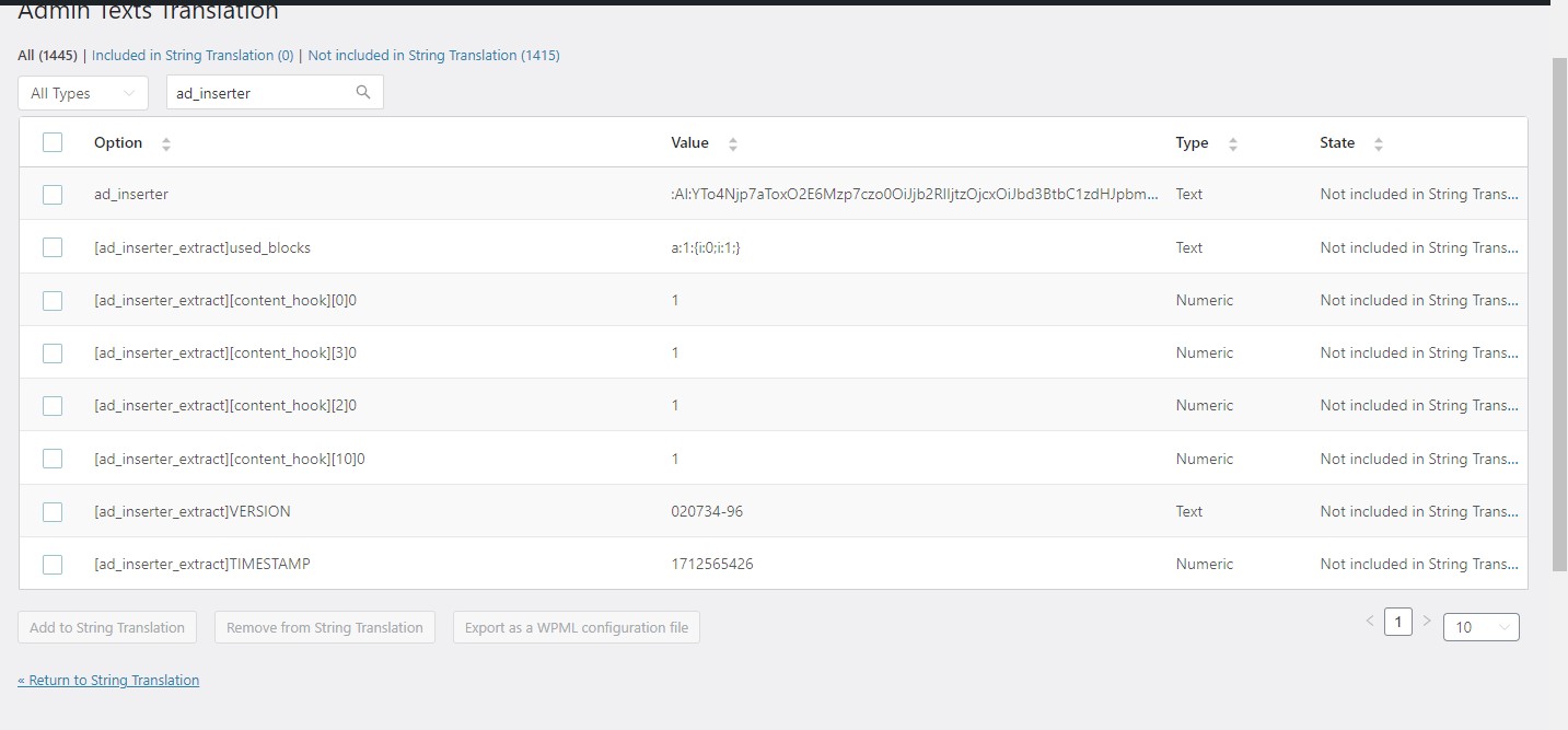

I have checked and it seems the AD Inserter saves the data in wp_option table but encoded, so even if you follow our guide for translation admin texts (WPML > String Translation > Translate texts in admin screens), I do not it would be much of help for you.
Since I do not see this plugin on our official plugin list, I advise inviting the author to our GoGLobal and we would be glad to help and work together in making the plugin compatible with WPML.
- https://wpml.org/documentation/support/go-global-program/
For your case, and as a workaround you can use WPML shortcode to make text translatable, for example adding text inside AdInserter like this:
[wpml-string context="ad-textdomain" name="ad-text1"]Some text to add as ad text[/wpml-string]
Then go to WPML String translation and translate it.
Hope this helps.
Drazen
