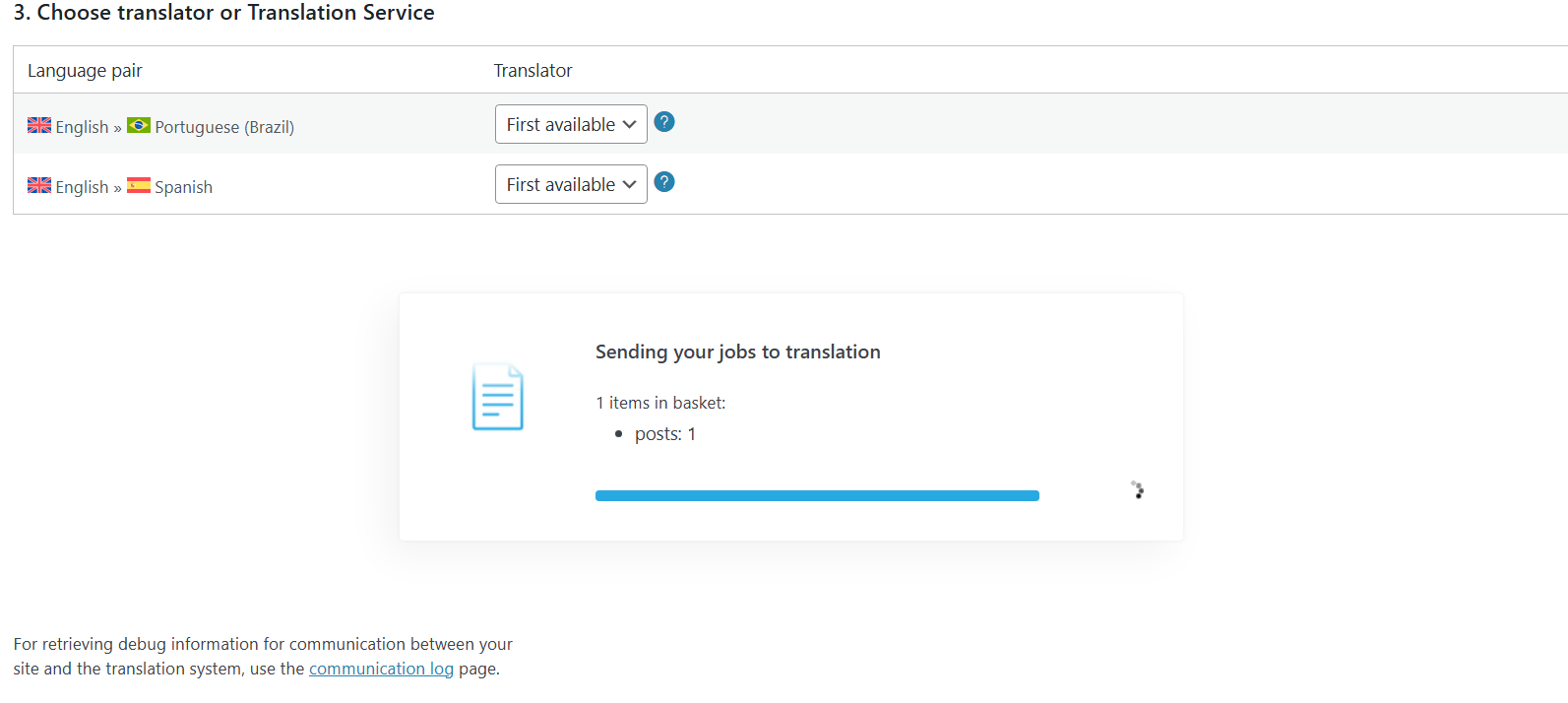

نبذة عن المشكلة:
I'm trying to translate the contact form using WPML. I went to Translation Management, added the contact form to the translation basket, and attempted to send it. The issue can be seen at: hidden link
أعراض:
The translation process is stuck in the sending mode.
أسئلة:
What is causing the translation process to get stuck?
How can I successfully send the translation?

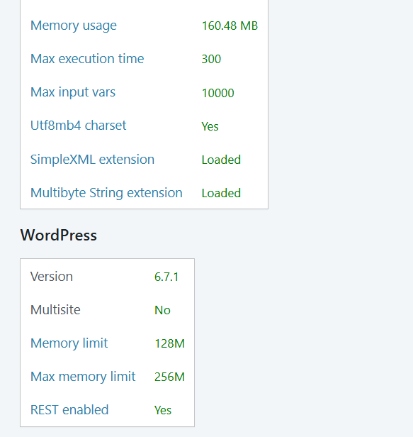

Thank you for contacting WPML support. While you are waiting for one of my colleagues to take this ticket and work on it, let me provide you with the first debugging steps and try to help with the issue quickly.
While checking the debug info, I see that the WordPress Memory Limit is below the requirements. The minimum requirements are 128M, but we do recommend 256M and the debug information of your site shows it set to 40M. Please check this link for more details
https://wpml.org/home/minimum-requirements/.
You can increase it by adding the following code in your wp-config.php file, right before the /* That’s all, stop editing! Happy publishing. */ line:
define( 'WP_MAX_MEMORY_LIMIT', '256M' );
define( 'WP_MEMORY_LIMIT', '128M' );
After adding the code you can confirm that the memory was changed correctly from WPML > Support > WordPress > Memory limit.
Once it's increased, please try to resend the form for translation again.
January 13, 2025 at 8:31 am #16586878
jin-juanG
Hello
Thank you for your reply
I did that, but it didn't solve the issue
best wishes
