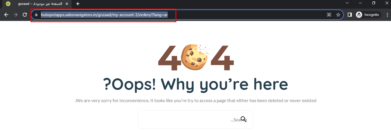

Yesterday, i have texted you regarding translated links issue and i got a response from your team saying "intsall woocommerce multilingual plugin then the issue will be resolved".
I did the same i have activated the "WooCommerce Multilingual & Multicurrency" Plugin however the issue isn't resolved.
November 7, 2023 at 6:07 am #14743057
webguruzT
The plugin "WooCommerce Multilingual & Multicurrency" fluctuates normal functionality of our website. that is why we have de-activated it earlier, and now after activating it we are facing the same problems.

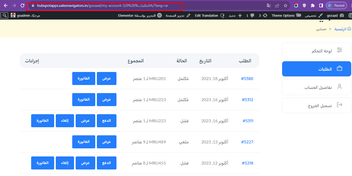

Upon reviewing the previous ticket, I got a clear understanding of the issue. Could you please verify that the WooCommerce My Account Endpoint has been accurately translated into the other languages?
- Activate the WooCommerce Multilingual Plugin
- Go to "WooCommerce > WooCommerce Multilingual > Store URLs"
- Make sure that the 'Endpoints' are translated correctly into Arabic language
- Clear the caches and try to access the my-account pages.
