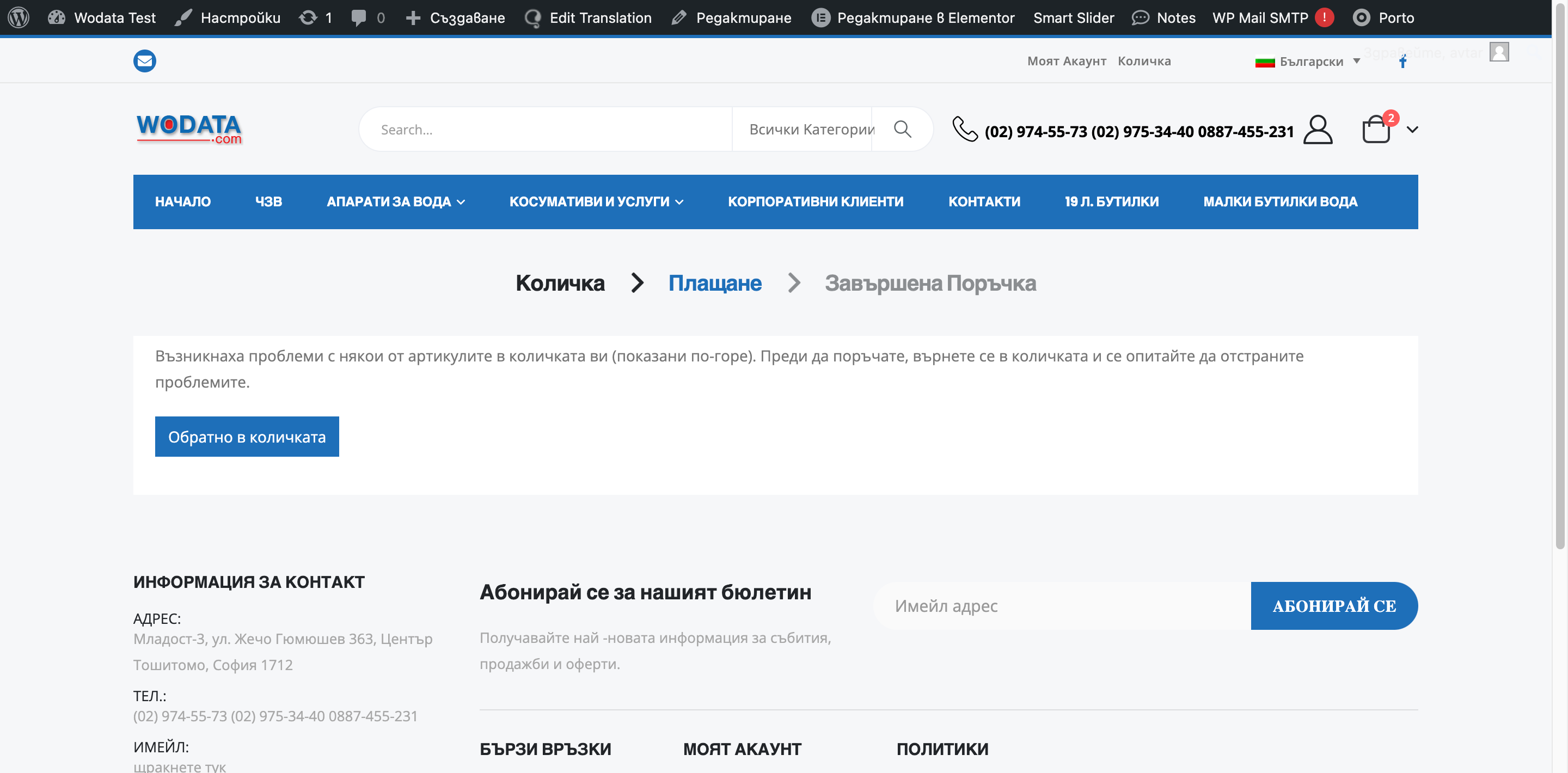

There are some strings that are wrong translated, like text is in English version in the bulgarian language of website. Some of the text is in Bulgarian laguage while checking English version. Please check the attached screenshots. You can reproduce this on the checkout page and by clicking on Calculate button in the right sidebar.
December 8, 2023 at 1:08 pm #15025863

With regard to that text available in the screenshot, let's say you wanted to customize the original text, where you'd go to change the English text?
That will help us understand how to translate it.
Thank you, please let us know.

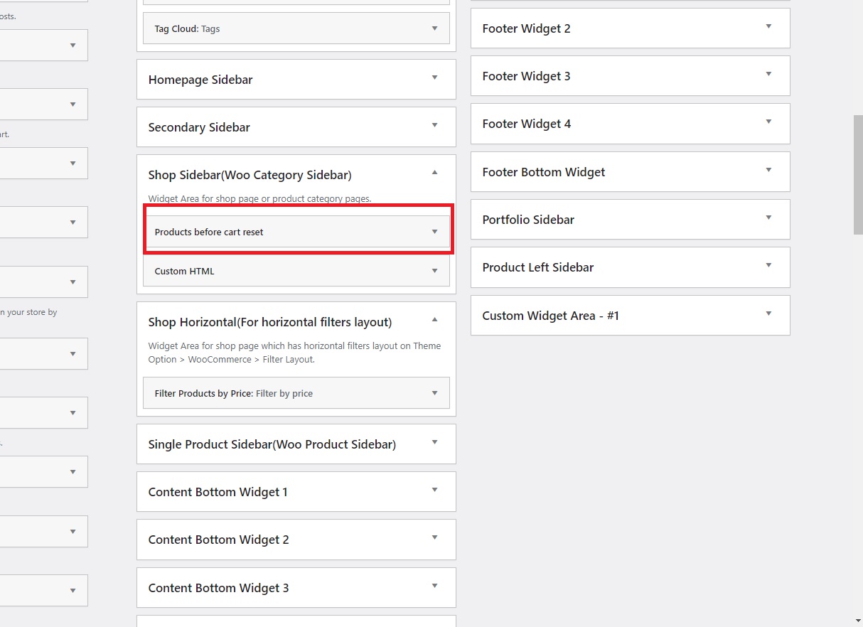

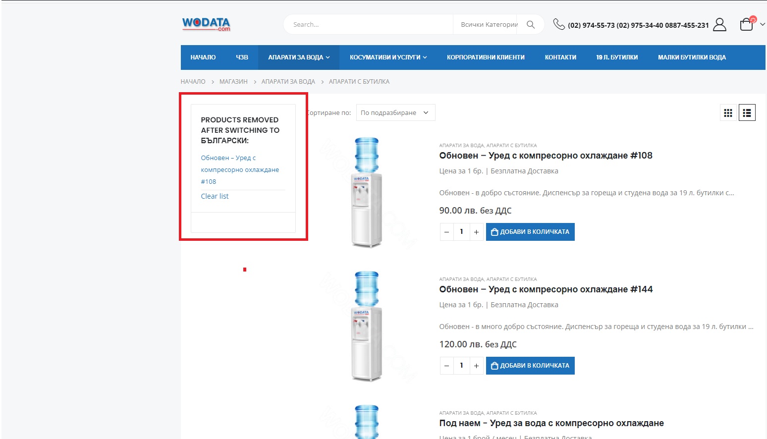

I checked it and added the widget to the sidebar by going to Appearances -> Widgets. Then I dragged and dropped 'Products before cart reset' to the side bar.
Now when we switch languages having products to cart and they're removed, we can see a list of the removed products in the sidebar.
Please check the screenshots I'm sharing to demonstrate it.
