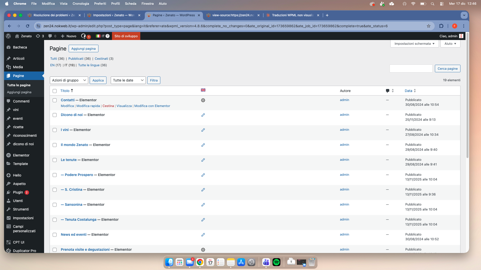

I'm experiencing a critical issue with WPML and Elementor where my translated pages are displaying the original Italian content instead of the English translations, despite having completed all translations at 100% in the Advanced Translation Editor.
Setup Details:
WordPress Version: 6.9
WPML Version: 4.8.6
Elementor Version: 3.33.4
Elementor Pro Version: 3.33.2
Theme: Hello Elementor 3.4.5
The Problem:

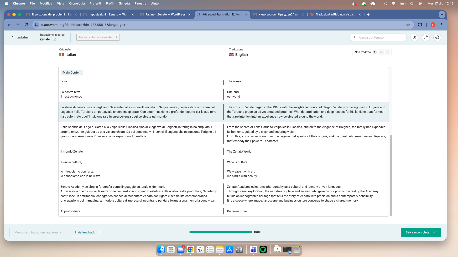

I have translated all pages using WPML Advanced Translation Editor
All translations show as 100% complete in the translation dashboard
The Italian and English pages have different post IDs (confirming they are separate pages)
The pages are correctly linked in WPML (I can see the connection between IT and EN versions)
However, when I visit the English URL (/en/), it displays all the Italian content
What I've Already Tried:
Cleared all WPML caches via WPML → Support → Troubleshooting:
Regenerated Elementor CSS and data via Elementor → Tools
Cleared all server and browser caches
Verified WPML Settings → Post Types Translation:
Pages are set to "Translatable - use translation if available or fallback to default language"
Changed from "Translatable - show only translated items" to the above setting
Re-saved the translation in Advanced Translation Editor using "Save and Complete"
Checked that pages are properly connected in the translation dashboard
Verified in Settings → Reading that different pages are set as homepage for IT and EN
Current Configuration:
Post Types Translation for Pages: "Traducibile - usa la traduzione se disponibile o passa alla lingua predefinita"
Translation Editor: Advanced Translation Editor
Language URL format: Different languages in directories (domain.com/en/)
Additional Information:
The English page exists in the database with a different ID than the Italian page
When I view the page source on /en/, the HTML shows Italian text inside Elementor widgets
Other translated pages (custom post types like "vini") work correctly
The translation appears complete in WPML's translation editor (100% green bar)

I’ve removed the last section of the page (the loop carousel), and the “stampa” page is no longer causing problems. After that, I was able to translate the page correctly.
However, the translation is still not working on the frontend!!
