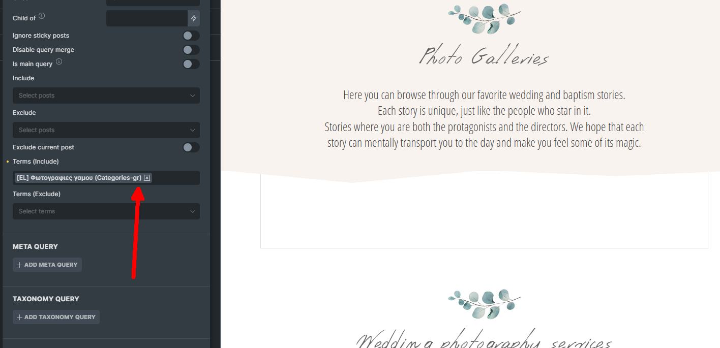

You are experiencing an issue where your translated post is not displaying in English on a specific page, despite working correctly on other pages.
First, verify if the issue is related to the Terms by checking the page with the following URL parameter: https://www.photographic.gr/en/galleries/?bricks=run. This will help determine if the Greek category is incorrectly set to show in English.
Next, ensure that the problematic page is not set as the Posts page. You can unset it by navigating to https://www.photographic.gr/wp-admin/options-reading.php and adjusting the settings accordingly. This adjustment might resolve the display issue of the translated posts.

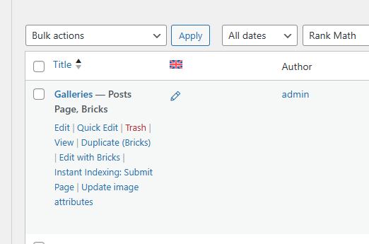

May 16, 2025 at 8:57 am #17040336
Bruno Kos
Can you check on hidden link if this is about the Terms? Looks like that Greek category is set to show in English.
Another thing I noticed, looks like this page is set to be Posts page. What if you unset it on hidden link and check then, does it show these posts?
May 16, 2025 at 1:52 pm #17042243
dimitrisM-3
I just remove it from to be the post page and now it works fine. Thanks!!!
