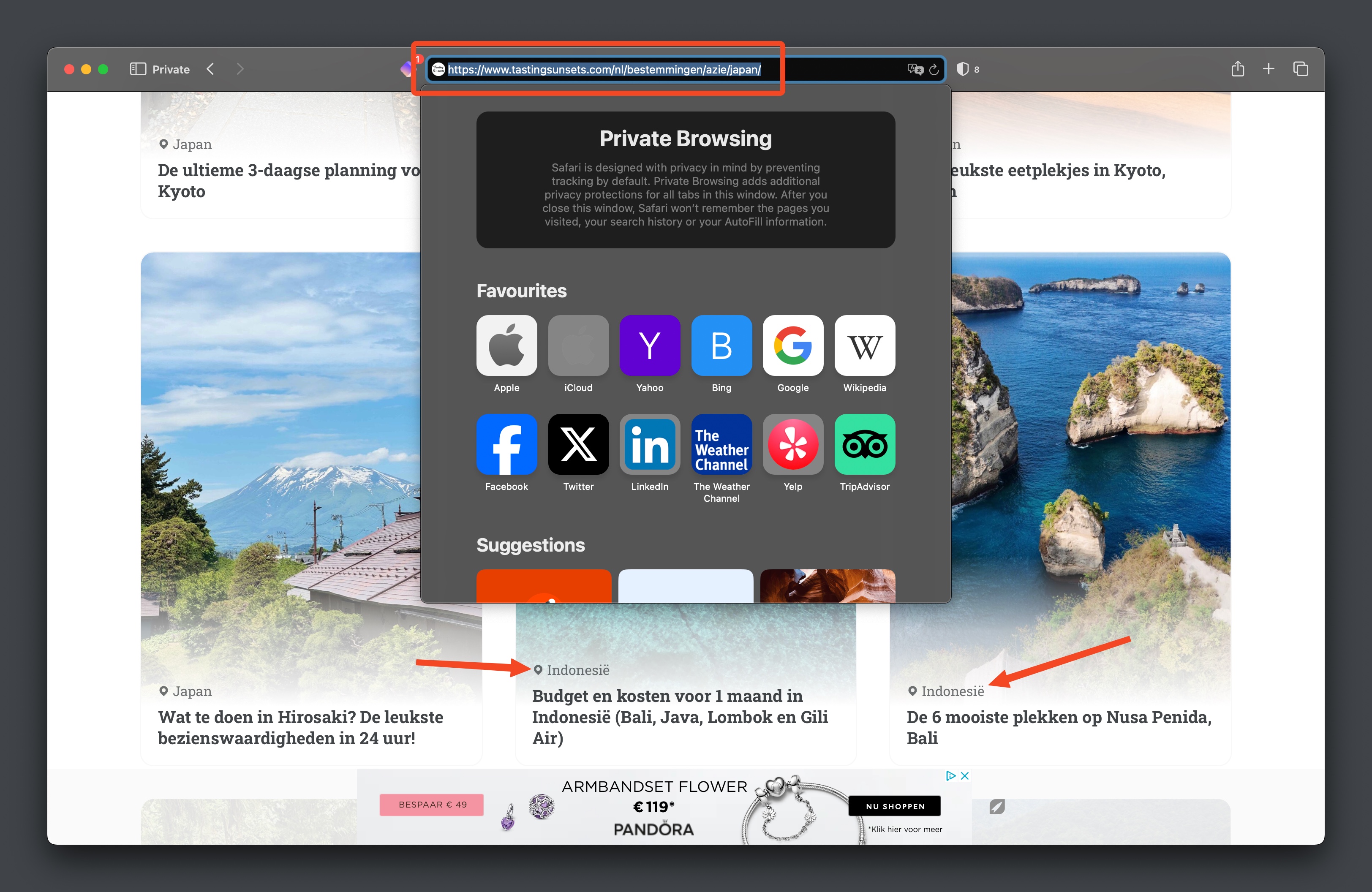

I am trying to make the Dutch archive for our 'destinations' taxonomy (for example /nl/bestemmingen/azie/japan/) continue to load only the Dutch 'Japan' posts, and never pull in posts from other terms after the first load. The issue can be seen at hidden link. This also happens on /nl/bestemmingen/azie/thailand/.
After loading the first 10 posts correctly, the next batch is a random mix of posts from other 'destinations' (Bali, Mexico, Australia, etc.).
Why are posts from other 'destinations' appearing after the first load?
How can I ensure only Dutch posts from that archive are loaded in the archive?

I've setup a minimal version of the website, and the same issue can be found here:
or
I sometimes see English posts in between Dutch posts (something I don't experience on our site), even though posts are set to non-translatable. When trying to reproduce the issue, I noticed that without using the string translator to translate the custom taxonomy, the issue didn't appear. Only after I translated "Destination", "Destinations" and the slug (to Bestemming, "Bestemmingen" and bestemming) the infinite load issue happens. Thought I'd let you know!
