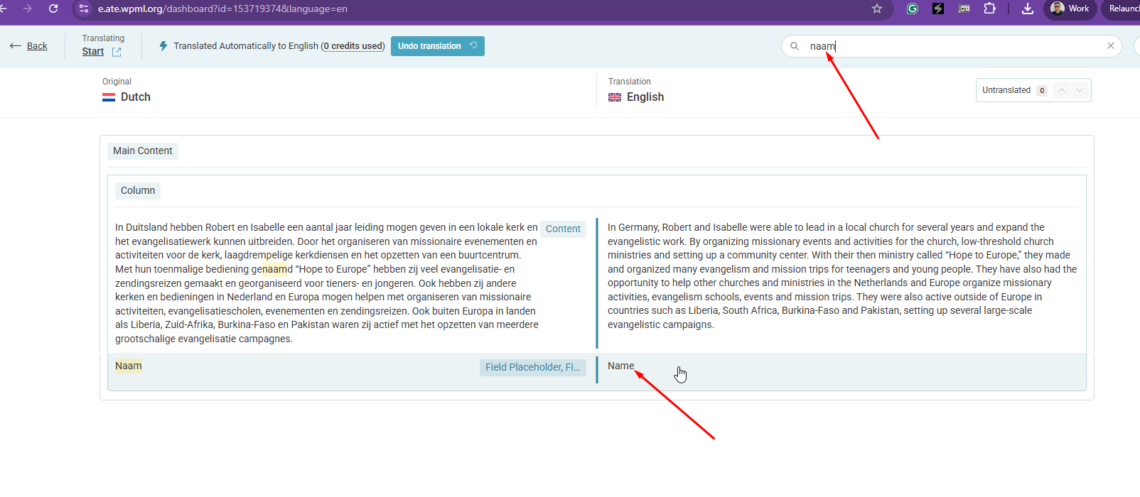

Thanks for contacting us. I've checked your previous ticket here https://wpml.org/forums/topic/translating-the-divi-engine-form-builder/ and you did not respond to us ,and the ticket is closed.
July 31, 2025 at 4:56 pm #17286007
Thanks for your reply. I've added the custom XML configuration for you below here hidden link and could you try translating now? Then, try to search for the strings as shown in this screenshot.

July 31, 2025 at 5:18 pm #17286148
andreS-54
Thankyou. That helped.
I just used the translation management now and it worked after you added the XML.

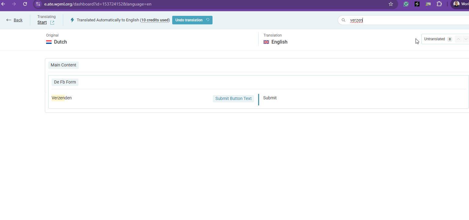

Only the submit button is missing.
Could you please add it?
July 31, 2025 at 5:56 pm #17286237
I'd added the code below for you. Now it works fine.

July 31, 2025 at 7:21 pm #17286548
andreS-54
Thankyou. Now it is perfect.
