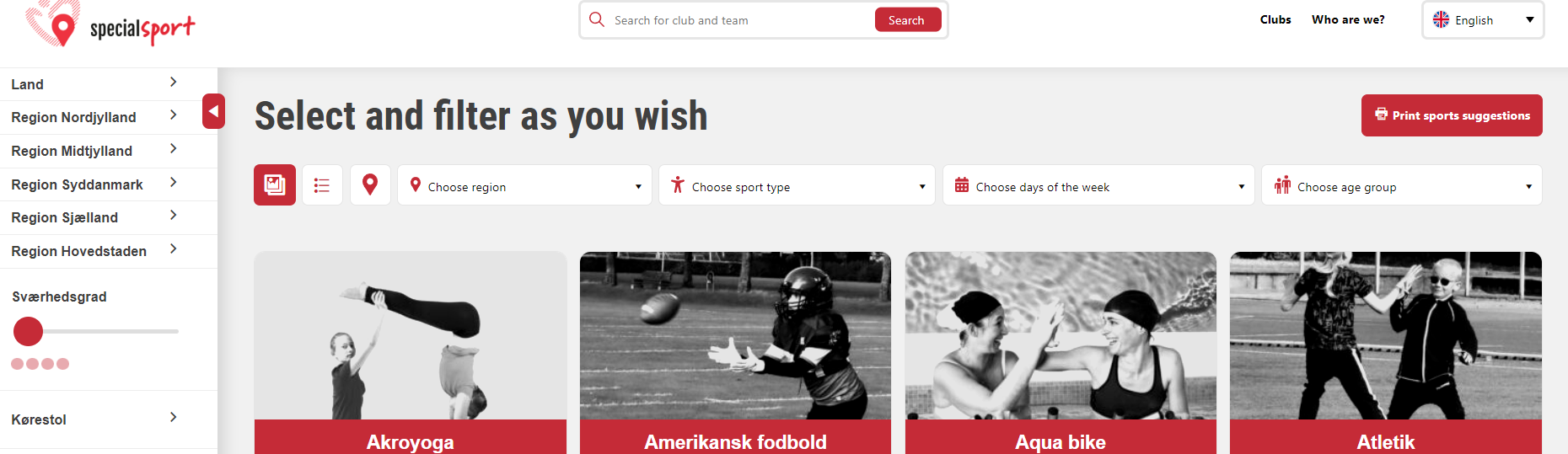

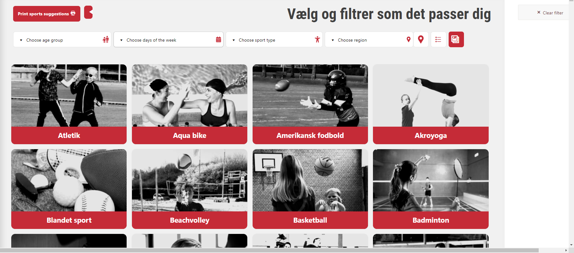

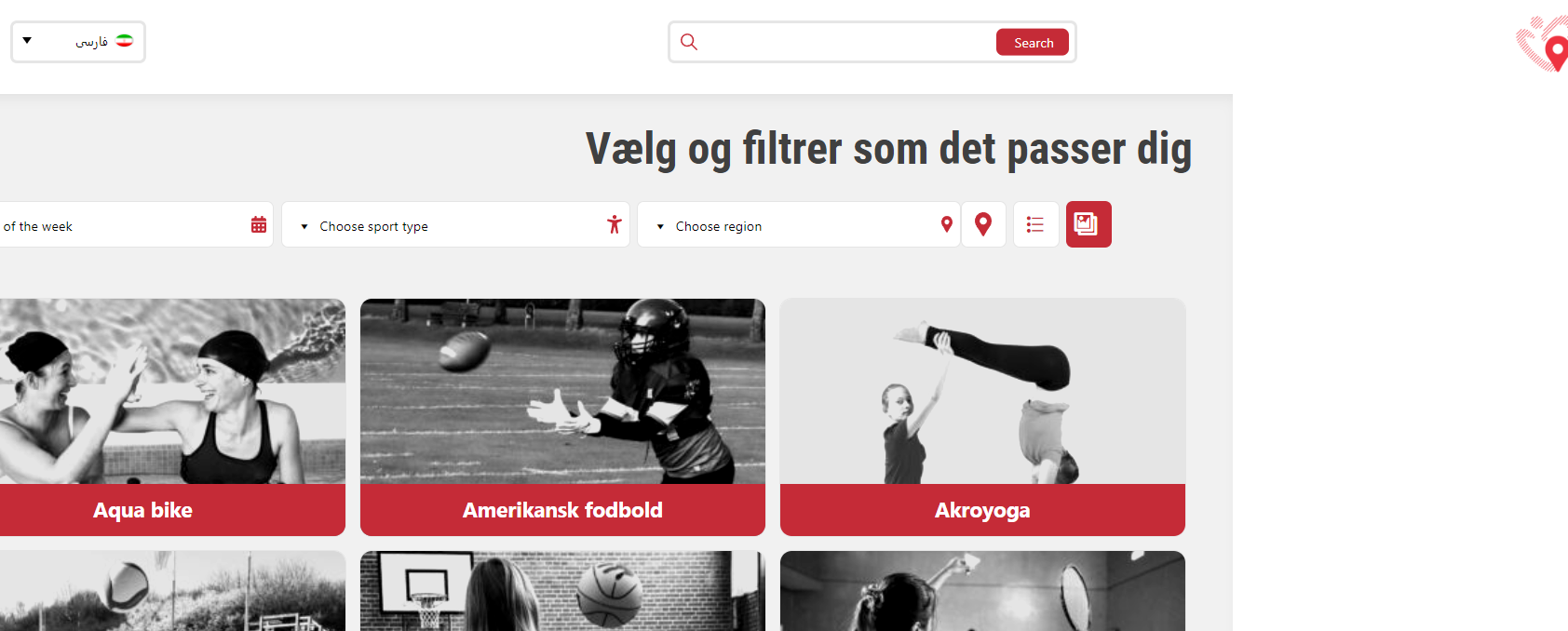

I am trying to translate the website to Persian and Arabic, but the alignment and reading direction of those languages messes with the alignment and skews the entire site.
I have attached three pictures.
What the layout is supposed to look like (ignore the mix of Danish and English, that's a different issue)
And what happens when i duplicate this website to Persian.

I have thoroughly checked and found that the issue is happening due to not defining the CSS code properly for the RTL version in the Theme. Upon adjusting them from the browser console, everything started to show properly. Please check this video for a better understanding: hidden link
Since the CSS needs to be adjusted for the RTL version within the theme, It is recommended to reach out to the theme author or support and consult with them regarding this matter.
