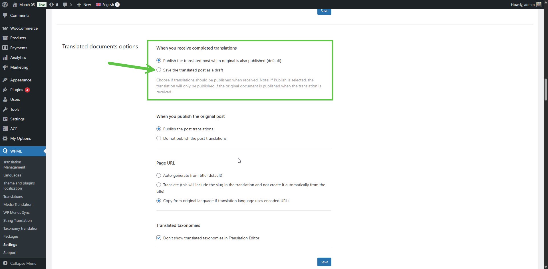

In this case, you need to go to WPML > Translated documents options and change it to "Save the translation post as draft". This way, you can review the translation before they get published. Check the image attached.

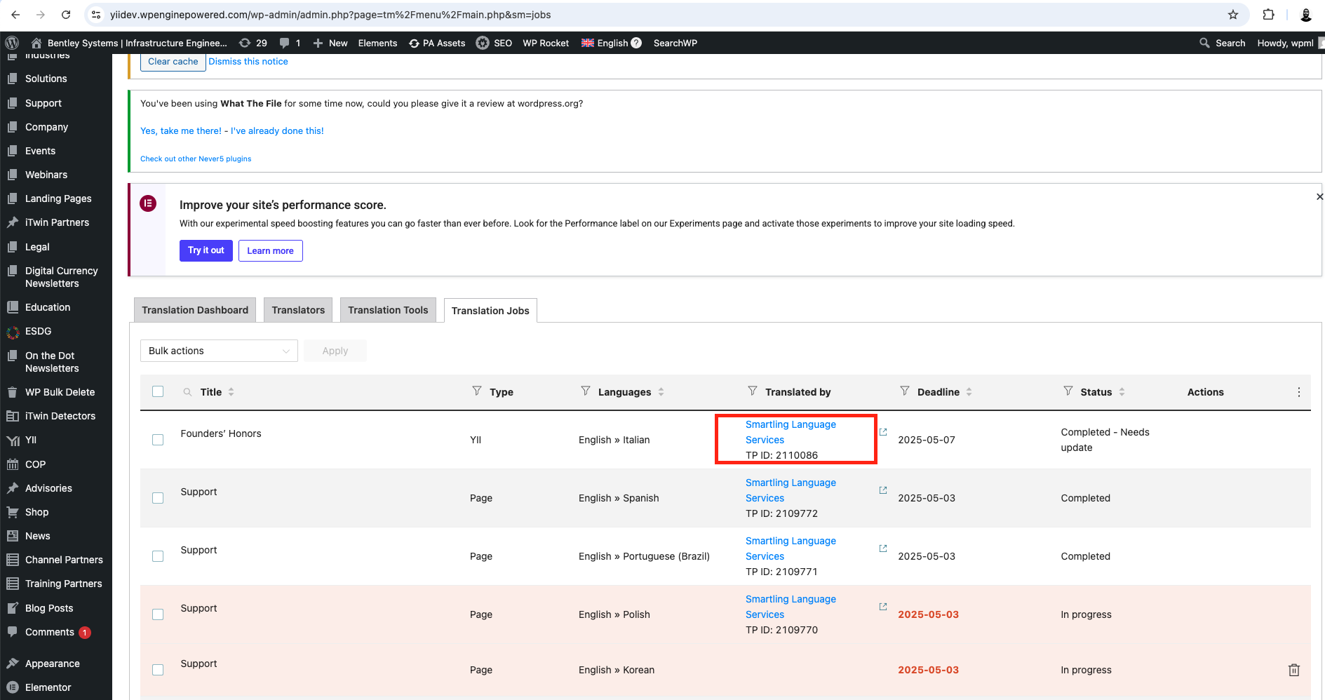

When I checked the jobs tab, I found that you translated the old jobs using
"Smartling Language Services" and those jobs are completed, and some of them are still in-progress, as shown in the attached screenshot.

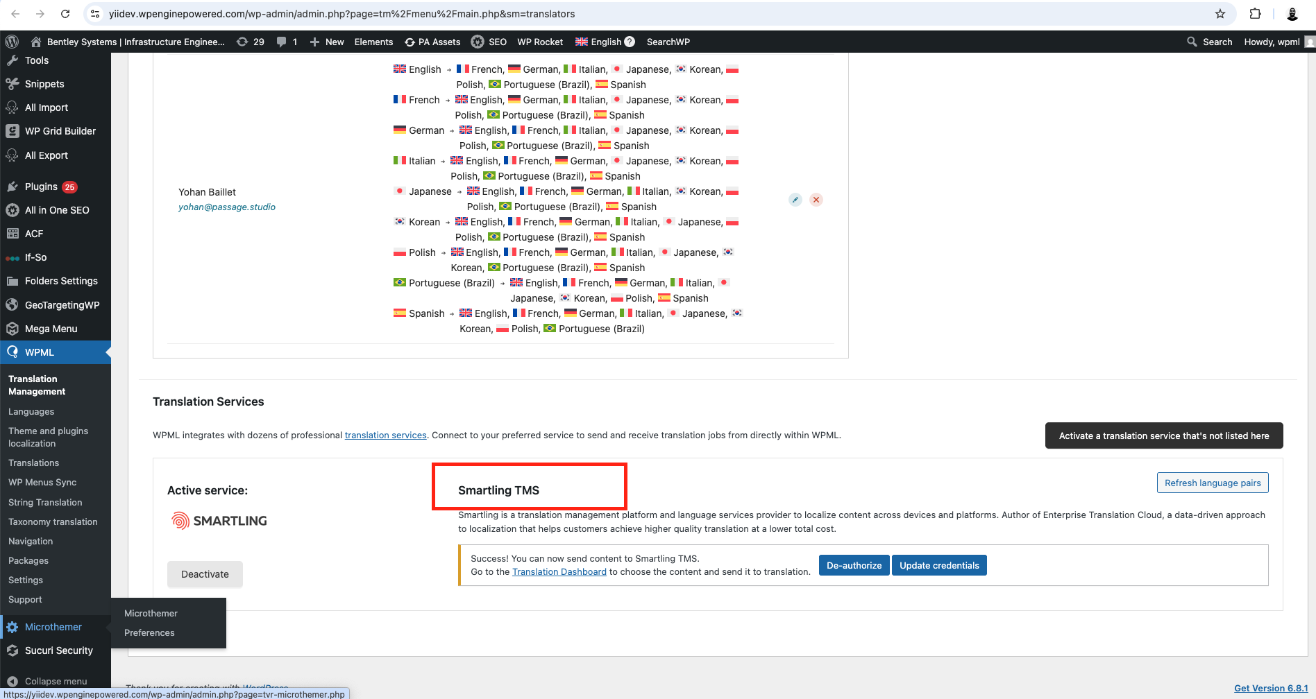

Right now, you have authenticated another translation service called "Smartling TMS", and this is a different service as shown in the translator tab, as shown in the attached screenshot.
So, this caused the following behavior:
1- All the old in-progress jobs will not be retrieved because it is not connected to the current translation service.
2- You can't send new jobs because the new translation service you authenticated doesn't support ISO code "en" for English language (and you can see this error in the logs you shared).
This can be avoided by doing a language mapping from our end and this will allow you to send jobs properly.
So, if you want to proceed with "Smartling TMS", let me know to add the needed mapping to allow you to send jobs.
