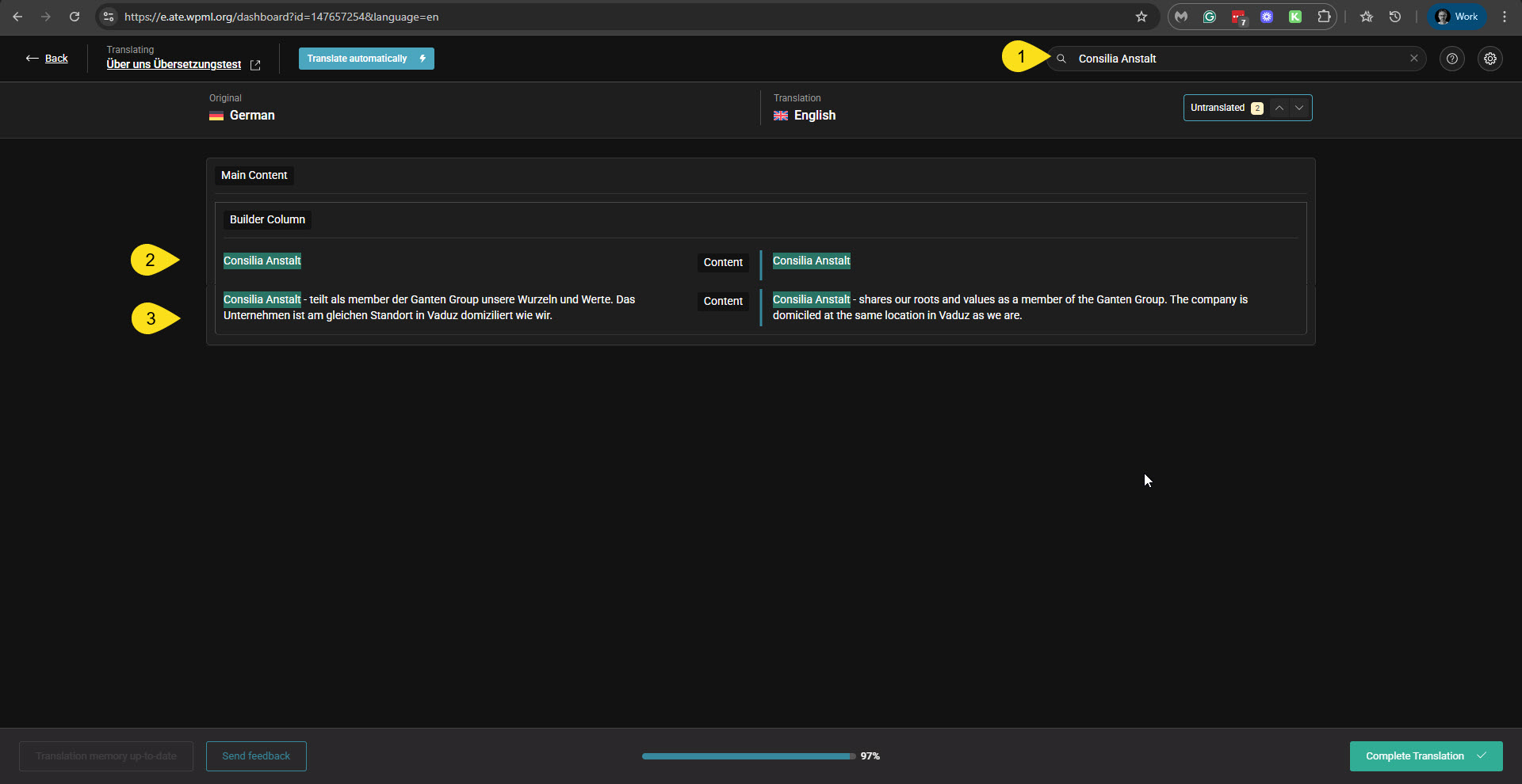

Our second-tier supporter has fixed this issue. It is not possible to edit the translation of the section that was missing in the Advanced Translation Editor. Please see the attached screenshot. Our second-tier supporter explained how he solved it: "I made a small change to the provided page, added a textblock, and removed it. Now I can see the text."

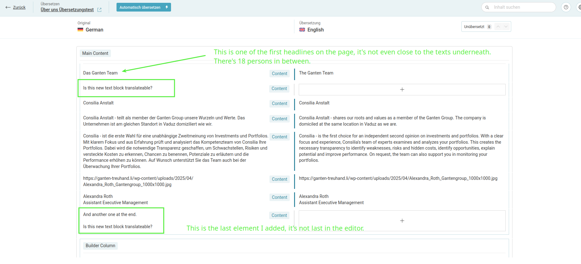

I just noticed something else. I added two textblocks. They are translatable, but they appear in a completely wrong order.
Is it possible that the problem isn't missing elements, but a wrong order of all elements?

I apologize if I was not clear enough in my previous reply when I shared the screenshot. It is not the only content on this page. I searched for "Consilia Anstalt" and therefore received the two places where this text appears. Please see the attached screenshot. Please be aware of the search option in the Advanced Translation Editor.
Regarding the order of the different sections as it appears in the Advanced Translation Editor. Indeed, it will not always be in the order in which it is on the front end. That's normal.
