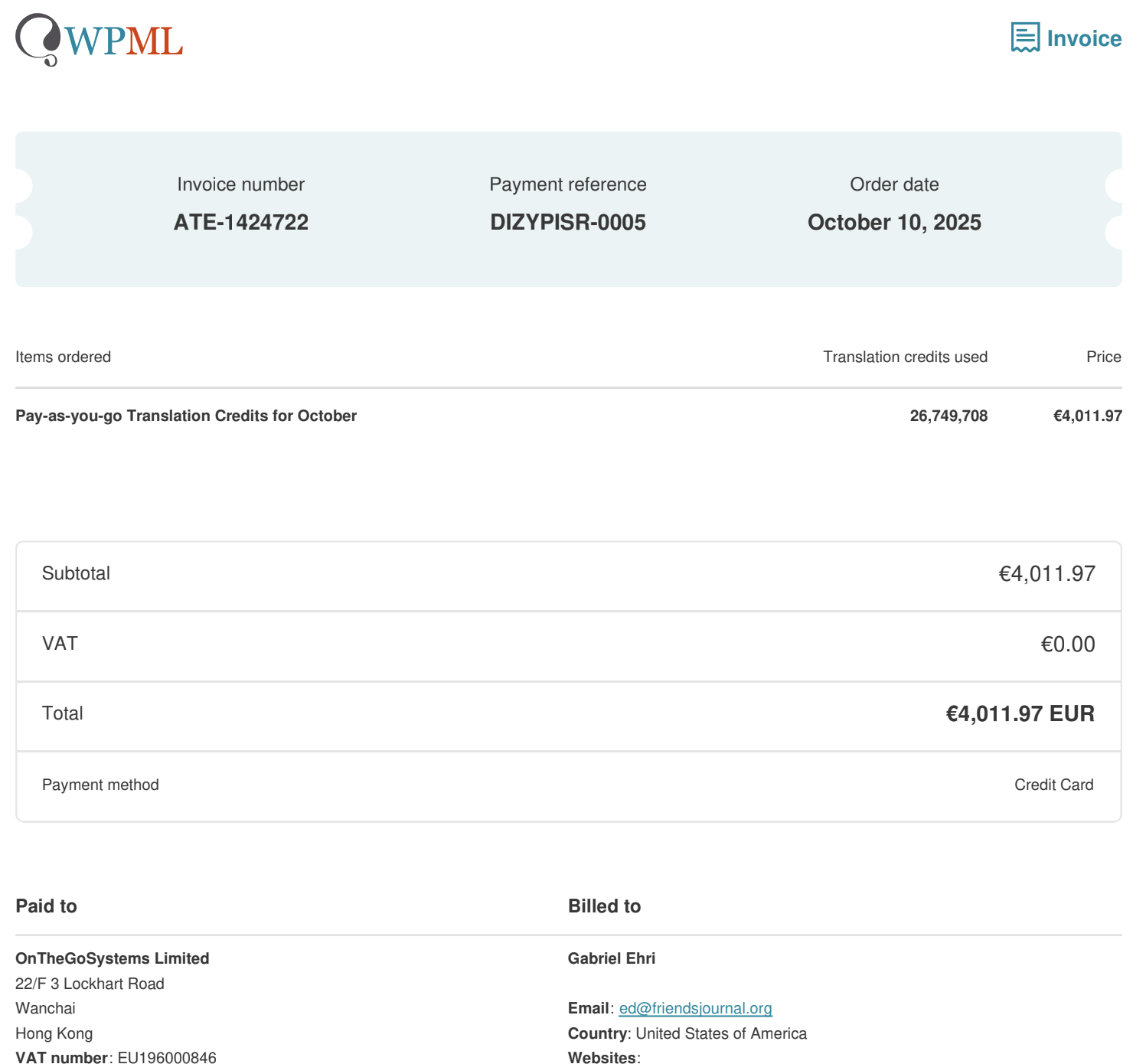

Hello, I'm Pieter's client. The site we were seeing the "not enough credits" error for was using Pay As You Go so I could not assign it any Prepaid Credits. So here's what I did:
Turned off Pay As You Go
Assigned 20,000 credits from the inactive sites to the problem site
Turned Pay As You Go back on
When I did this, I received an invoice for October and it seems as though my Pay As You Go counter has restarted. Please adjust my pay-as-you-go bill to reflect the maximum possible volume discount, since I had met that threshold already this month.

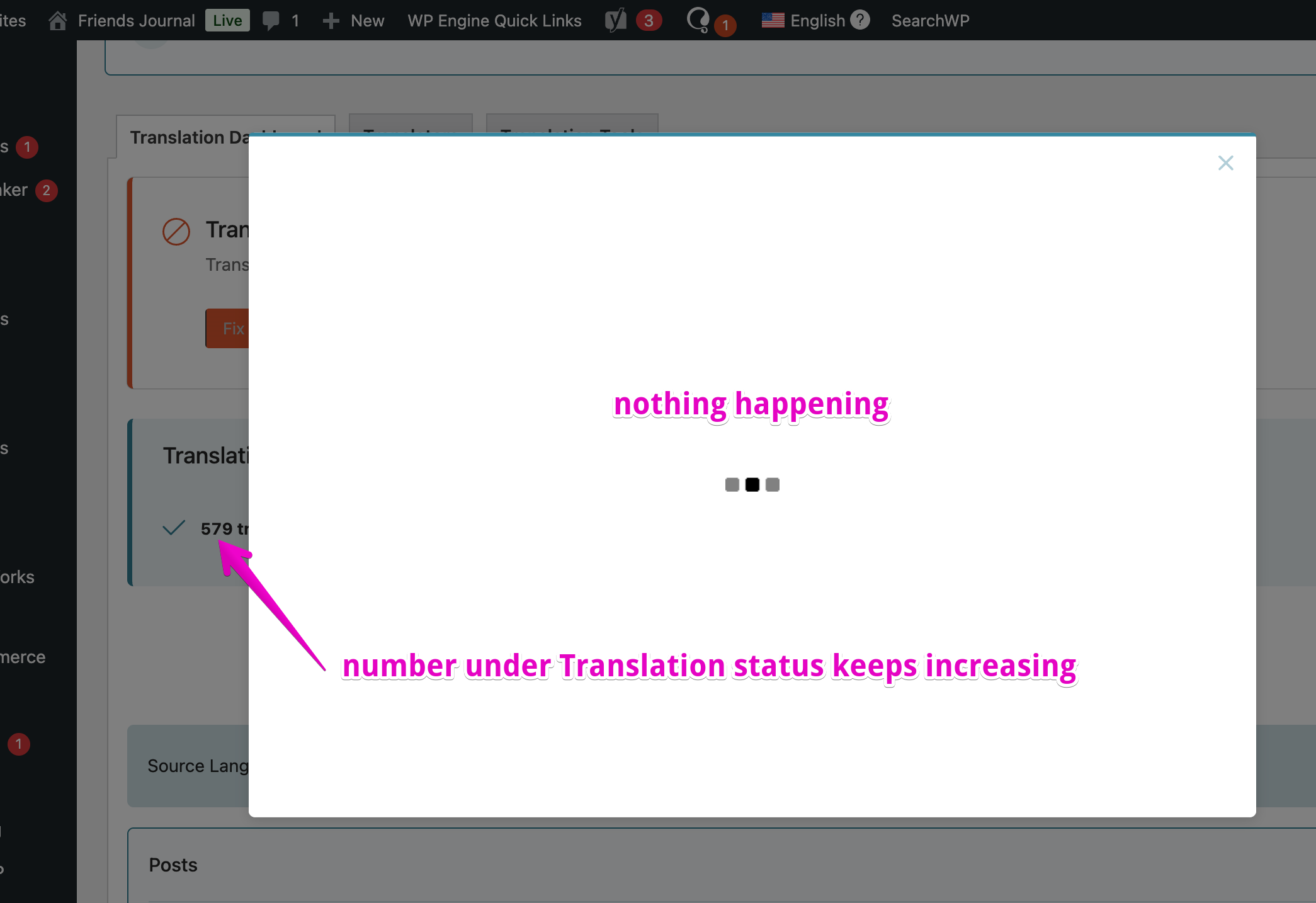

Translations have been running through the night, but the counter of what still needs translating keeps going up instead of down.
And just now the system has run into an error, screenshot attached.
The strange thing is that translations still seem to be continuing as the number under Translation Status now continues to increase...
To say that this system is non-transparent is a huge understatement!
Naturally I have clicked the "Fix now" button, which results in an overlay where absolutely nothing is happening, except the number under Translation Status still continues to increase...
