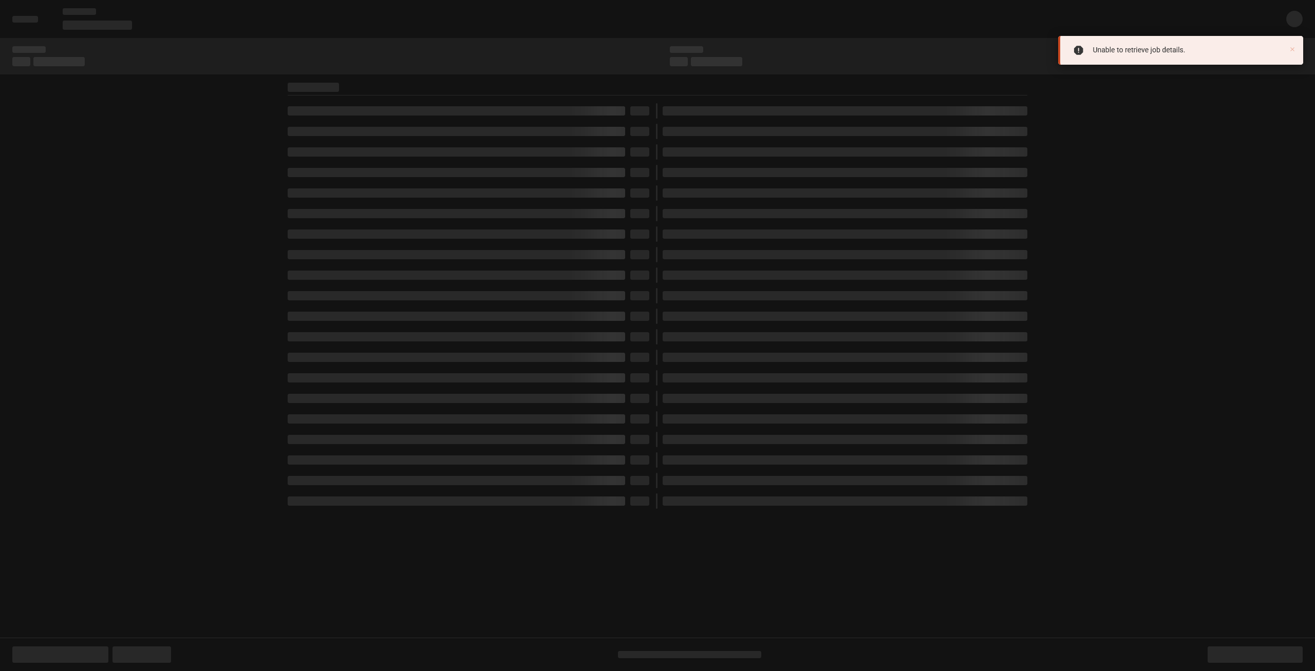

Hi i have familar problem on another website, like before task here: ( i tried apply same solution like before, but do not work)
i have problem with ATE i cannot translate new content from czech to english. Can you help me? I will sent you acces to website.
I would really appreciate your assistance.

I’ve completed additional tests and checks, and it appears that the issue is still the same as before. Output compression is very likely still enabled on your server, and it is affecting the Advanced Translation Editor.
I also verified the database table collations, and they are all correct.
As an additional test, I temporarily switched WPML to use the Classic Translation Editor (WPML → Settings) and checked the translation again. The behavior remains the same: the server is returning binary/compressed data instead of plain text. I’ve attached screenshots for your reference.
Unfortunately, this cannot be fixed on the WPML side. A change to your server configuration is required, followed by a server restart.
https://wpml.org/errata/translation-jobs-not-synchronised-when-gzip-compression-is-enabled/
I would recommend contacting your hosting company for help with adjusting the server settings.
