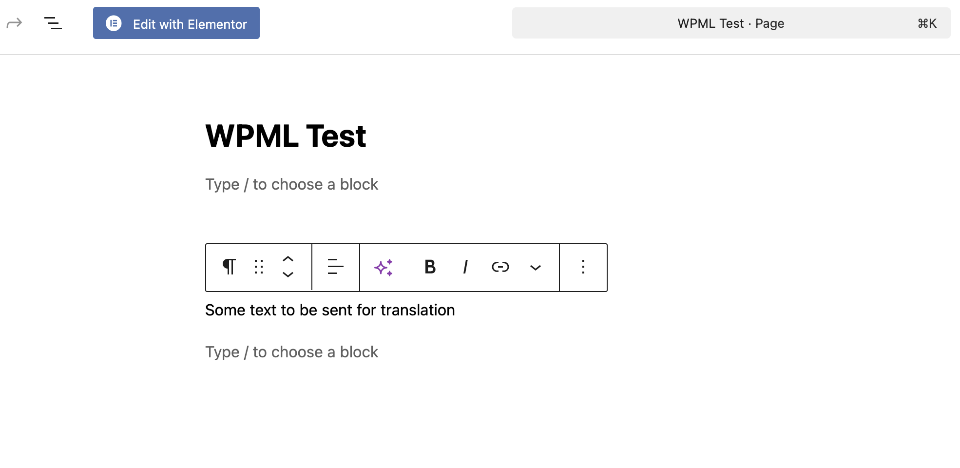

I also verified the following on your server:
- Database charset and collation are correct
- All required PHP extensions are installed
- No plugin or theme conflicts are involved
To further investigate, I temporarily switched WPML to use the Classic Translation Editor and rechecked the test page. At that point, the editor displayed the following values:
Title: x???QI-.�?
Body: x???MU(I?(Q(?WHJU(N?+QH?/R()J?+?I,???�?4t
(See attached screenshots.)
This clearly shows that the server is returning binary / compressed data instead of plain UTF-8 text. As a result, WPML cannot extract readable strings, which explains:
- the empty <body/> in the XLIFF file
- the zero word count
- the “Unable to retrieve job details” error
