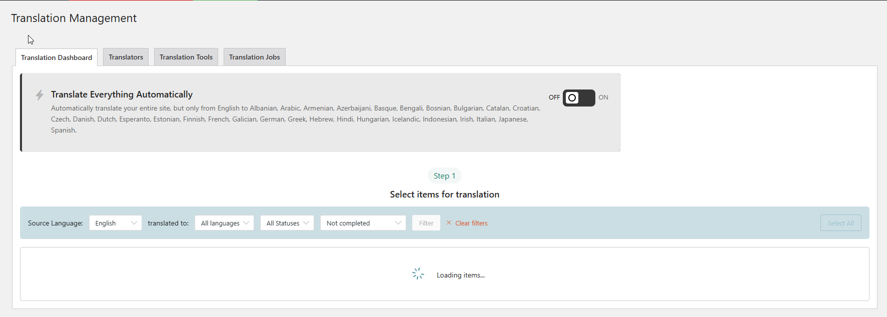

I am trying to open WPML → Translation Management on my staging site (staging.internationaltravelpermits.com) to view and send content for translation after adding more than 30 languages. The issue can be seen at hidden link.
The Translation Management dashboard fails to load once I enable a 30th language, resulting in a WordPress database error: Table 'wp_itp_dev.gkg3R9t_icl_translations' doesn't exist for query SELECT gkg3R9t_posts.* … JOIN gkg3R9t_icl_translations …. This issue only occurs when I add a 30th language; it works fine up to 29 languages.
Why does the Translation Management dashboard fail to load after adding a 30th language?
How can I resolve the SQL error related to the table prefix when adding more than 30 languages?
