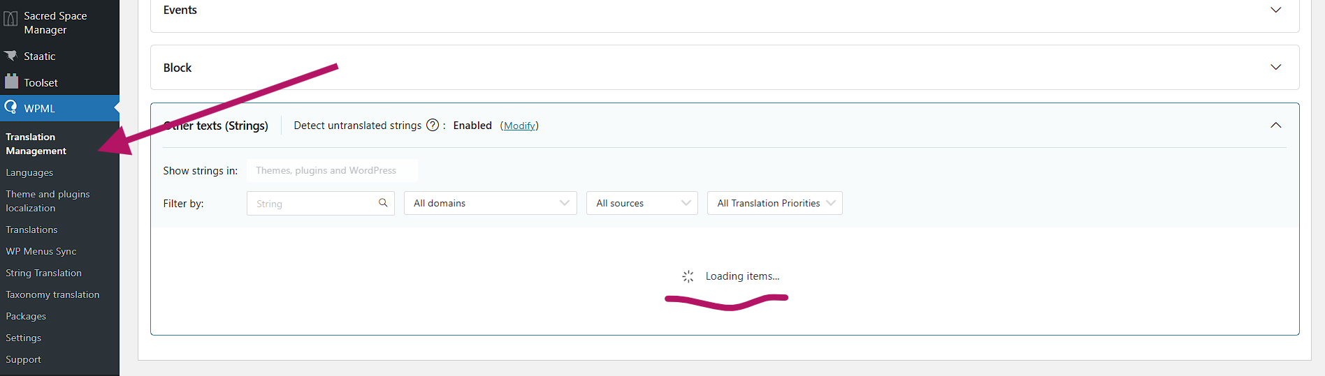

I am trying to load strings in the Translation Management > Other texts (Strings) section after moving our site to new hosting. The section fetches JSON from the endpoint "/wp-json/wpml/st/v1/strings?offset=0&limit=76&sourceLanguageCode=en". The endpoint code is displaying PHP Warnings instead of returning JSON. Here is the code causing the issue:

The Other texts (Strings) section won't load strings and keeps displaying the message "Loading items...". The endpoint is returning PHP Warnings instead of valid JSON. The error being returned is: <code> <br /> <b>Warning</b>: Undefined array key "job_id" in <b>/usr/www/users/stage/***hidden***/public_html/wp-content/plugins/wpml-string-translation/StringTranslation/Infrastructure/Translation/Query/FindTranslationDetailsQuery.php</b> on line <b>73</b><br /> </code>
