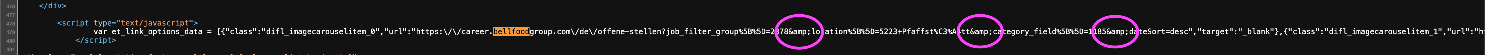

<script type="text/javascript">
				var et_link_options_data = [{"class":"difl_imagecarouselitem_0","url":"https:\/\/career.bellfoodgroup.com\/en\/vacancies?job_filter_group%5B%5D=2378&location%5B%5D=5223+Pfaffst%C3%A4tt&category_field%5B%5D=1185&dateSort=desc","target":"_blank"},{"class":"difl_imagecarouselitem_1","url":"https:\/\/career.bellfoodgroup.com\/en\/vacancies?job_filter_group%5B%5D=2378&location%5B%5D=5223+Pfaffst%C3%A4tt&category_field%5B%5D=2365&dateSort=desc","target":"_blank"}];
			</script>
(see snippet-default image)

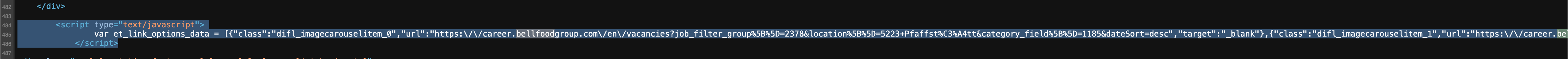

If you search the translated page's source for "bellfood" you'll find the following INCORRECT snippet:
				var et_link_options_data = [{"class":"difl_imagecarouselitem_0","url":"https:\/\/career.bellfoodgroup.com\/de\/offene-stellen?job_filter_group%5B%5D=2378&location%5B%5D=5223+Pfaffst%C3%A4tt&category_field%5B%5D=1185&dateSort=desc","target":"_blank"},{"class":"difl_imagecarouselitem_1","url":"https:\/\/career.bellfoodgroup.com\/de\/offene-stellen?job_filter_group%5B%5D=2378&location%5B%5D=5223+Pfaffst%C3%A4tt&category_field%5B%5D=2365&dateSort=desc","target":"_blank"}];
			</script>
(see snippet-translated image)
As you can see, the & characters have been changed to HTML entities, which does not work in this context.
The result is that the query parameters are not passed correctly to the job portal page of the customer.

Note:
Please refer to the provided images; the code snippets do not show the added characters since the browser unescapes them.

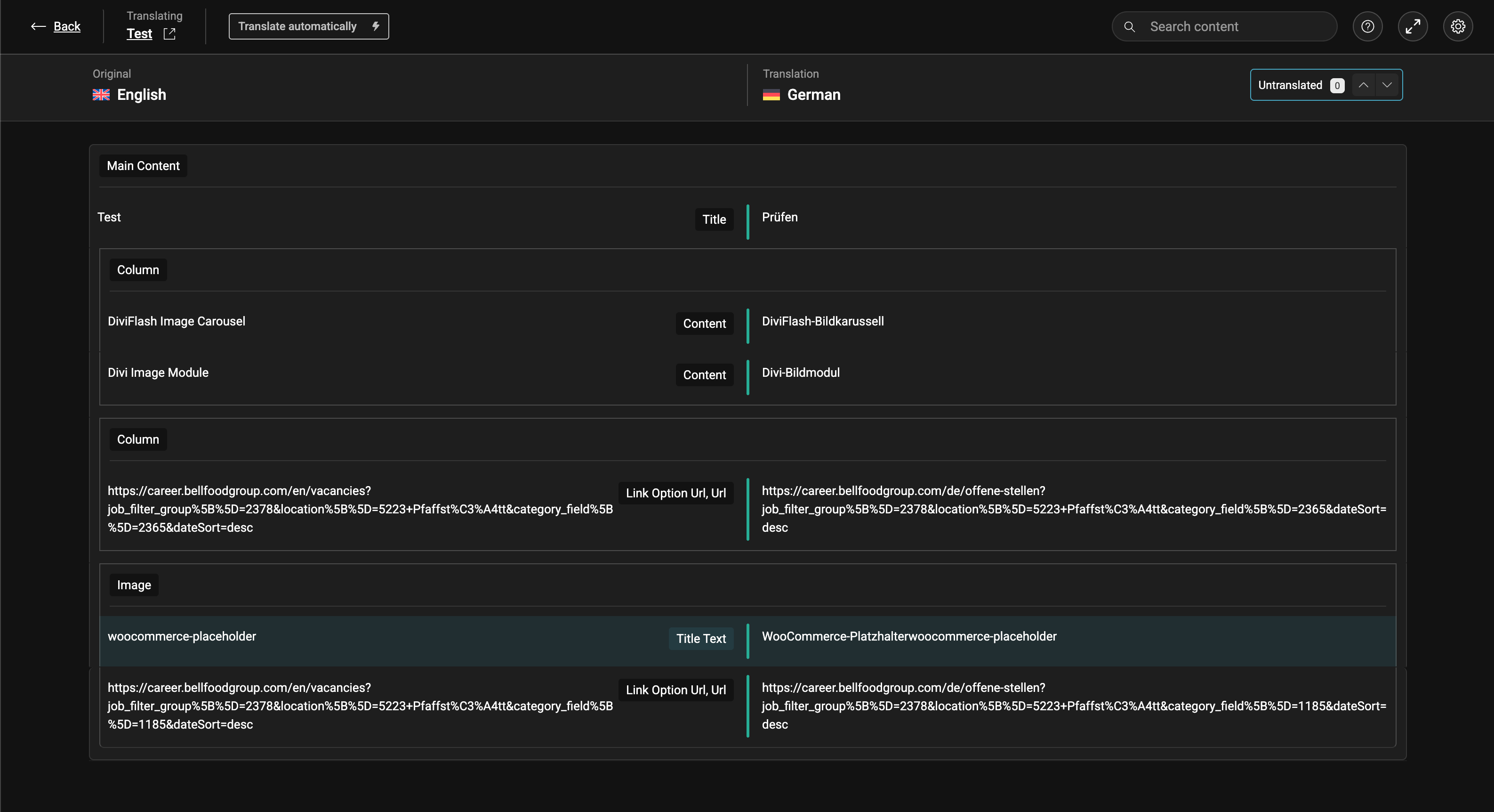

The translation editor content looks fine to me (see screenshot df-test-translation.png)
