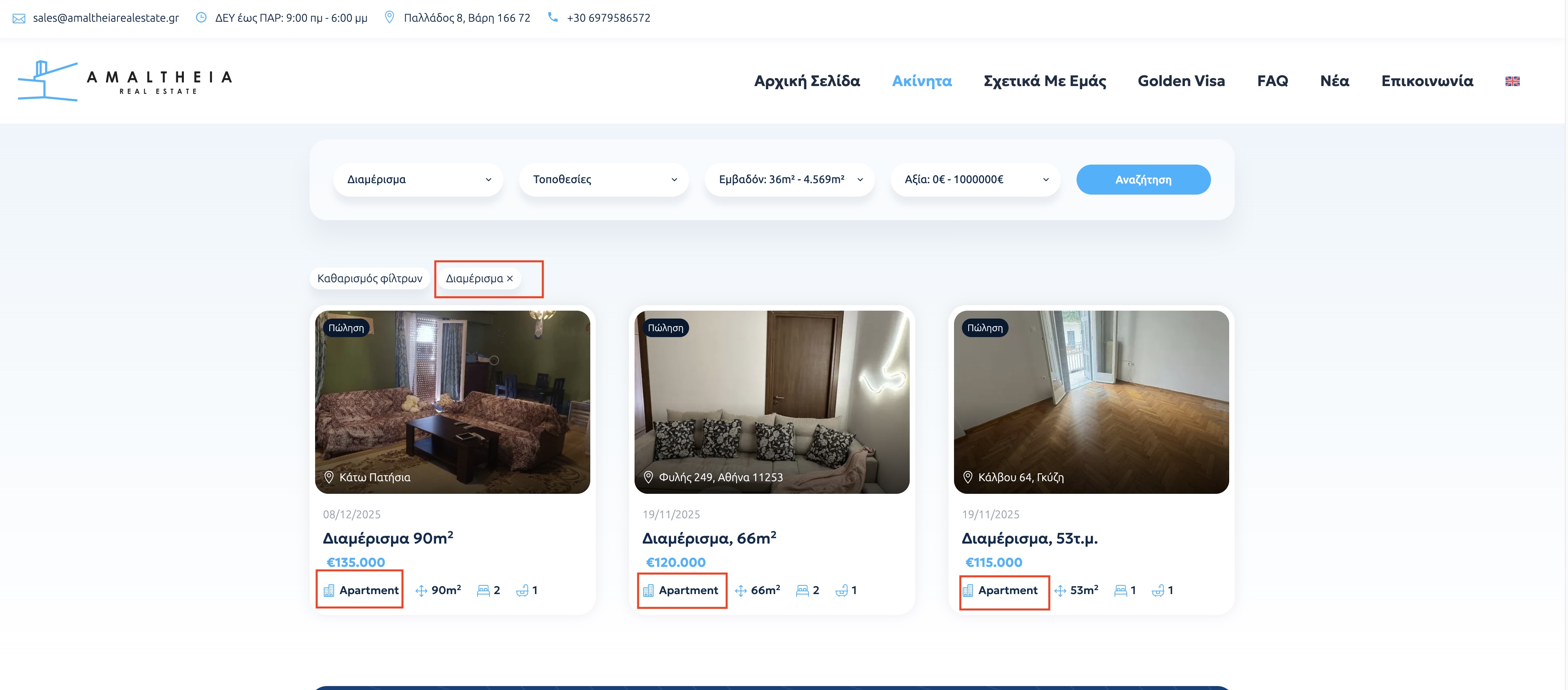

irenek-4
It creates a mess! The property type is copied but it shows mixed content in the archive page. Look at the image attached. The properties that I have resaved are showing the property type in english (not translated), the ones that aren't still saved are showing correctly in the grid (but not showing if i go to the english property sale page, select property type apartment and then click on the greek language)

The values are same so it's displaying it accordingly, I checked the acf fields and can see that you are using choices as follows
Apartment
Detached House
Maisonette
Office
Plot
It says For more control, you may specify both a value and label like this: red : Red
Can you convert the choices as acf suggested and translate the labels from WPML->String Translation once, leave the value fields as it is and see if it works?
https://wpml.org/documentation/related-projects/translate-sites-built-with-acf/#acf-field-choices
Look forward to your reply.

Hello there,
I can see the issue. The Elementor widget provided by your theme does not offer an option to configure the property type as radio buttons; it is currently set up as a Text field (as shown in the attached screenshot). Because of this, the raw value is always displayed on the front end, regardless of any adjustments we make.
You can observe the same behavior even in the default language, where the value appartment is shown instead of the intended label Appartment.
I’m checking whether a workaround is possible from our side, but it would also be a good idea to contact the theme author and confirm whether this widget supports radio fields with labels.
