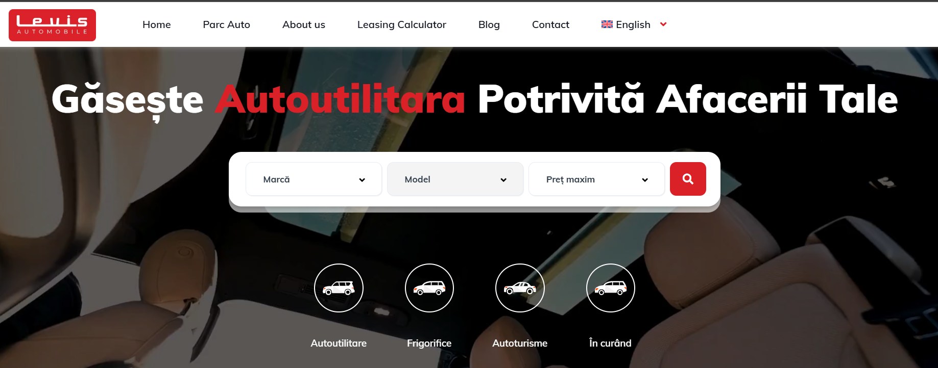

Thank you for the updates. On the staging site (hidden link), I can still see Romanian text instead of the English translation.
Please confirm, did this issue start after the recent changes in the WPML settings? Refer to the attached image for more details.

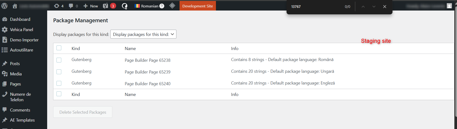

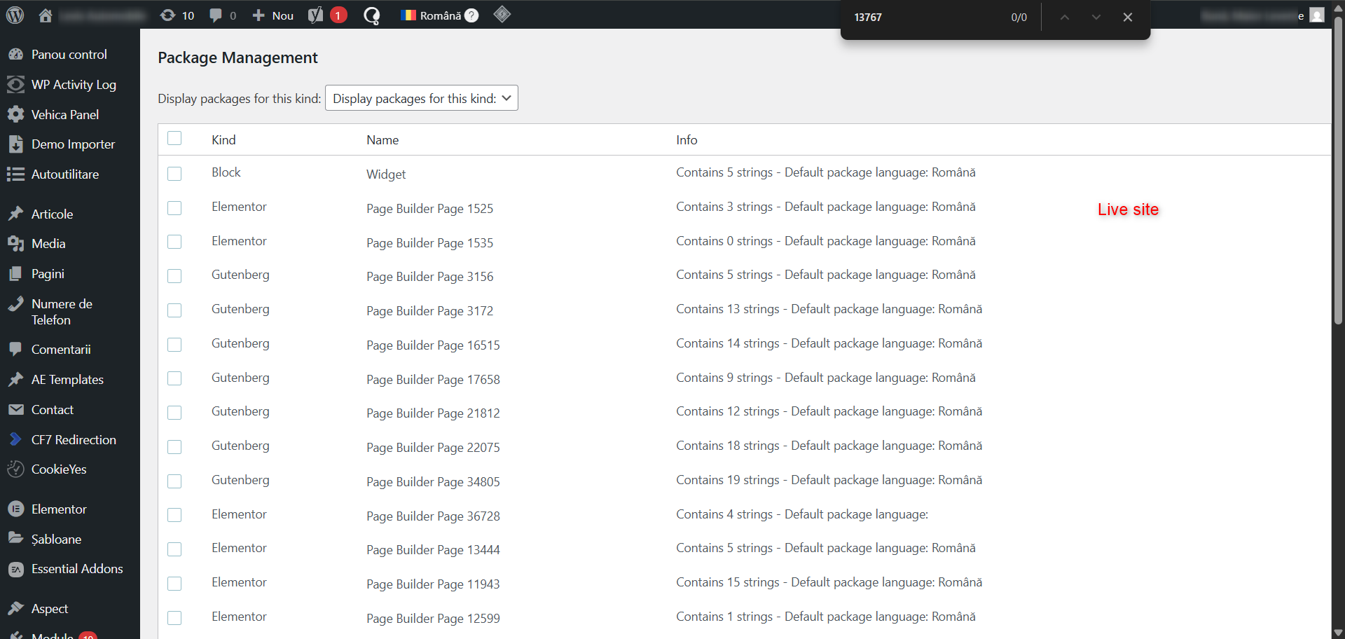

Please confirm if the site was previously translated manually using the WordPress Editor or with the WPML Classic Translation Editor? We noticed that the translation packages (WPML >> Packages) are missing for most pages, including the Homepage, on both the live and staging sites.
Please refer to the attached images for more details, and let us know your feedback.
Thanks!
