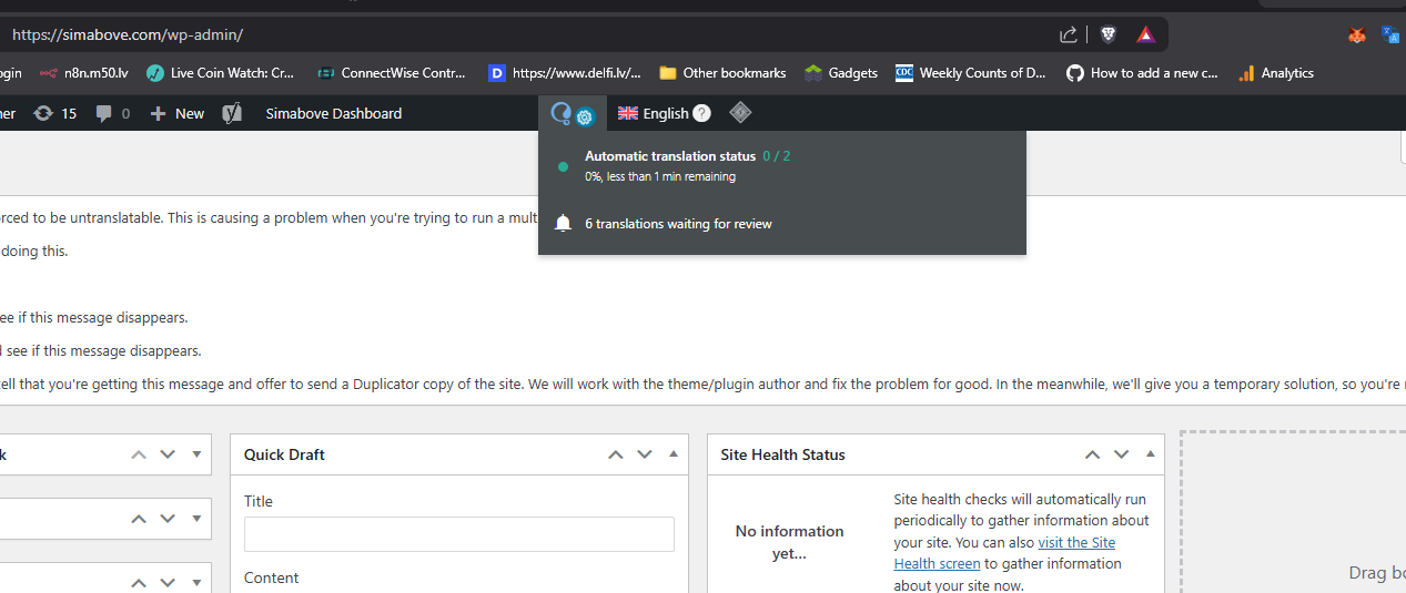

June 4, 2025 at 6:30 am #17104502
elvisL-3
I am trying to manage translations on my site hidden link using WPML.
Translations are stuck.
June 5, 2025 at 7:35 am #17108844

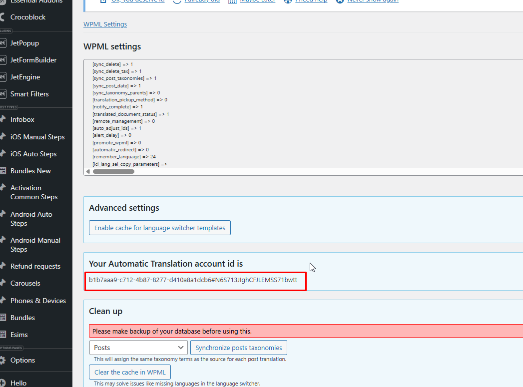

Thanks for your reply. On your production site, could you navigate to WPML > Support > Troubleshooting and share the Automatic Translation account ID with me? I've highlighted it as shown in the attached screenshot from your staging site.
June 6, 2025 at 7:09 am #17112962
elvisL-3
bd1cf8b4-d5d4-4a6e-b871-c67d3012d0ed#QknK5wmQDPxaa0CI4IReFAtt

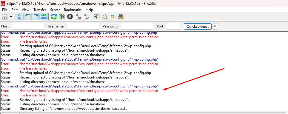

Thanks for your reply. Could you please grant me permission to edit files for the FTP access that you shared with me? I'm getting errors when I try to edit the wp-config.php to enable the WP debugging.
June 9, 2025 at 7:25 am #17117159
elvisL-3
can you try now?
