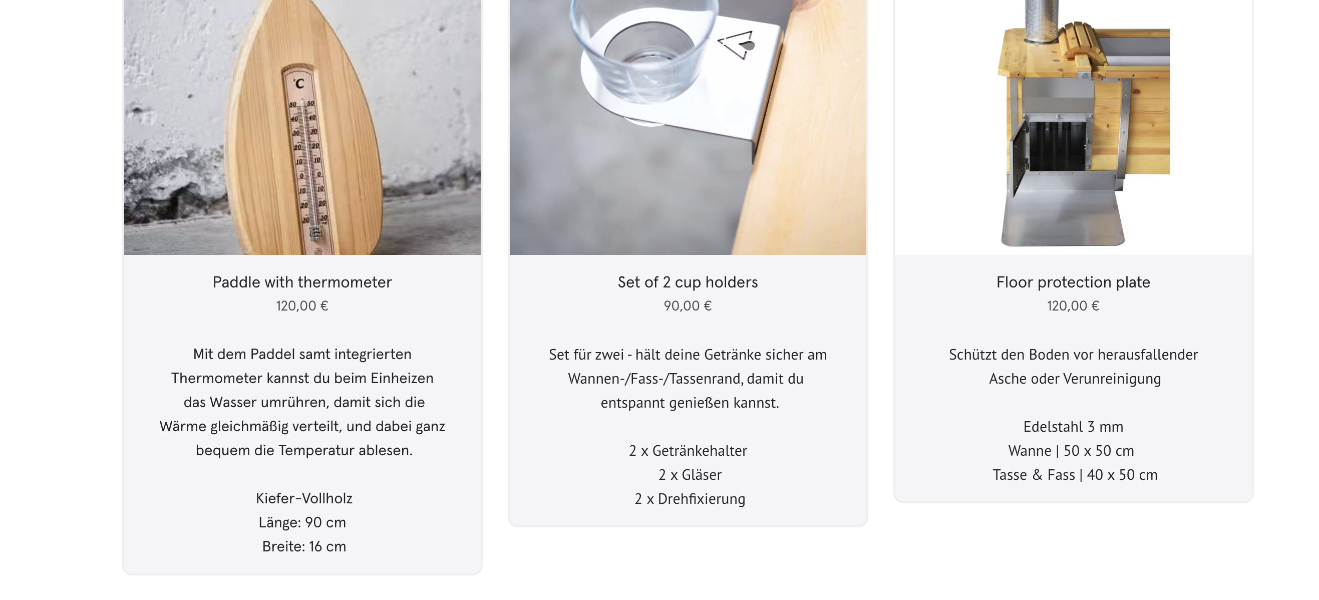

I am trying to translate some ::after elements I added to my website hidden link but I do not find them in the Advanced Translation Editor.
I cannot find the ::after elements in the Advanced Translation Editor for translation.
How can I translate ::after elements using WPML?

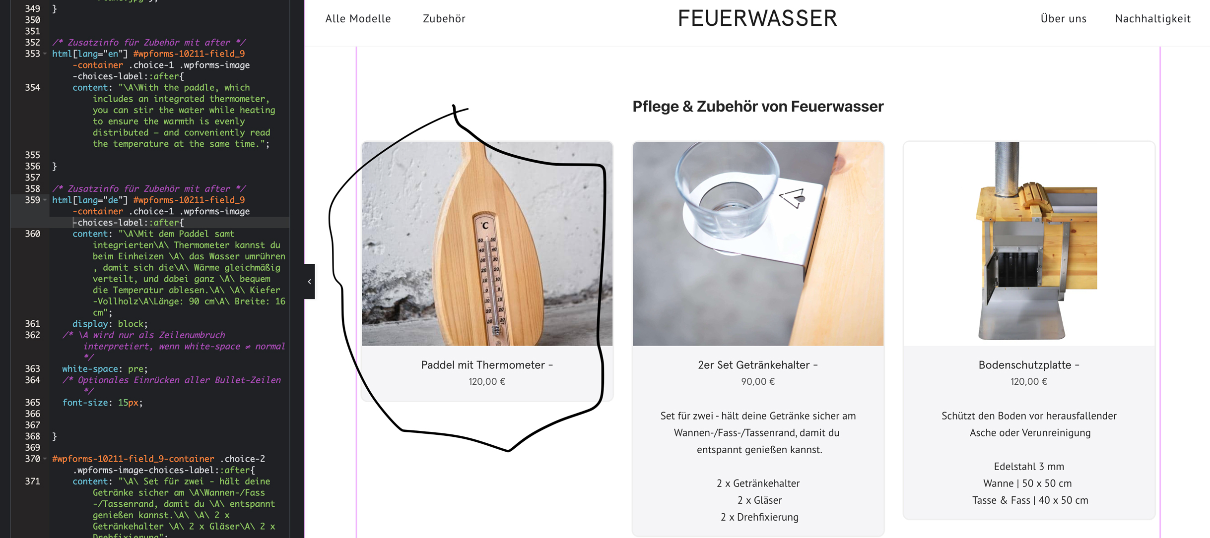

May 23, 2025 at 1:52 pm #17066752
nicolasF-39
Hi I tried it but it does not seem to work. On the german site it does not have "de" in the url because its the original language. Is that a problem?
See the picture attached...
May 25, 2025 at 9:22 am #17069580
Noman
Thank you for contacting WPML Support. No, it should not be a problem, Could you please try to follow the below steps and see if this resolves the issue:
1. Add the below CSS in custom CSS section of the theme:
/* For German language */
html[lang="de-DE"] #wpforms-10211-field_9-container .choice-1 .wpforms-image-choices-label::after {
	content: "DE - \A\Mit dem Paddel samt integrierten\A\ Thermometer kannst du beim Einheizen \A\ das Wasser umrühren, damit sich die\A\ Wärme gleichmäßig verteilt, und dabei ganz \A\ bequem die Temperatur ablesen.\A\ \A\ Kiefer-Vollholz\A\Länge: 90 cm\A\ Breite: 16 cm";
/* For Slovak language */
html[lang="sv-SE"] #wpforms-10211-field_9-container .choice-1 .wpforms-image-choices-label::after {
	content: "SV - Vďaka lopatke a integrovanému teplomeru môžete vodu počas ohrievania miešať, aby sa teplo rovnomerne rozložilo a aby ste mohli ľahko odčítať teplotu. Masívne borovicové drevo Dĺžka: 90 cm Šírka: 16 cm";
/* For English language */
html[lang="en-US"] #wpforms-10211-field_9-container .choice-1 .wpforms-image-choices-label::after {
	content: "EN - \A\With the paddle and integrated\A\ thermometer, you can \A\ stir the water while heating it up so that the\A\ heat is distributed evenly, and you can easily read the temperature.\A\ \A\ Solid pine wood\A\Length: 90 cm\A\ Width: 16 cm";
2. Clear all sorts of site/server/CDN cache and see if it reflects correctly in all languages.
3. I just added the test translation, you should be able to update the translation according to your needs.
