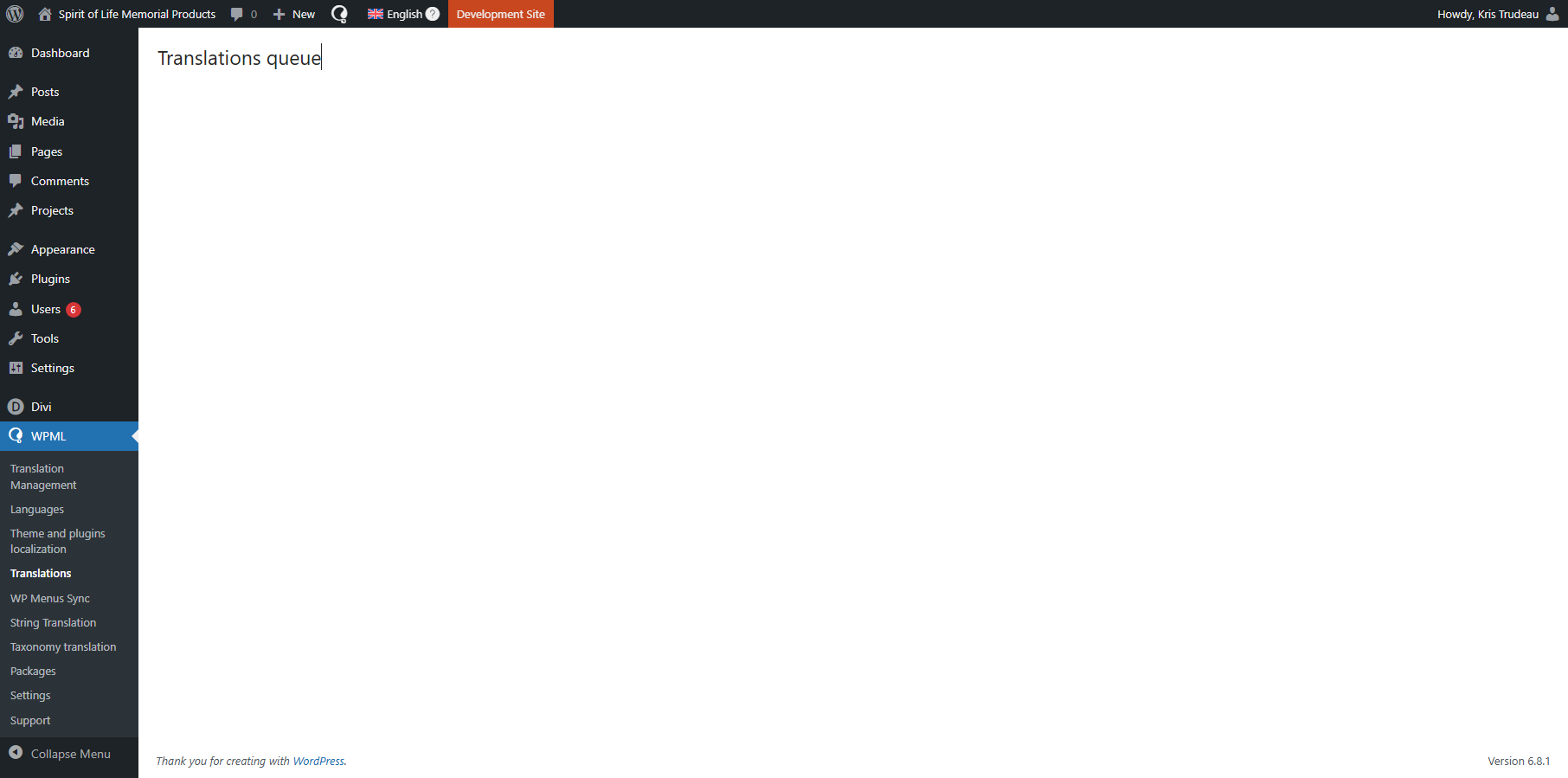

I am trying to load the translation queue in WPML. I have deactivated all plugins except WPML Multilingual CMS and WPML String Translation. I followed the instructions from a support post (https://wpml.org/forums/topic/translation-queue-not-working/) but the issue persists. Here is the link to the page where the issue can be seen: hidden link.
The translation queue is missing. It initially shows some headings as it loads, but then a blank page appears. The page title is 'Translations queue'.
Why is the translation queue not loading properly?
What steps can I take to resolve the blank page issue in the translation queue?

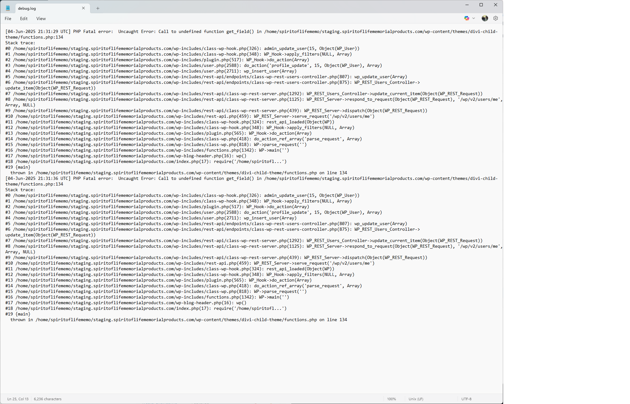

Alrighty. I've got the debugging and logging turned on. I navigated around the back end of the site a little and then back to the Translations page, and it hung up. I've downloaded the debug file and took a screenshot of it, which I've attached.
I hope that this will be helpful for you. 😀

Thank you for sharing the log. From the information provided, it appears that the fatal error is originating from your child theme, specifically on line 134 in your functions.php file. Could you please try temporarily activating your parent theme to see if the page loads successfully?

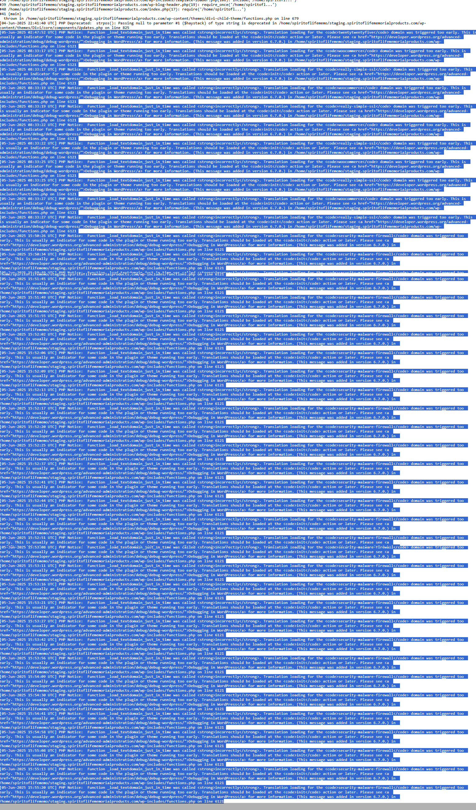

I've attached an image of the debug.log, with entries from today. Oh, I hope you find this helpful. 😀

I don't see any errors or warnings related to WPML.
