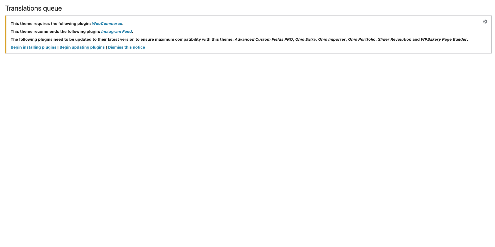

I'm trying to review my translations on backoffice but when I go to 'Translations' the page goes blank. The site I need help with is hidden link.
The 'Translations' page goes blank when accessed.
Can you help with the 'Translations' page going blank?

Could you please share FTP access here? I would like to escalate this further and also, while checking the debug info, I see that the WordPress Memory Limit is below the requirements. The minimum requirements are 128M, but we do recommend 256M and the debug information of your site shows it set to 40M. Please check this link for more details
https://wpml.org/home/minimum-requirements/.
You can increase it by adding the following code in your wp-config.php file, right before the /* That’s all, stop editing! Happy publishing. */ line:
define( 'WP_MAX_MEMORY_LIMIT', '256M' );
define( 'WP_MEMORY_LIMIT', '128M' );
After adding the code you can confirm that the memory was changed correctly from WPML > Support > WordPress > Memory limit.
